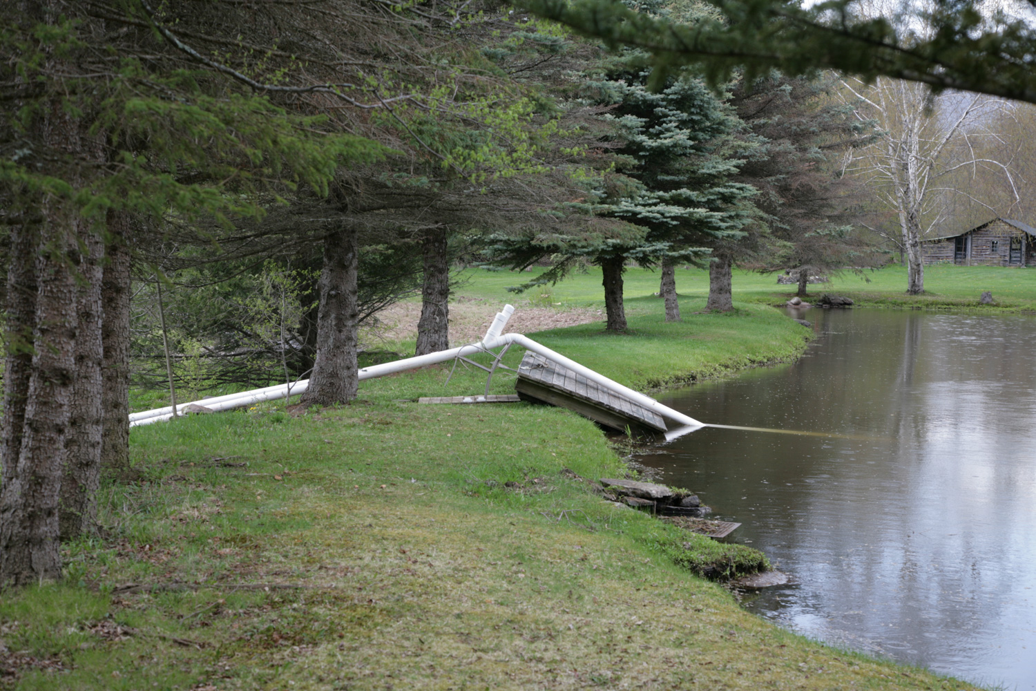

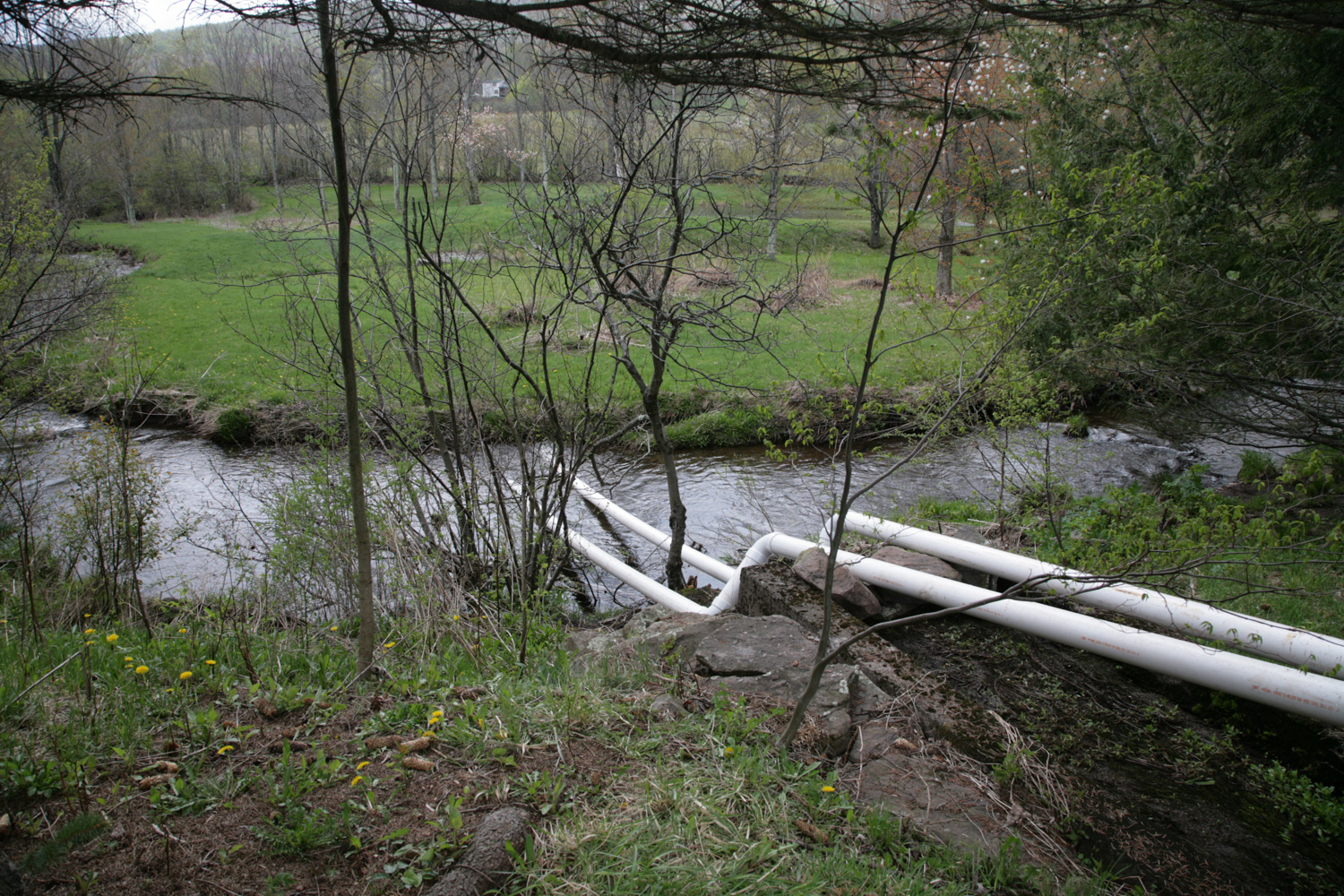

We did this using pretty much the technique described here by others. Cap the lower end, fill the pipe with water at the highest point shown in the attached images, then remove the cap. With the two 4 inch pipes it was pretty impressive how fast the pond drained.
[EDIT: WOW-- didn't notice how OLD this thread was!]
