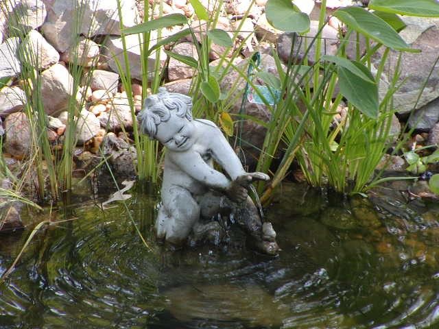

Here's a closeup of the statue in our pond.

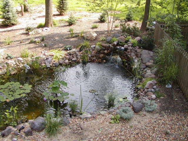

Another picture showing the current state of new plantings-- bought another water lily yesterday as we're trying to get a bit more surface coverage to help control algae. Water right now is so clear it's scary, two weeks ago had a bit of pea soup type algae. Can't say we did anything but we did add a lot of anachris early in the year that is starting to take off and grow so that will use up the nutrients otherwise used to feed algae?

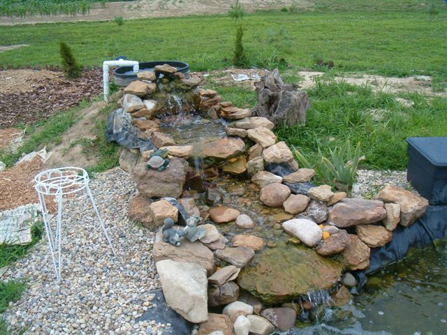

Here is the redesigned water fall now that we actually have some water flowing. Now that we have all of the "leaks" fixed we can start trimming the liner and the "Great Stuff" foam that we used to seal between some of the rocks so that it looks more natural. Where the pond is in the direct sun we've got a little bit of an algae problem that we are attacking on several fronts including chemicals, plants, and barley straw pellets. We were trying to avoid a UV stabalizer because of costs, but will probably give up and buy one for it next year. We're getting a little tired of spending money on it this year. Has ended up quite a bit more expensive then we had planned - of course, don't they always? /forums/images/graemlins/grin.gif
