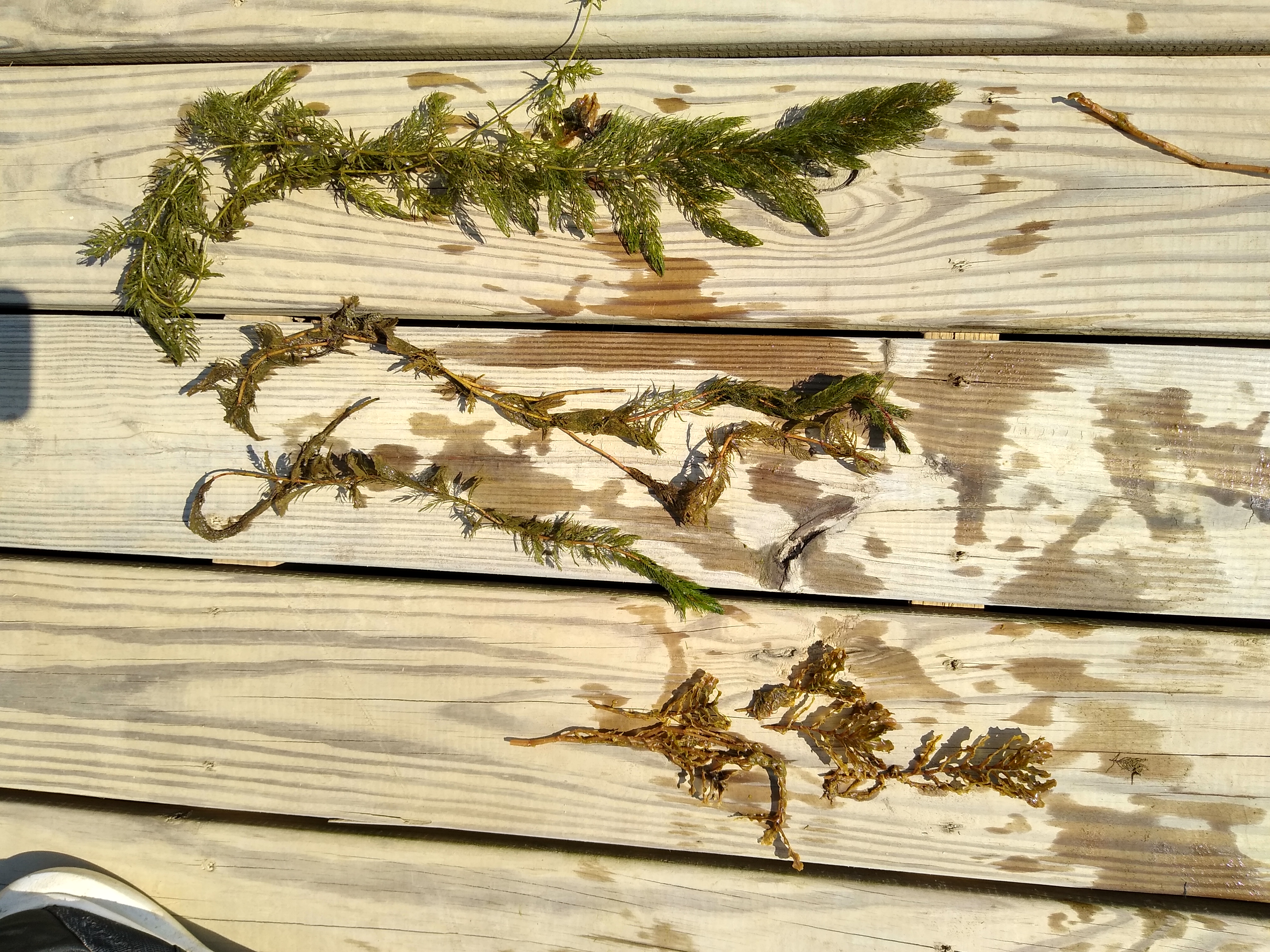

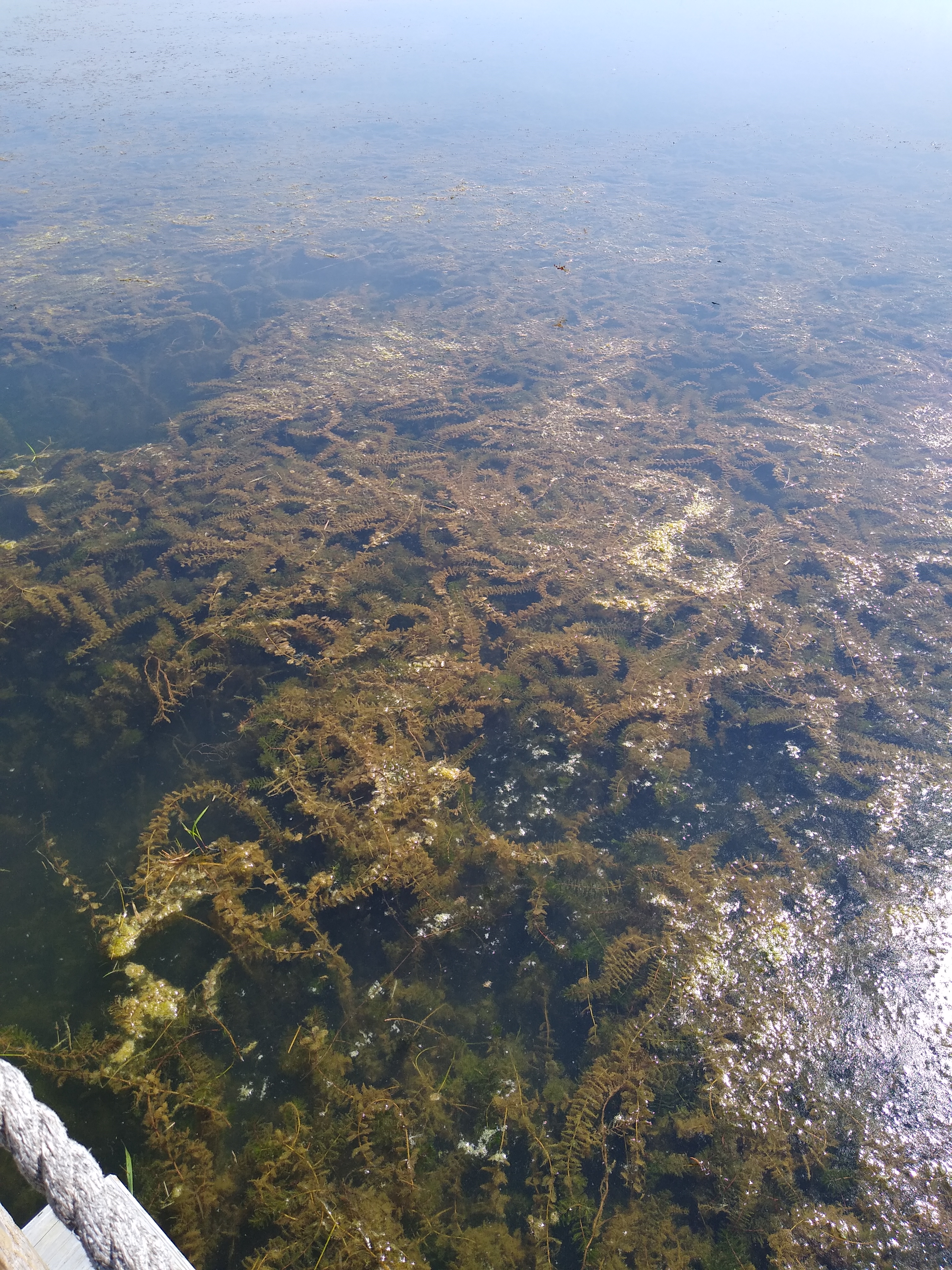

Just wondering what everyone is using to AFFORDABLY control weeds in your pond
My pond is ~0.8 acres and ~5' average depth. About 1.35 million gallons....or about 4 acre/ft of water.
Most of the stuff is stupid expensive. Like anything with the active ingredient Fluridone....(trade name sonar). I would need about a quart of the stuff.....at $500:eek:
Endothall (aquatholl trade name) is another. Granular or liquid form would be $1000 at the dosage levels I need.
Diquat Dibromide (37%) I would need ~2 gallons of....and at $200 is more reasonable.
Triclopyr as labeled for aquatic uses the strongest I can find is 44%. Would take 6 gallons at ~$100/gallon. But labeled for general AG usage ir can be had in 61%, which would only require 4 gallons.....and about $250.
There is also 24d granuals but would require ALOT to treat the area. Like $1000 worth yet again.
The different versions of copper complexes and copper sulfate seem the cheapest, but an reading mixed reviews on how effective they are on weeds, as their primary target is algae, which I have very little of.
Pond has little to no outflow, and is not used for irrigation or human swimming. However the dogs swim and drink. So I want an affordable solution to my problem that is gonna be safe for the dogs.
The three weeds as best I can identify are coontail (about 60% of the weeds), Milfoil (20%) and curly-leaf pond weed (20%).

I called Jones fish. Diquat dibromide is what they recommend. Which is syngenta reward trade name. So I ordered some.
Triclopyr is hard on the fish they said.
They said of the three weeds I have, the curly leaf pond weed is all they like. So explains why carp aren't working.
Don't want a fountain or aerator. Just more maintenance, and I like the pond to freeze over solid in the winter so we can get on it. Rather than have a hole, or thin spot left from an aerator.
Due to power consumption, and logistics of putting in a fountain or aerator, the ONLY thing I would even remotely consider is a windmill aerator, and would disable it in the winter. But those are $$$$.
If I can get by with $150 worth of low-maintenance chemical each year, that's money well spent if it works.
