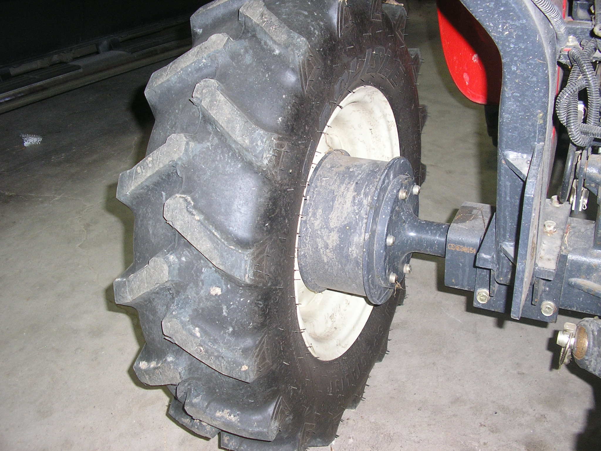

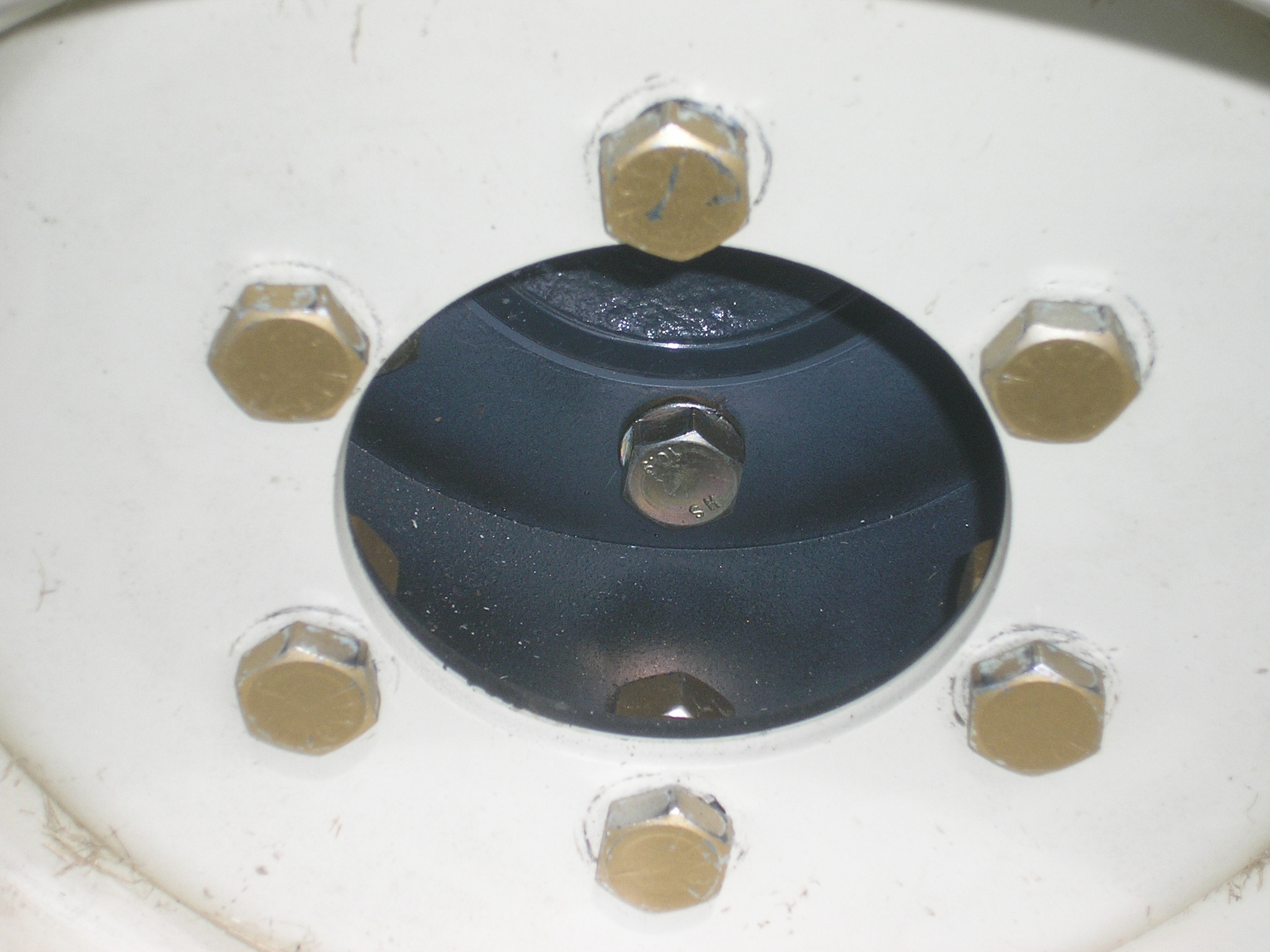

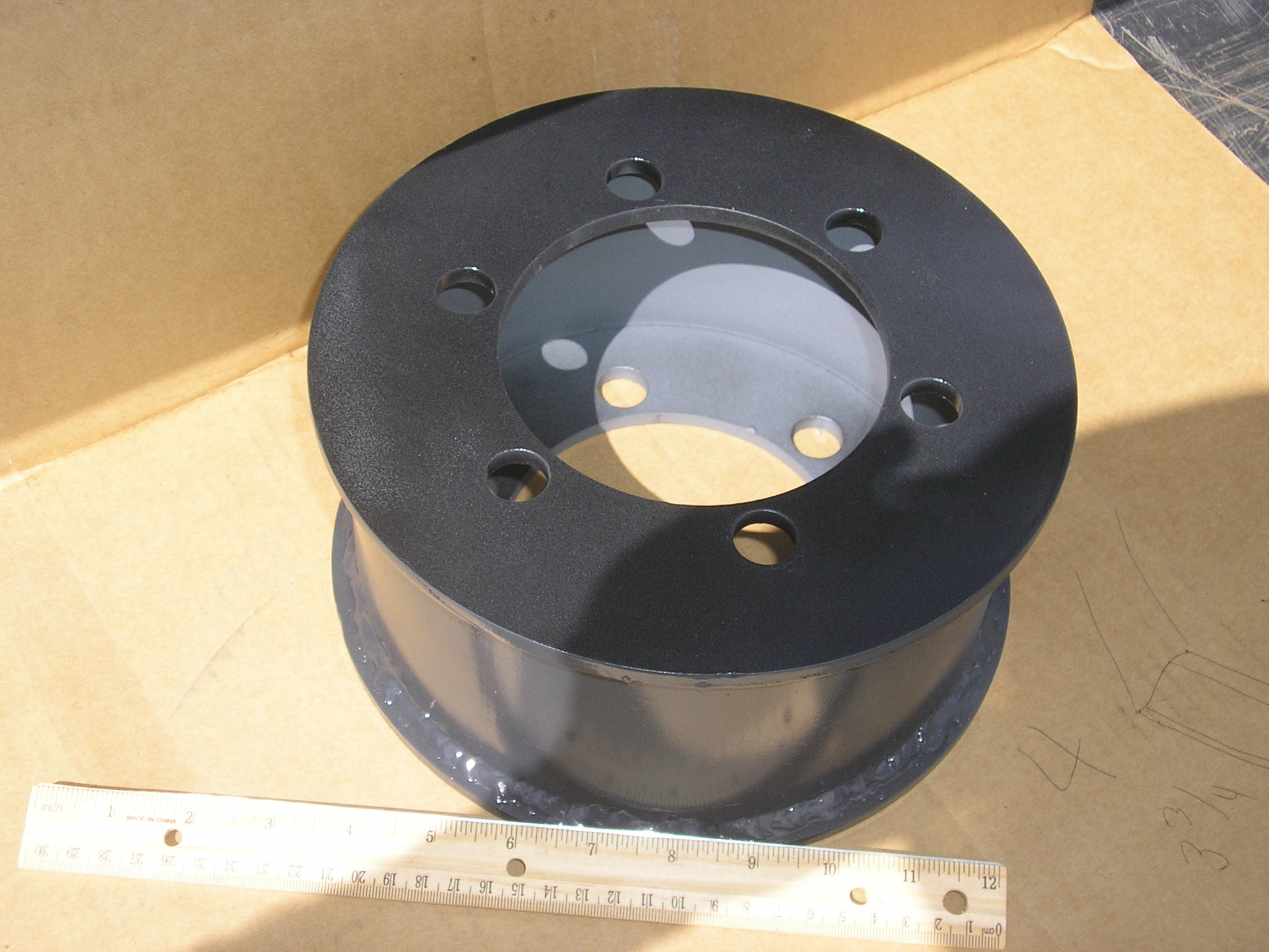

How much more stable do the spacers make it feel?
Don't know about his but mine well worth the time....シ" steel plate, lug diagram off to machine shop to cut plate....4" wide piece of 8" steel pipe x 2....4" because that would still have my rear tires within a 60" spacing on my 2400 Branson. A little non professional, self taught welding and painting and 12 bolts, locks, nuts.
