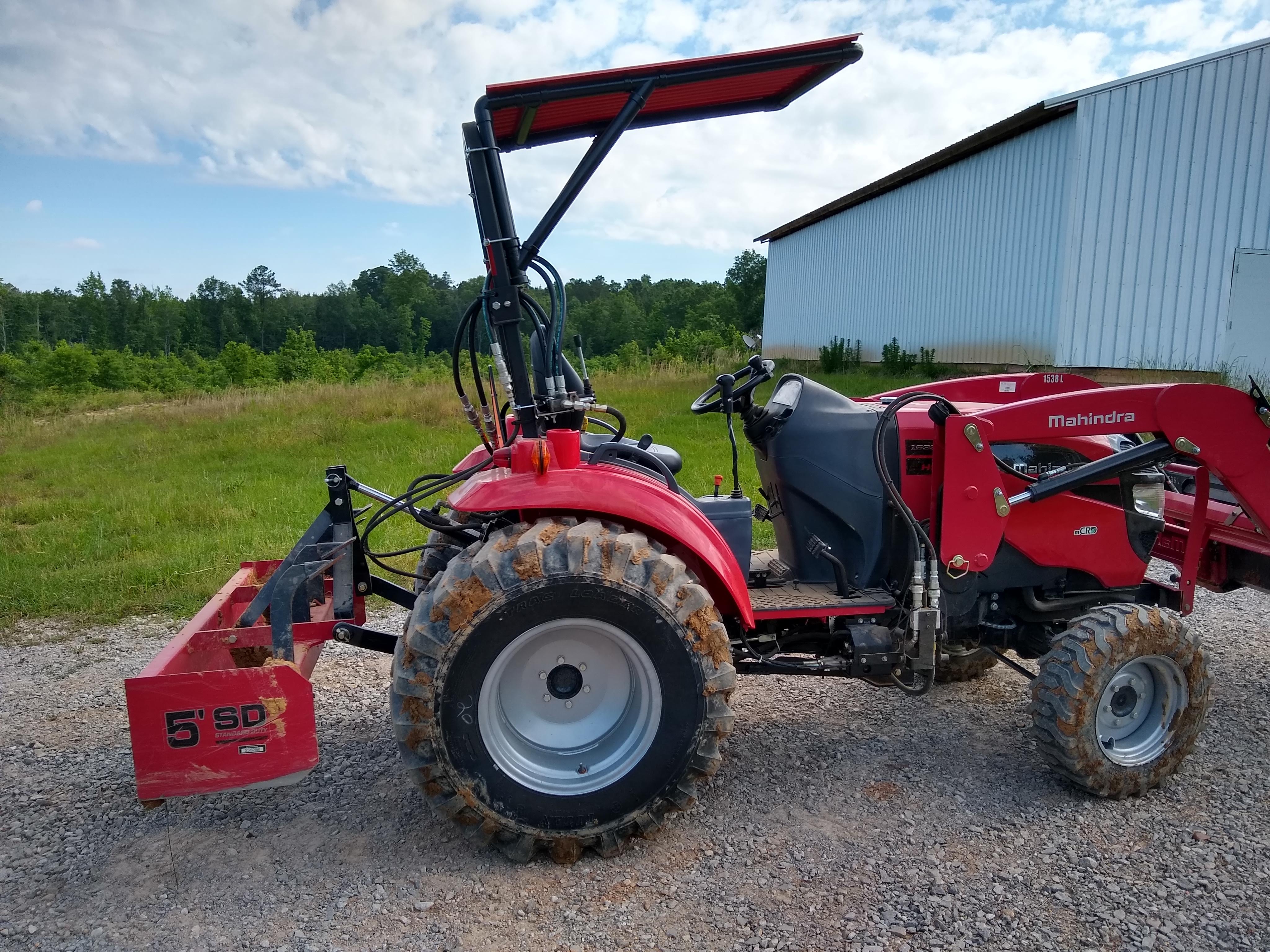

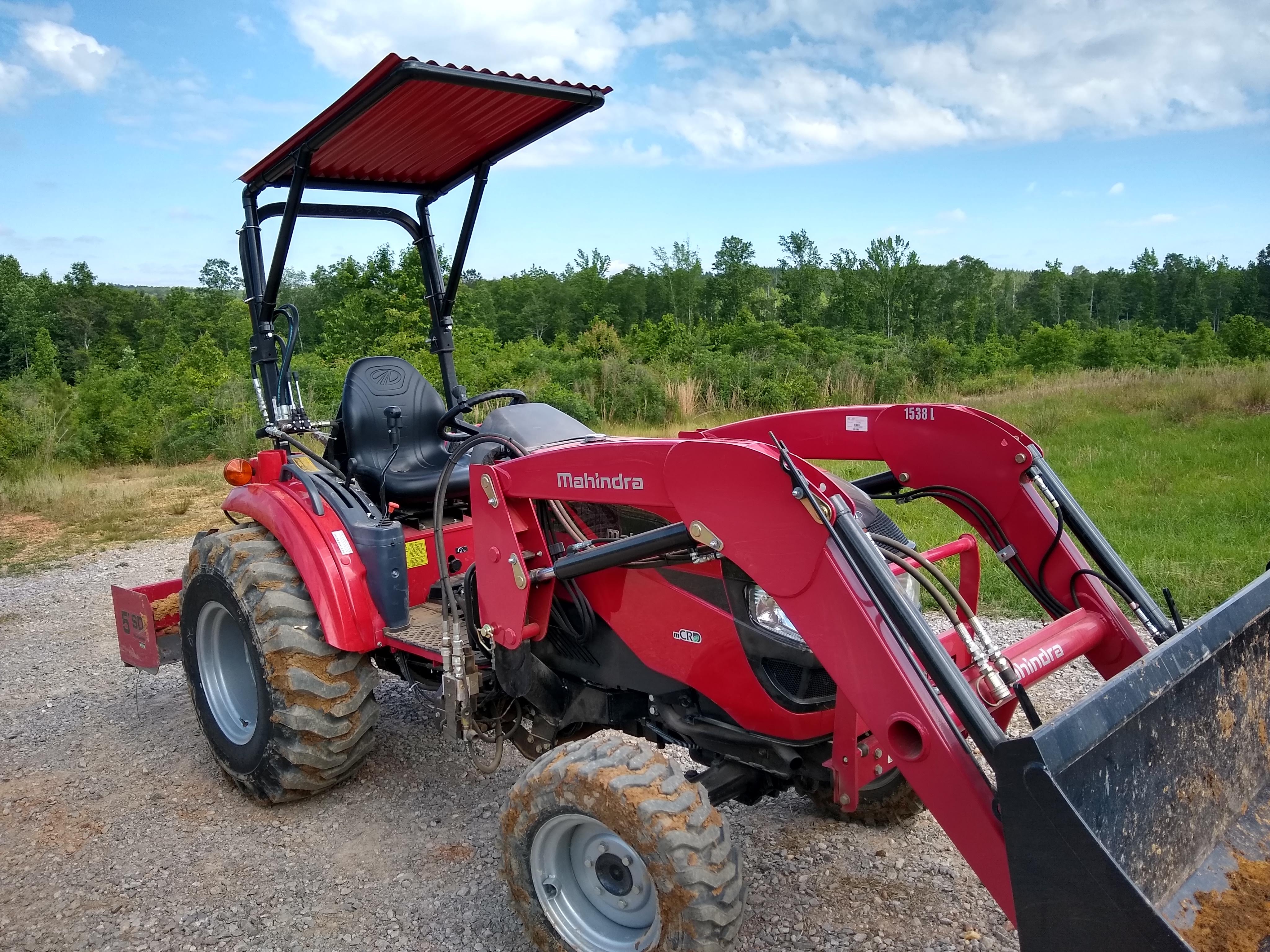

Its Awfully hot in Alabama this time of year so I decided I was going to buy a tractor canopy.
I don't consider myself cheap by any means but I just couldn't justify spending three or more hundred dollars on a decent canopy.
I figured I could come up with something myself but with no welding skills or equipment I knew my options were limited.
Wood would likely work but didn't seem like a good choice and cutting and bolting metal together seemed expensive and tedious.
PVC maybe? I couldn't really find anything online that made me feel good about it but it's relatively inexpensive and easy to work with.
So I gave it a shot. I used 1 1/2" pipe and plastic roofing panels for the cover. It is bolted to to the ROPS using U bolts so I didn't have to compromise the roll bar integrity by drilling.
Overall I am very pleased. It is light weight, holds up well to the vibrations and certainly serves its purpose.
All together for pipe, plastic panel and paint it cost about $60 to complete.

Nice! If it holds up to the continued vibration, I'd say you got more than your monies worth!

Our bigger tractor's canopy has a 1" thick insulation on the underside that keeps the top's heat from radiating through. It works so much better than a canvas yellow umbrella. The smaller tractor only has the umbrella.

My canopy was tilted slightly to the front so it would not catch wind when being trailered. I don't know if that would be a problem for you but at least if it rains your water won't drip on the steering wheel. The only time my tractor was ever trailered was on delivery. Your angle looks very slight, I think you will be OK.

That's a good point about the wind catching when its on a trailer.
I can easily take it off by removing the U bolts. But I may not have thought of that without your suggestion.
That's a lesson I'm glad I don't have to learn the hard way.

I just did a similar for my Ford 1925. Called around to golf cart shps and got a used top for $20. Went to a metal recycler and bought $8 worth of tubing (old storage rack) Using U bolts attacked to the ROPS. Works great probably have a total of $60 in it, U bolts cost the most.

Nice design and build! Is that PVC drain pipe?

As to wind when hauling have heard some sad stories, don't like to haul my cab tractor facing forward either but do lock the doors on it. If you must haul your tractor facing forward you could run ratchet straps over it. Aluminum makes a very good roof panel and it bare helps reflect heat. May have problem getting one but road signs are strong and they do have old ones that are replaced. Once in while my son in law who works for county road dept can get one. On any canopy watch for sharp edge and your head. Course same is need for lights on them also...know that too well.

Brilliant design. I live in North Alabama and about to pick up my RK24 and the rops is too tall for my garage so I will likely need to find a way to make the canopy lower and this may work.
