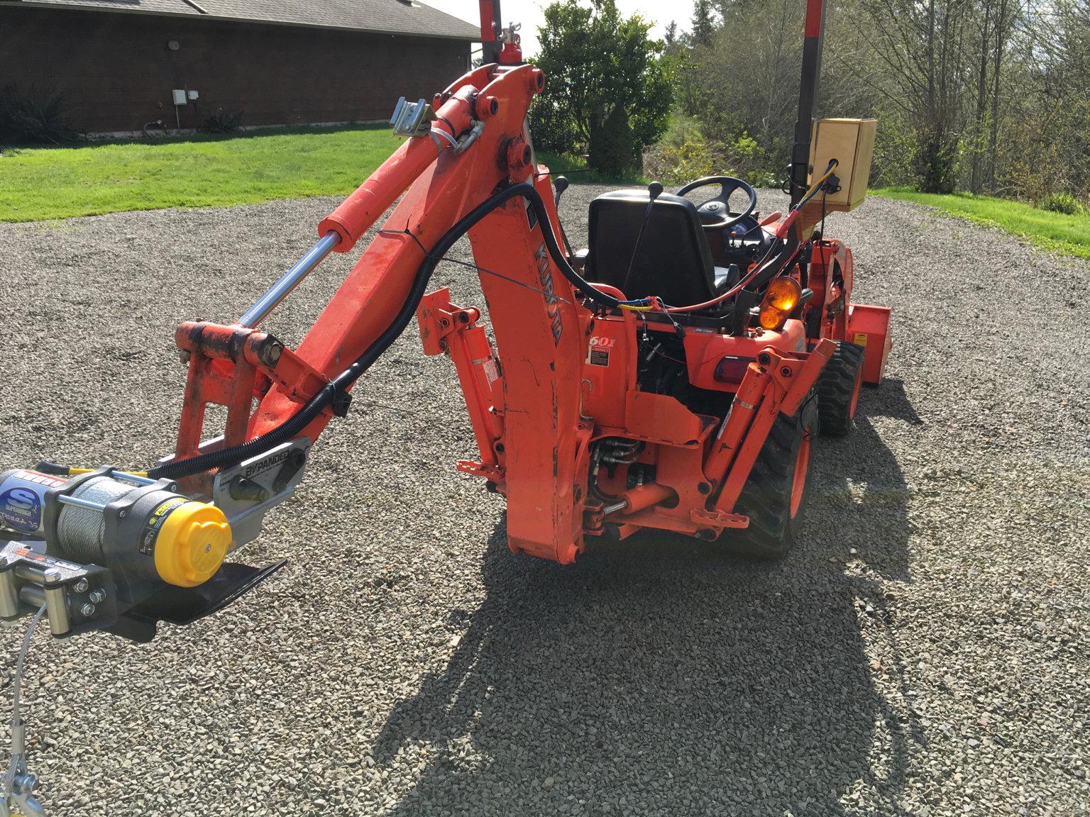

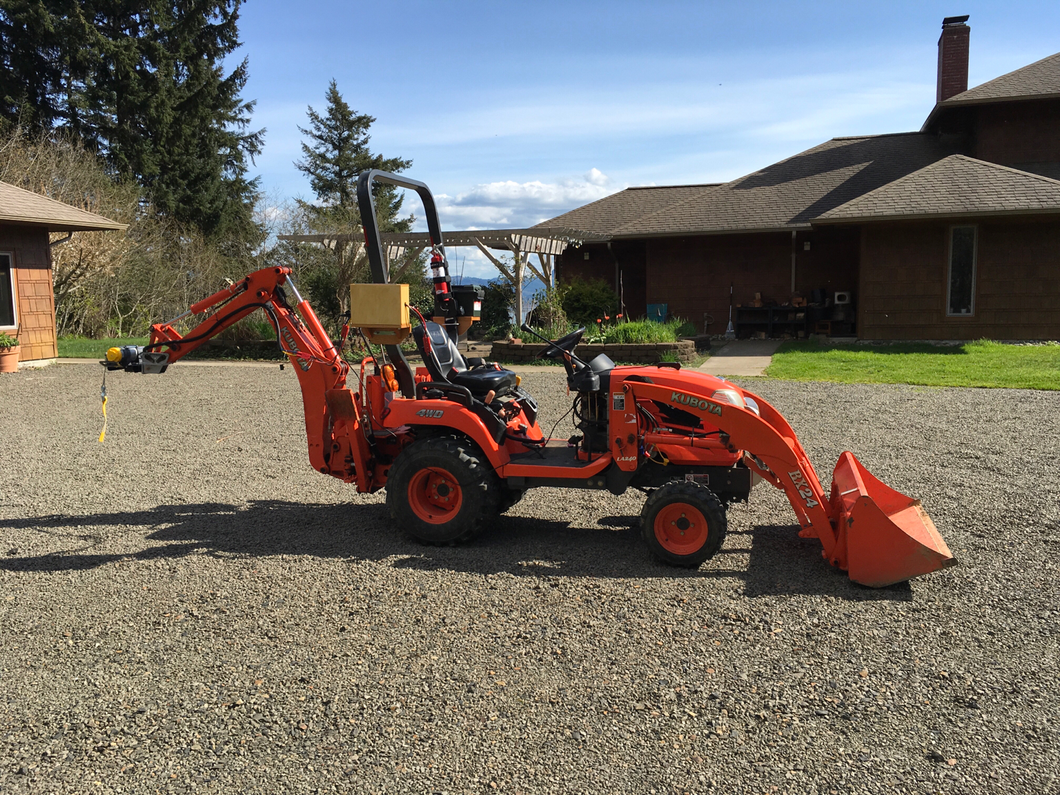

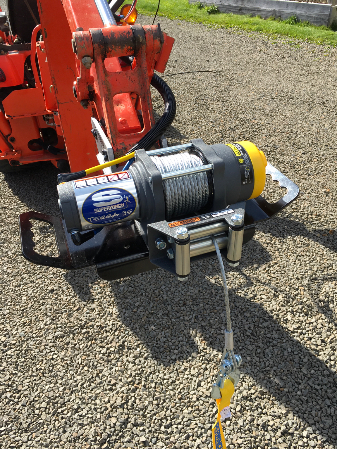

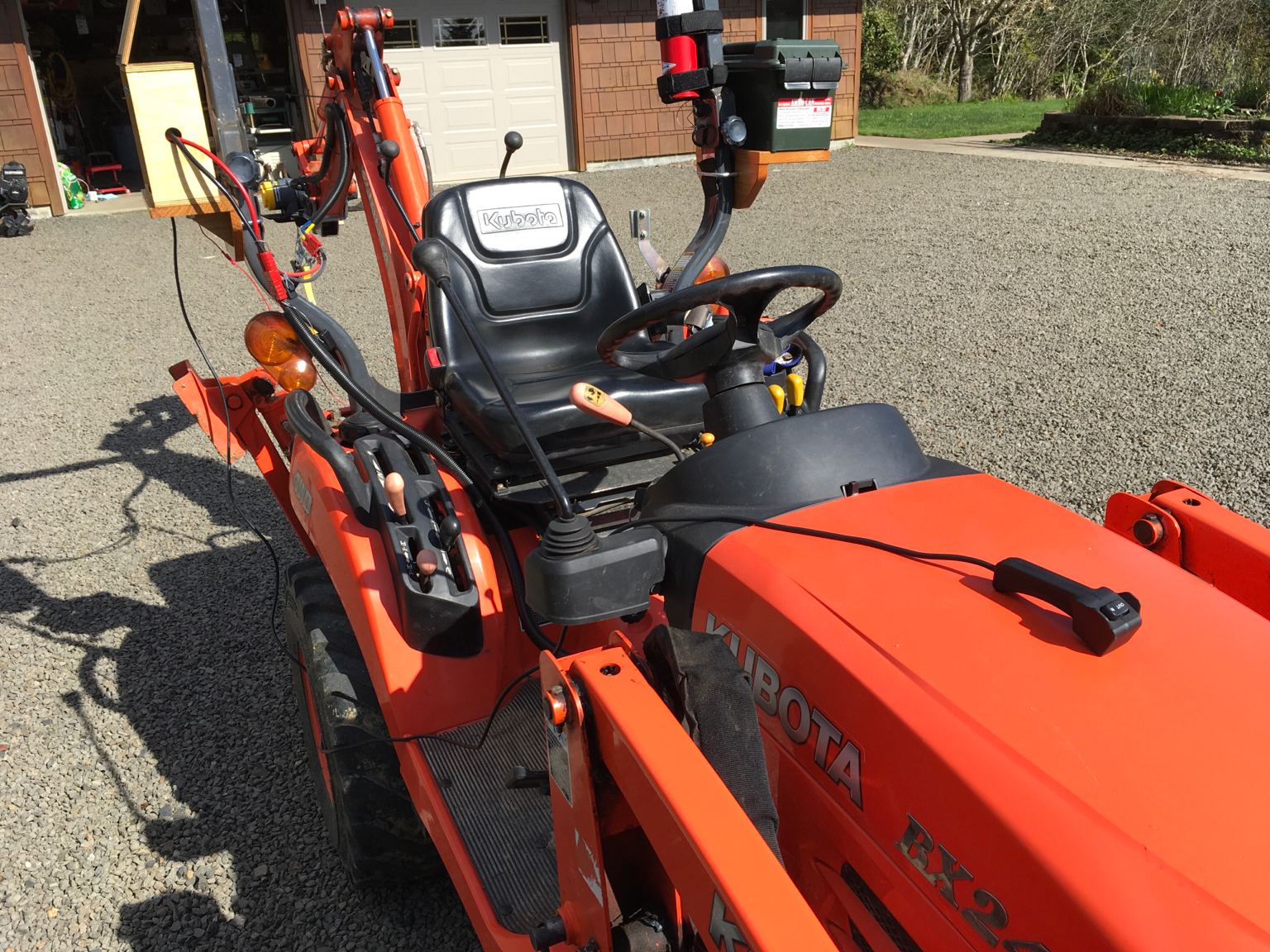

I installed a Superwinch 3500 in place of the backhoe bucket on my BX24. I need to tidy up the wiring but the winch works great. I set it up so everything except the battery wires and circuit breaker in the under the dash area come off the tractor when the winch is not in use. I just use the remote to control the winch. I didn't use the ATV handlebar switch that comes with the winch for obvious reasons.

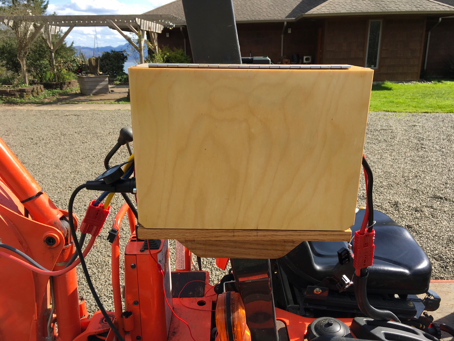

I built a wooden box for the solenoid and connections which mounts to the ROP. This comes off with 2 bolts. I will use the winch during the time of year I cut firewood. After that the bucket goes back. I used more connectors than I needed but I want the system to break down to small parts for storage.
Our property is very steep and I need to get trees up to the road to process them for firewood. Decades ago I just cut trees into pieces and humped them up to the road. I have been backing the tractor up and pulling logs with hooks on the FEL bucket. This got too exciting when I would raise the bucket up to get a better angle.
Winch $179
Adapter for 2" receiver $75
Bxpanded 2" receiver replacing bucket $129
6 ga wire and miscellaneous connectors and crimper $45
I would rather have a Wallenstein FX35, but these cost $3000+.
