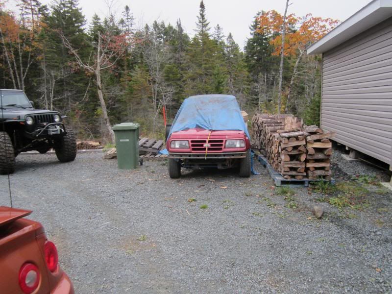

Went to bolt on some manual hubs so I'd finally have 4x4, only to discover the hub flanges are way thinner...and the bolts bottom out
That'll have to wait until monday... so I moved on to the rockers. Jacked her up and hogged out the front wheelwell about an inch to allow for bigger sneakers and get rid of some rust.
Measured and cut the 2x3s, then capped them
After lots of drilling and grinding
Still have to fix this corner and weld the fender

Got some welding gas and got back at it. Replaced the rotted section of A pillar, and welded the fender to the 2x3
Seam sealer
Painted black until I can decide what color it's gonna be
Side #1 done! We have a little saying around here; "She's pretty from affar, but far from being pretty!" Pretty much sums this up. I do try to do a good job as it's good practice, but it's nice knowing it's just a beater and doesn't need to be perfect.

Turned the old girl around to give the other side the same treatment... but the driver's side is worse.
Why the heck would they run wires through the sills!?!
Just to see how much I gain over stock repacements
Still couldn't decide so got one of each
Forgot to take the pic before turning it around... but yeah, I'm leaning towards the drab olive. It covers way better!
The neon was noting but stripes... so I replaced the tip with a Duplicolor tip that sprays in a fan pattern rather then a spot. Worked way better. I may give that fender a 2nd coat before deciding....
