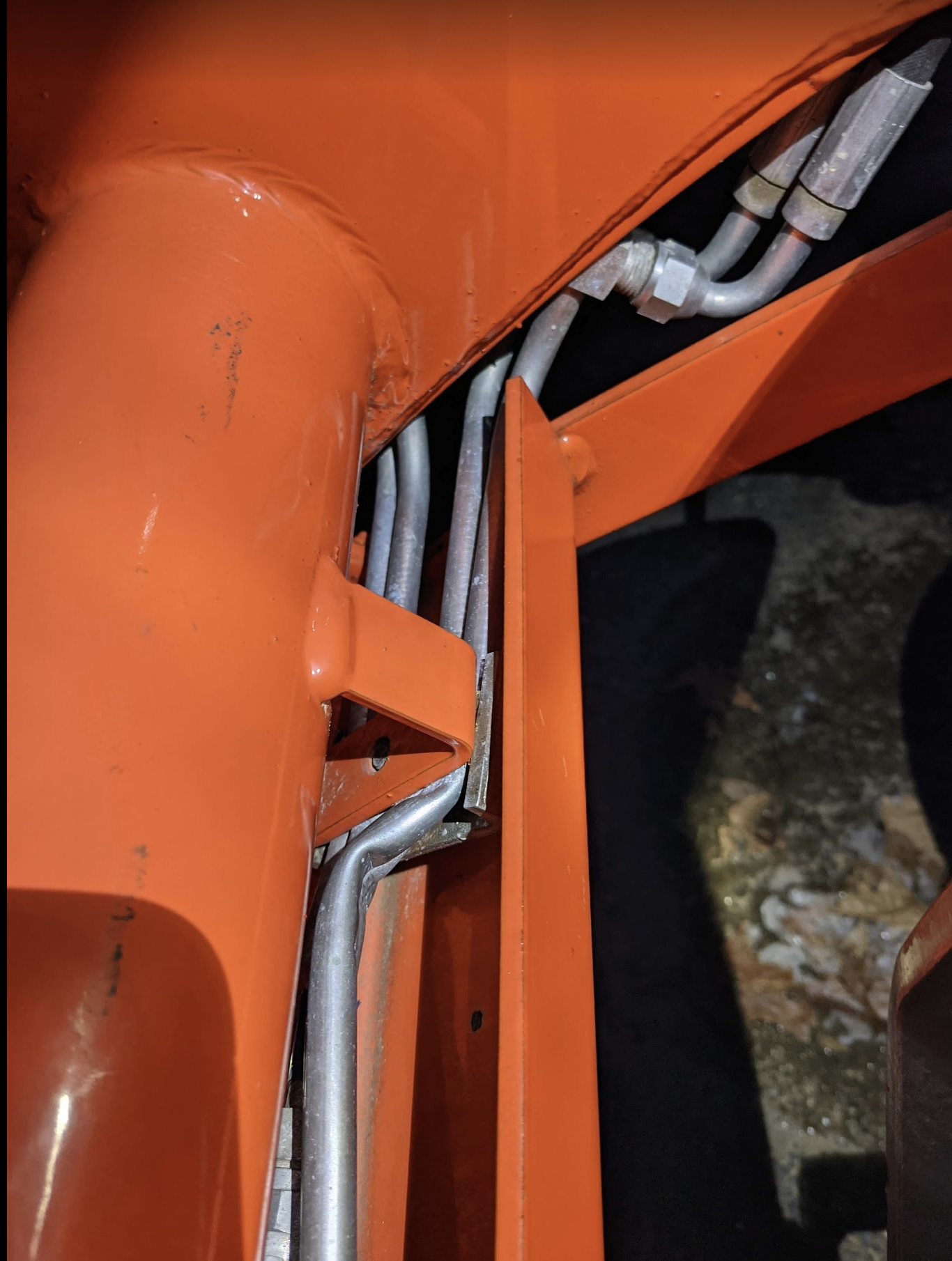

Poorly fixed DIY hydraulic line or normal?
   / Poorly fixed DIY hydraulic line or normal? #21
I'd rec9mend you don't Google for pictures of hydraulic injection injuries or hydraulic injection that usually results in gangrene unless you have a strong stomach. A 2,500psi hydraulic stream has more in common with a razor blade than a leaky garden hose. Nothing you want to be around.
Replacing hydraulic hoses isn't hard. You just need to support whatever the hydraulics were previously supporting & respect things. A pinch will slow down & restrict fluid. How much depends on the pinch. More importantly circles are really strong, but a Cresent shape isn't. The pinched part will be much more likely to fail. Id repace a damaged section rather than risking it leaking or blowing out later if it were my machine.
My thoughts as well. Fix it right!

Keep in mind that Murphy's law also applies to tractors. If that line fails, it will do so at the most inopportune time. You don't want to be in the middle of a project and then have to work on the tractor. And you may have to do it in the field because your bucket is down and you will pump out all your fluid trying to get back to the barn.

Looks like someone already tried but did not have the bender.

If I order parts/tube from my dealer I assumed they came preformed. Am I mistaken? I would have certainly been surprised at the parts counter if everything came straight! :eek: No repair that day for sure!
I certainly don't have a tube bender, and as you stated and I thought, it looks like someone went gorilla with pliers.
Before going about this, I need to inspect the whole loader and see how much needs replacing. IIRC this deformity occurs on both the left and right side of the loader, not just this one spot. When I depressurize the system I want to get it all done before powering her back up.

Yes, the dealer should have exact replacement. I make tubes for other crazy things so my stock is straight on the shelf and fittings in the bins, I put the bends and ends on.

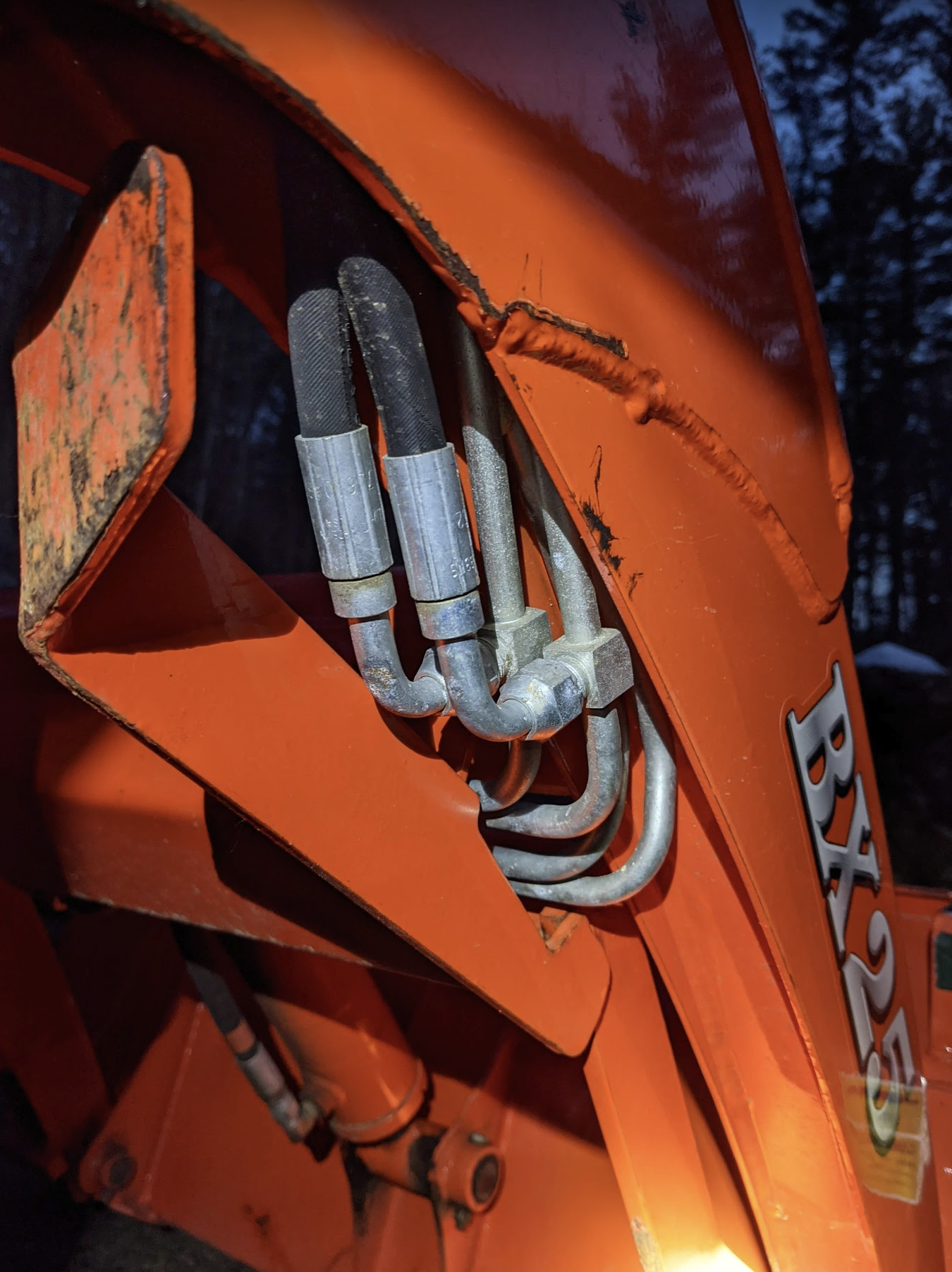

Now that I have a trailer, chains, etc, I've moved the tractor to my house. I took some better photos of the affected area. To me it looks like these tubes actuate the boom up/down. The other lower pair of tubes connects to hoses and goes to/from the curl cylinder. Also, these smashed tubes I was asking about do appear on both sides of the loader with the same 'bad bend'. Any other BX25 or so vintage owners tubes look like these on your loaders? This all looks the same 'age' as other hydraulics on the tractor, unless this 'repair' was done some time ago.
The tubes with the poor bend are attached to 'cubes' under the boom arm. Hoses attach to the same block via the nicely bent 90コ coupling. Are these blocks serviceable? Meaning I can replace just the 3ft or so of tube going across the loader into these blocks? Or do I need to replace everything up to a serviceable fitting?

The tube is one piece with the blocks ...
