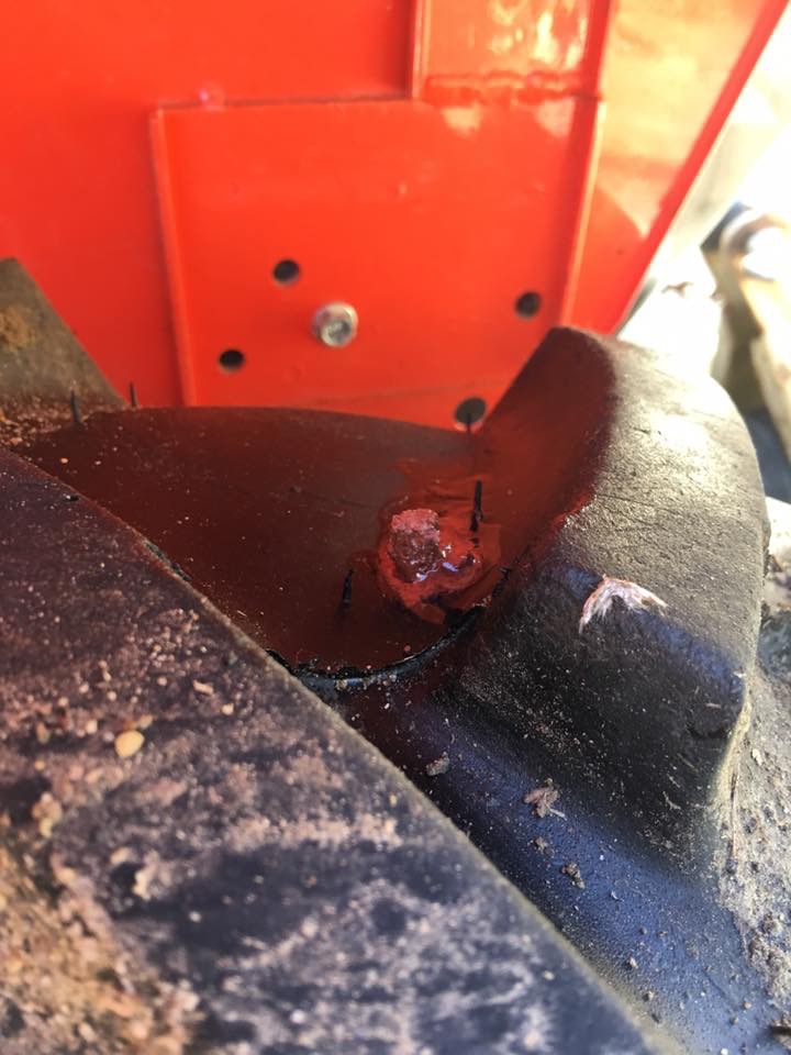

I didn't not loose much ballast at all. I was only a few yards from my trailer where it happened so the loss was minimal. I was able to get the tractor loaded up and home at least without the tire going completely flat. Pretty lucky I suppose. I picked up a tire plug kit to try tomorrow. I figure at worst case, if the plug kit doesn't seal it up and hold air, the plug kit should at least hold the rim guard in until I can get the tire to a shop to have it properly repaired. It's been raining all day so I really didn't want to try Messing with it until it's dry. Luckily I was able to get the tire rotated so the puncture was at the top. Didn't break the bead or anything, just lost the air and it sprayed a bit of rim guard for a bit but not much.

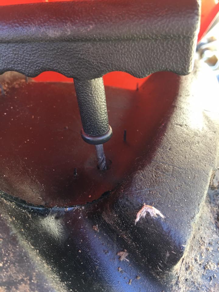

Well I found the hole, wasn't as bad as I though. Took three plugs to fill it but at least it's holding fuid and air pressure for now. Letting it cure over night before I start back in on my ditching project tomorrow. Gonna see how the plug holds up for now but I have a feeling I'll be taking the tire over to the dealer to have an internal patch put in just for peace of mind.

I've been putting the tractor through its paces the last two days digging fill and gravel along the side of my road and so far the plugs have been holding up great.
