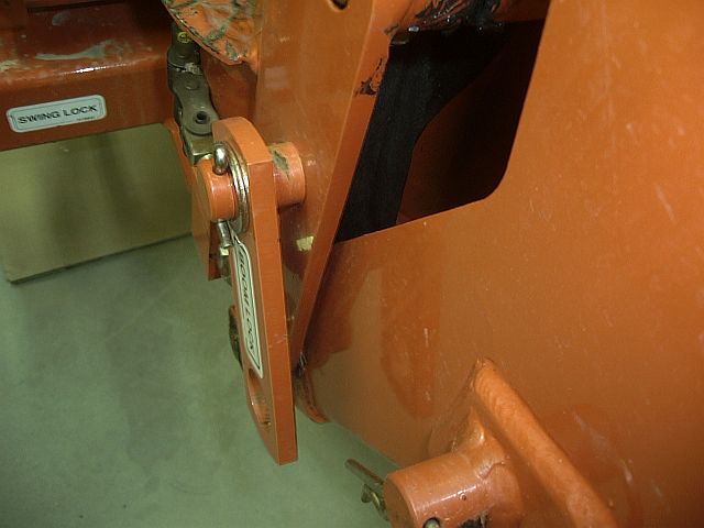

Henro, here is a picture of the end of a Kubota B4672A boom lock pin. Look familiar? The manual for my 'hoe covers both the B4672A and the BL4690B, looks like the same outfit makes both units. I'd say Kubota's subcontractor has a marginal approach to fastening this pin.
Looks like I need a pin welded too. Thanks for the heads up.

   / Popped my BL4690 Backhoe Boom Lock Pin #12
Dave
That looks just like mine. When I checked, there is a weld on inside of frame.
#14
Dave,
Thanks for posting that picture. I would guess that is what mine looked like before it popped out. I never really paid attention to it...
Ron's is apparently welded in from the back side. If that had been the case with mine, I doubt it would have popped out. Mine had an indention in the back, that looked like it was deformed somehow, and that the deformation was what was keeping it in place.
There certainly was no welding on it, as can be seen in the photo showing the hole after the pin came our. Only rust, not a broken weld to be found anywhere.
From what I can see the repair I made is holding up well. Probably much better than what I got originally.
I'm not complaining though...the backhoe has become a close friend of mine over the last two years...we all have our shortcomings... /forums/images/graemlins/smile.gif
   / Popped my BL4690 Backhoe Boom Lock Pin #15
It was hard to check that last night at near midnight. Good thing the tractor is inside now. I couldn't see the inside very well. The access was blocked on other side of backhoe with boxes I didn't feel like moving. Still moving into the new shop.
Anyway I did feel the inside and it didn't feel like it was welded to me.
   / Popped my BL4690 Backhoe Boom Lock Pin #16
Be careful not to forget that latch again. My pin is also pressed in (no weld) and I have also forgot to unlatch my boom and wondered why didnt they weld this thing like they did everything else. My conclusion was that its a built in weak point. That pin will pull out before damaging anything else. The next time you forget it, you may bend something that wont be as easy to fix. Im probably wrong but its just a thought.

Henro as an ASME certidied welding inspector I think you did a pretty good job. Good penetration, no excesive concavity or convexity, and nice transition between passes. Should last the life of the Kubota.
