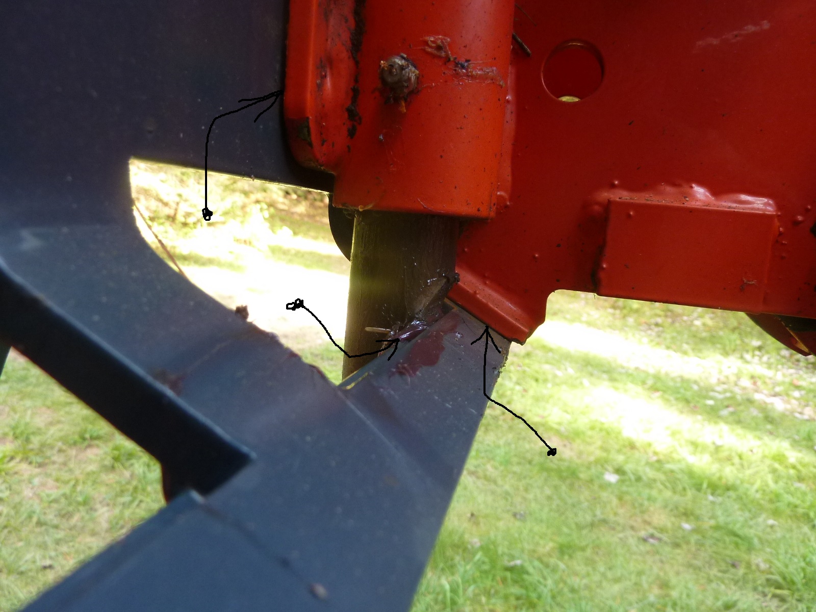

Lately, when I dig into a pile of something heavy, or a dirt slope laced with roots, with the loader bucket, I sometimes hear a metallic pop when curling the bucket up. It's almost as if a rock rolled back to hit the back of the bucket, but I don't have rocks in the bucket. Any ideas? Something to worry about? My tractor is a Kubota BX25D with over 1300 hours.

Also if you have an SSQA bucket check that the pins are in proper contact and that there are no gaps between the SSQA and bucket mounting faces especially on the bottom 45* angled piece. A gap there could allow you bucket to lift under pressure with a bang and eventually may come detached.
Check where the arrows point

Thank you, gentlemen. It's a pin-on bucket. I am reminded that about a year ago, the pin on the right side sheared off, and half of it disappeared somewhere. I will check all the pins and bolts when I get back to the tractor this weekend. I have been pretty religious about greasing. I also was wondering whether it might be something in one of the cylinders. I will report back!
