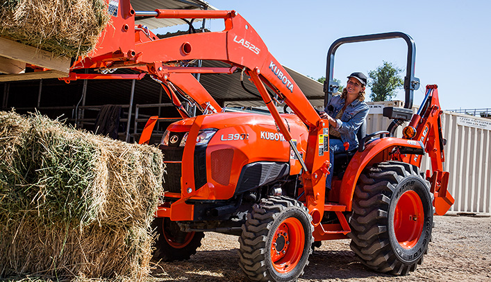

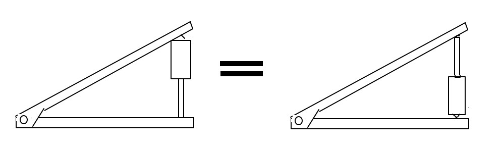

People still confusing cylinder orientation with difference in extend and retract.
Look at these loader cylinders.
If the cylinders are turned around so the rod end is up, it will not lift more or less than before. It extends (strong motion) to lift whether the rod is up or down.
The mythconception is that the orientation makes a difference in power.
Bruce
Look at this loader cylinder.
If the cylinder is turned around so the rod end is up, it will not lift more or less than before. It extends (strong motion) to lift whether the rod is up or down.
Bruce
Again, in a push-only operation, orientation of the cylinder makes no difference. However, in a push-pull operation, the cylinder is stronger in one direction than it is in the other direction.
   / Popular mythconceptions #29
In a push-pull use of a cylinder one direction is stronger, but it will make no difference if the cylinder is turned around. Orientation still doesn't matter.
Bruce
