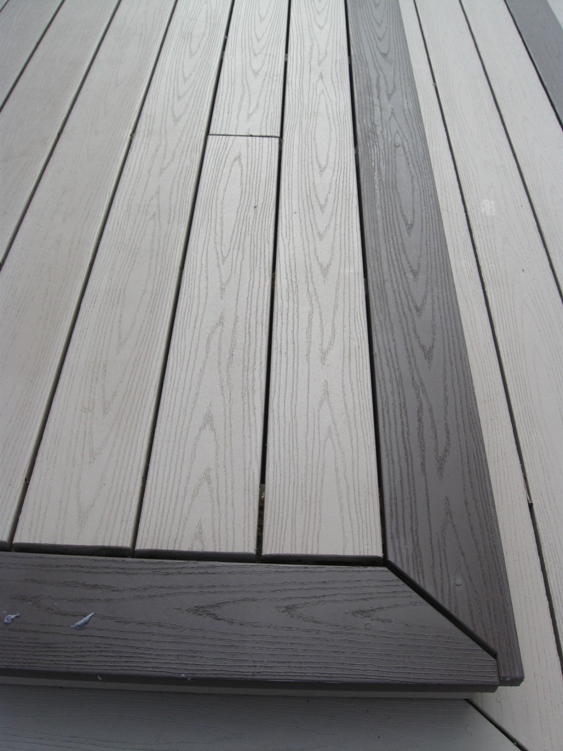

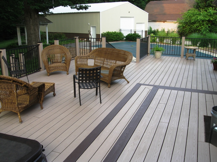

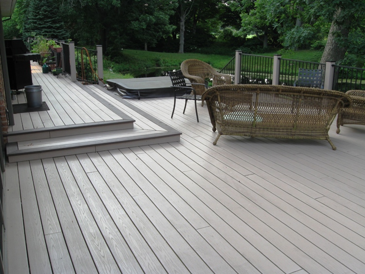

Here are a few pictures of my deck with Azek composite. This is about 4 years old and the only maintenance to date has been power washing a couple of times a year. As long as you don't mind a painted wood look and can handle the initial investment, it's a option worth considering.
