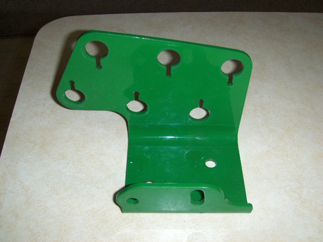

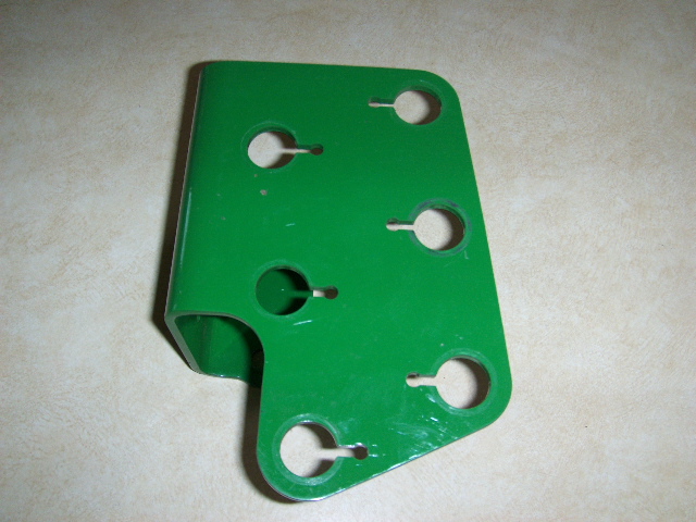

Have you considered remotely mounting the QCs?
Hoses from the valve to a Bracket containing the QCs, then hoses to your loader.
   / Port spacing dif-fug-alties
Your suggestions are well appreciated.
With less than 18 inches between valve location and the loader hard lines, remote mounting QDs would get quite busy.
This tractor is not large, bulk and complexity adds up so quickly.
