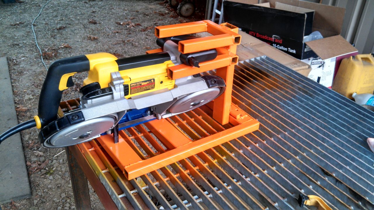

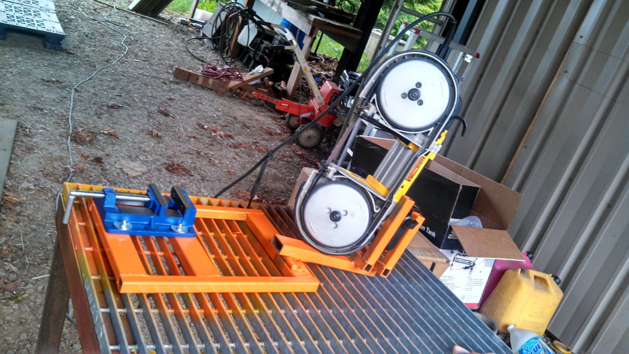

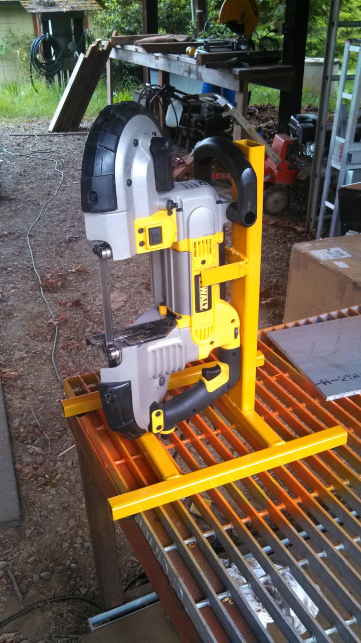

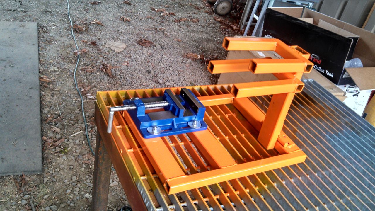

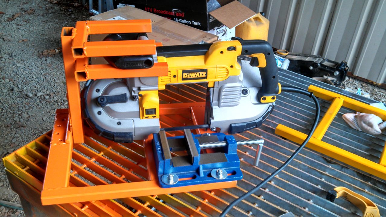

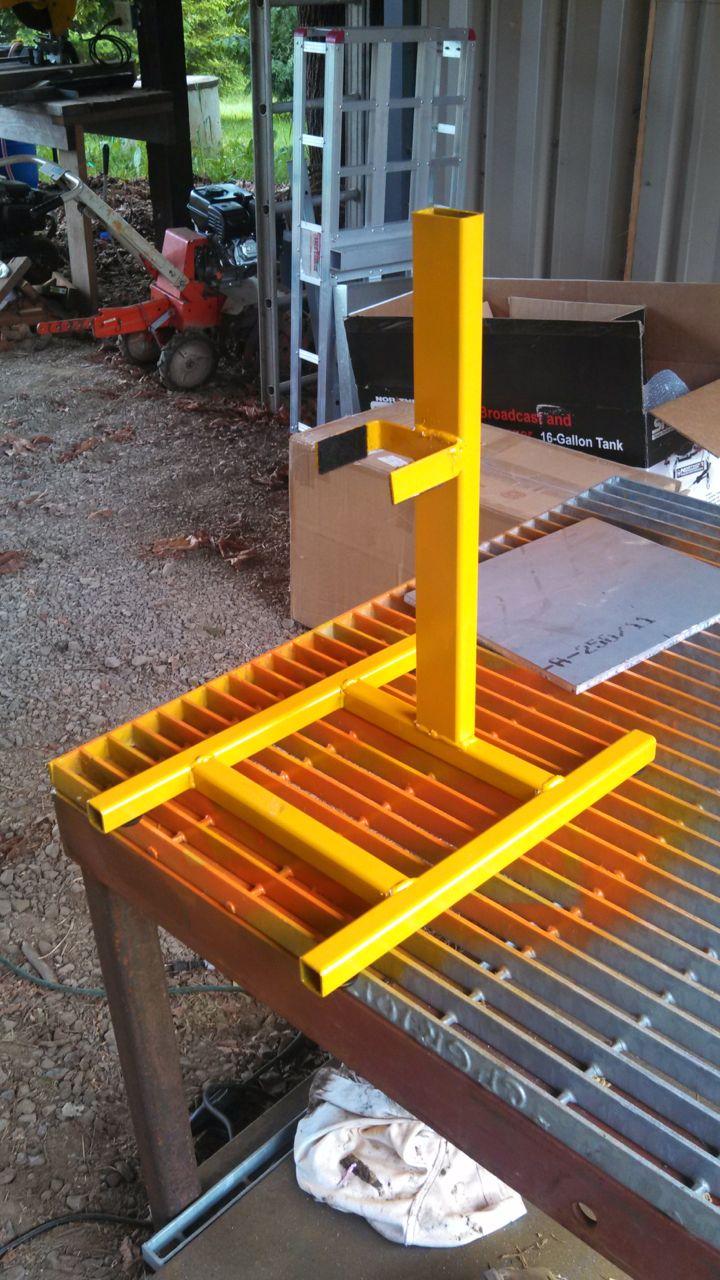

Too cool! I need to build one with a matching work support to sit on my concrete floor. I just need to figure out how to hold my saw. It doesn't seem to have any orthogonal edges.
There are some bolts in the handle that can be removed and after the top handle is out you can use bolts there to fasten. Also, look at how Swag attaches the portaband to their table. I like the simple capture device that Woodlandfarms built too. Cannot tell if he has it locked in place or just relies on his hand on the saw to hold it. Either would work.
