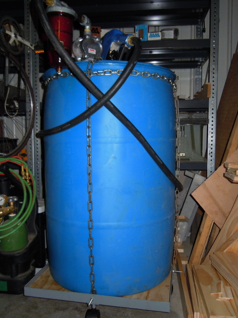

Here is a picture of my fuel barrel. The pump is 12V powered from trailer outlet mounted on the tractor. I also added a filter that is able to separate water but so far (in five years) no water was found in the fuel. There are chains attached to platform under the barrel that I can hook up to FEL and move it from the trailer I use to transport it.
