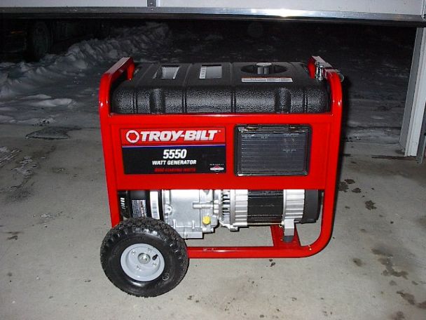

My owners manual says that regardless of the type of oil used, it needs to be changed at the specified intervals. Gerard

Thanks Dave246. I've heard a lot of good things about the Honda engines. Mine is a Briggs & Stratton 10HP OHV. Hope it serves me as well as yours has for you. Gerard
