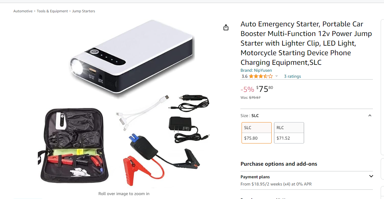

I have one of the compact ones in my pickup, I should check it to see if it's any good I suppose.
Some of these claim to be good down to some fairly low temps;
"works even in extreme climate -4~140℉. Even if the battery voltage is too low or dead, pressing the “BOOST” button will force the car to restart. "
I would take that with a grain of salt, I put a Lithium battery in my SxS. It works great in the summer time, but when it gets
cold it is almost worthless. I can turn the head lights on for a bit and that helps some, but often I have to try and start it a few times to warm the battery up so it will work. Once it's been running and working it will be fine till it gets cooled down cold again.

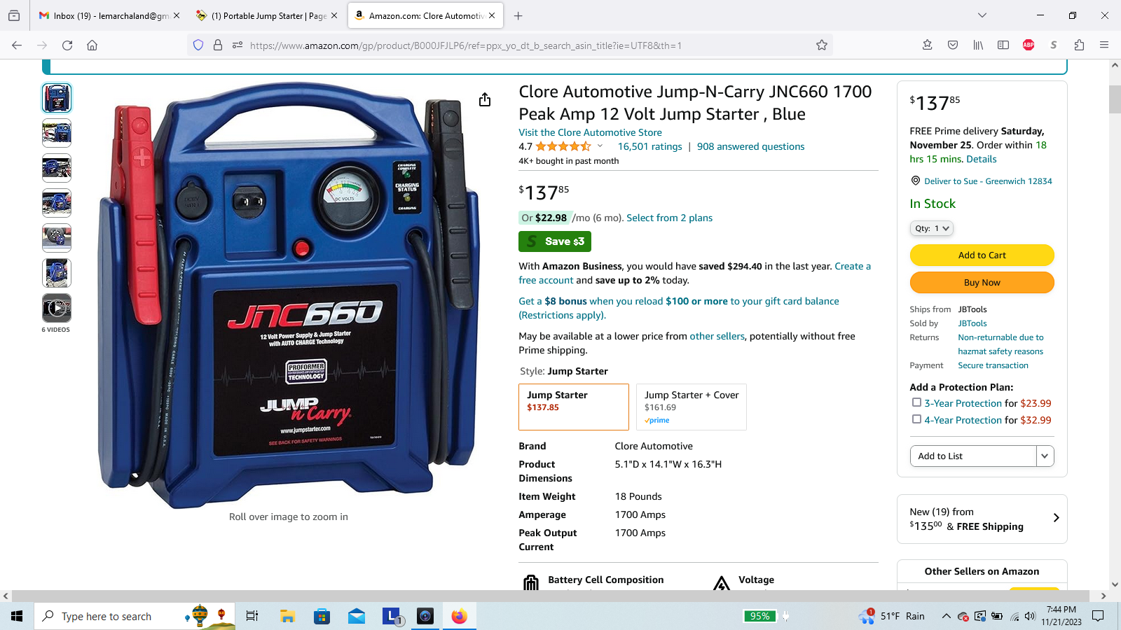

This is my go to starter pack we have one on the farm and I keep one at my place it works for starting tractors and is hany for running 12 Volt fuel pumps and air compressors. The round bale wagon requires electrical to operate some diverter valves for the self loading / unloading hydraulics a few of the tractors that are used with it don't have good electrical hookups for auxiliary power so we just use the jump box to power the system.
This is heavier and bulkier then the compact ones but it works well for use and we have even paralleled them a few times.

The guys that have dozers and excavators seem to use this box a lot. It is 12/24 volt rated. 1700 amps. The other box I see that gets used a lot is the NAPA jump pak.
