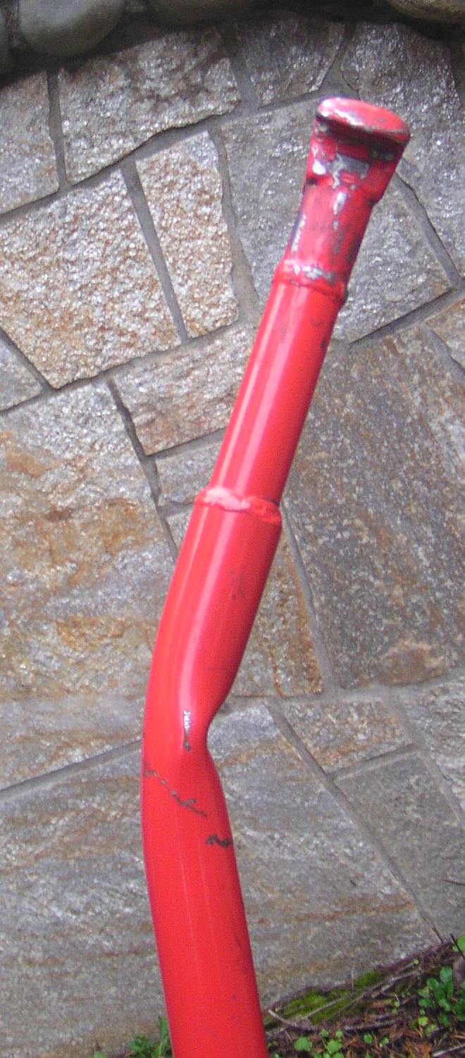

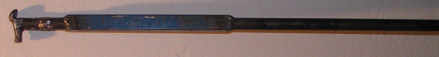

A cheater on the mounting hook is a bad idea.
I welded a longer, heavier duty shaft onto the hook. I had a lot of problems with it twisting. A piece of box tubing on the shaft gives the hook a lot of extra stability from twisting, and also strengthens the shaft somewhat.
I'm also contemplating the square tubing on the other end too help keep it from twisting and gouging the rim.
