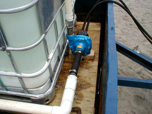

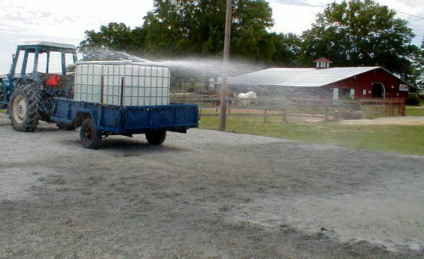

I made this water wagon out of a larger military trailer with a mobile home axle under it. It holds 550 gallons. It has a hydraulic water pump. I fill it with a 2-inch overhead pipe so I can't comment on self-filling with the pump.
The hydraulic water pump is great. It's quiet, gpm is good, and best of all I turn it on and off with the remote hydraulic lever. I paid about $350 for it several years ago. I have done lots of things with it, including fighting fire. It sprays right, left, center, or through a garden hose connection. I made spray nozzles by sawing a slit in PVC caps. They're threaded so I can change them. I use very thin slits to spray herbicides.

Pretty neat Gabby! :D I would really like to see a picture of the nozzles that you made. Are you ever concerned with the residual water or herbicide that may be left in your pump when not in use? If it were mine, think I would be temped to use cam & groove fittings on the inlet and outlet of the pump and quick connects on the hydraulic lines so you could better clean the pump and add 50/50 mix of water and anti-freeze to protect it further when not in use. (just a suggestion)
