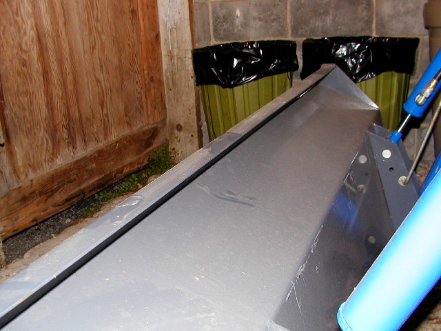

winchman, {attached} is a picture from the back of the bucket that shows the lip. Does this help?

If you were to have a piece of flat bar welded on the lip of the bucket to the back of the bucket, it would make a sqaurish cross section & reinforce the lip. This flat bar would be oriented perpendicular (+/-) to the ground if the bucket was level. Run it across the entire width of the bucket & if possible weld it to the sides as well.
If you really wanted to get fancy, you would put some small pieced of flat bar inside this soon to be created "square tube" parallel to the sides of the bucket. This would create compartments in the tube and help keep everything together.

Thanks for the info! Would it also be OK to weld the proper diameter pipe underneath the lip?

Great picture Mike! The top edge of your bucket looks almost identical to my kubota's. I re-enforced the tractor-side top edge of mine by welding a piece of heavy wall pipe the length of the bucket. I chose a diameter of pipe that just contacted the top edge of the lip and then came tangent to the back part of the bucket that is angling down towards the front wheels. Your welder will know how to beef up that top edge. Square tubing could also be used. Mike, in your situation I would take the bucket to the welder and have him beef up the top edge and weld on your hooks. This is a maximum 1 hr job and I'm no pro welder. That was the first customization I did when I got my new tractor/loader because I had seen so many bent top edges on buckets with that design. It's cheap insurance! You will love having those hooks on there. Sorry I don't have a camera!

That's funny! I was typing a reply to you and you replied to Hazmat asking about pipe. Yep, the pipe worked great, but not the only option.

Pipe is the simpler option. If you can get one that fits to your satisfaction, go for it. If not, the flat bar is your backup.

Now there's a neat idea! I have a standard (light) duty 61" Deere bucket and the "roll" at the top of that bucket is down and back into the bucket as opposed to up and back over the bucket at the top like the New Holland. A piece of heavy pipe in there for reinforcement sure seems like a great way to go.
