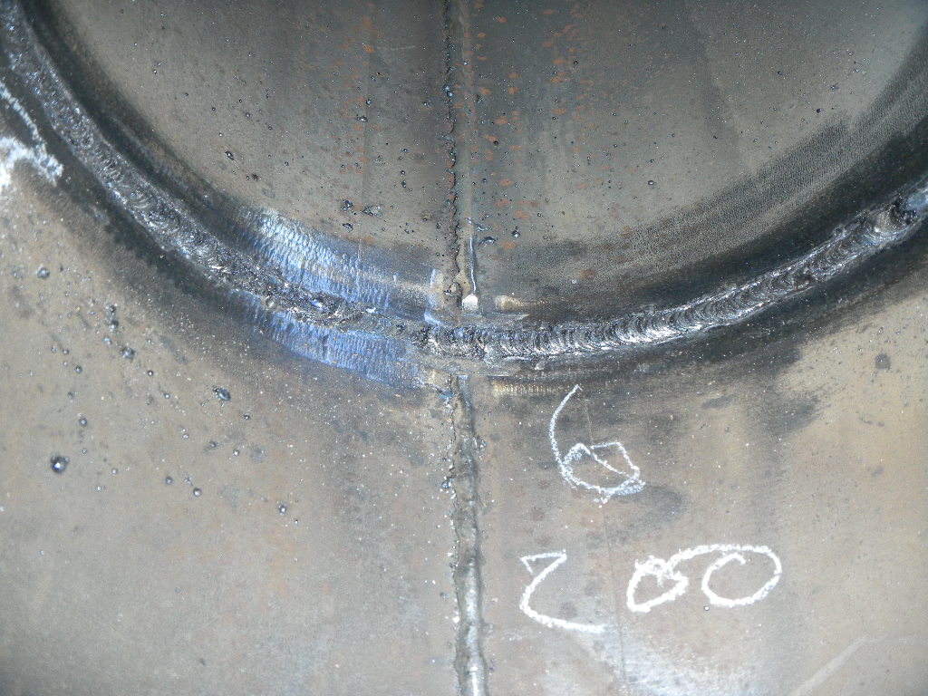

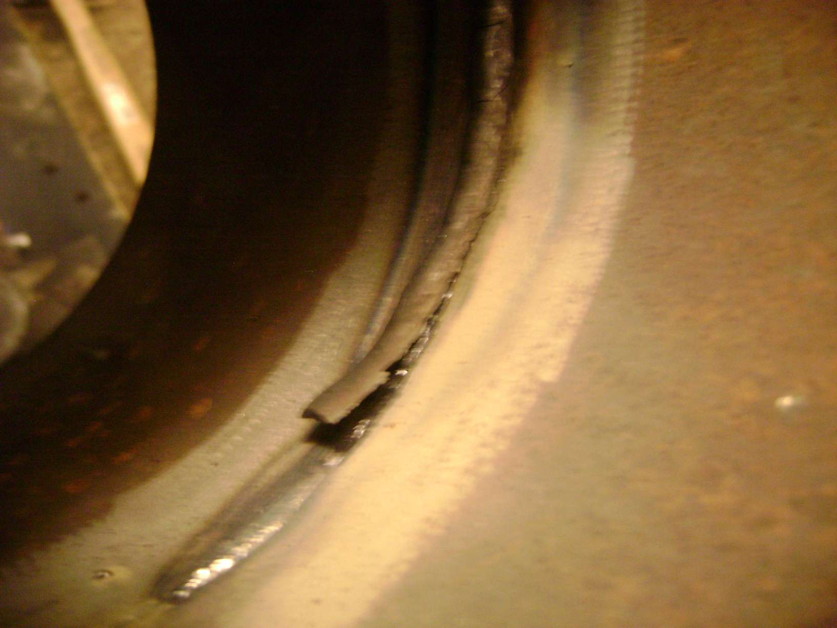

I'm no pipe weldor by any stretch of the imagination:eek:. But here is what the inside of a pipe looks like with 7018, and 6010 run on DCEN. Both run uphill.
First picture is 7018, second picture is 6010.
