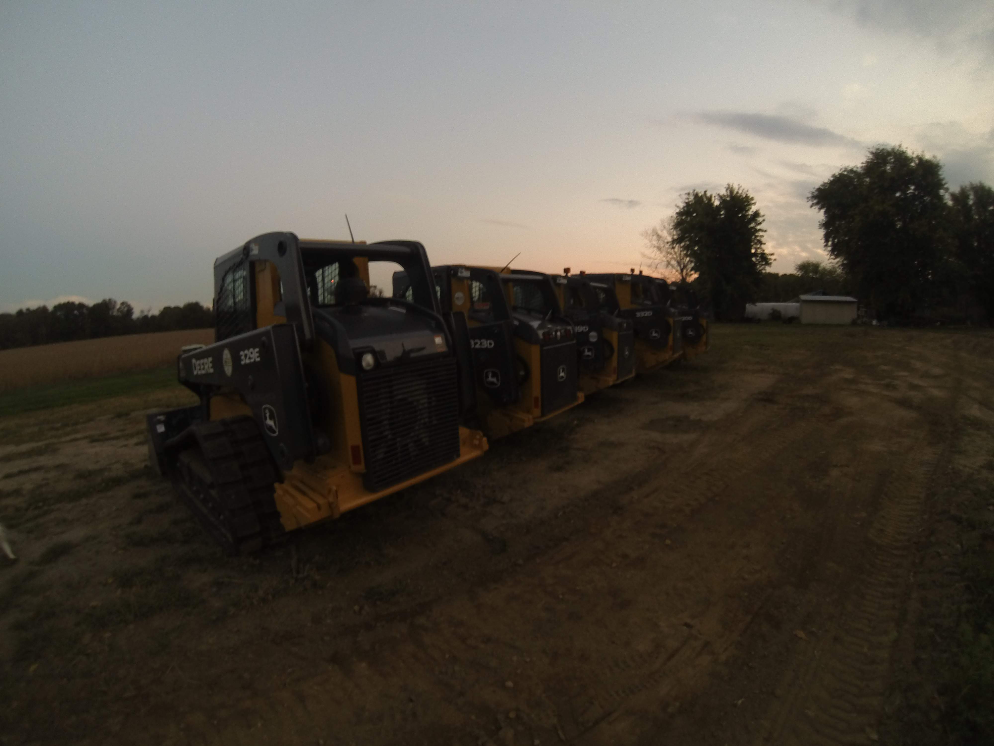

here are a few photos of the Deeres....

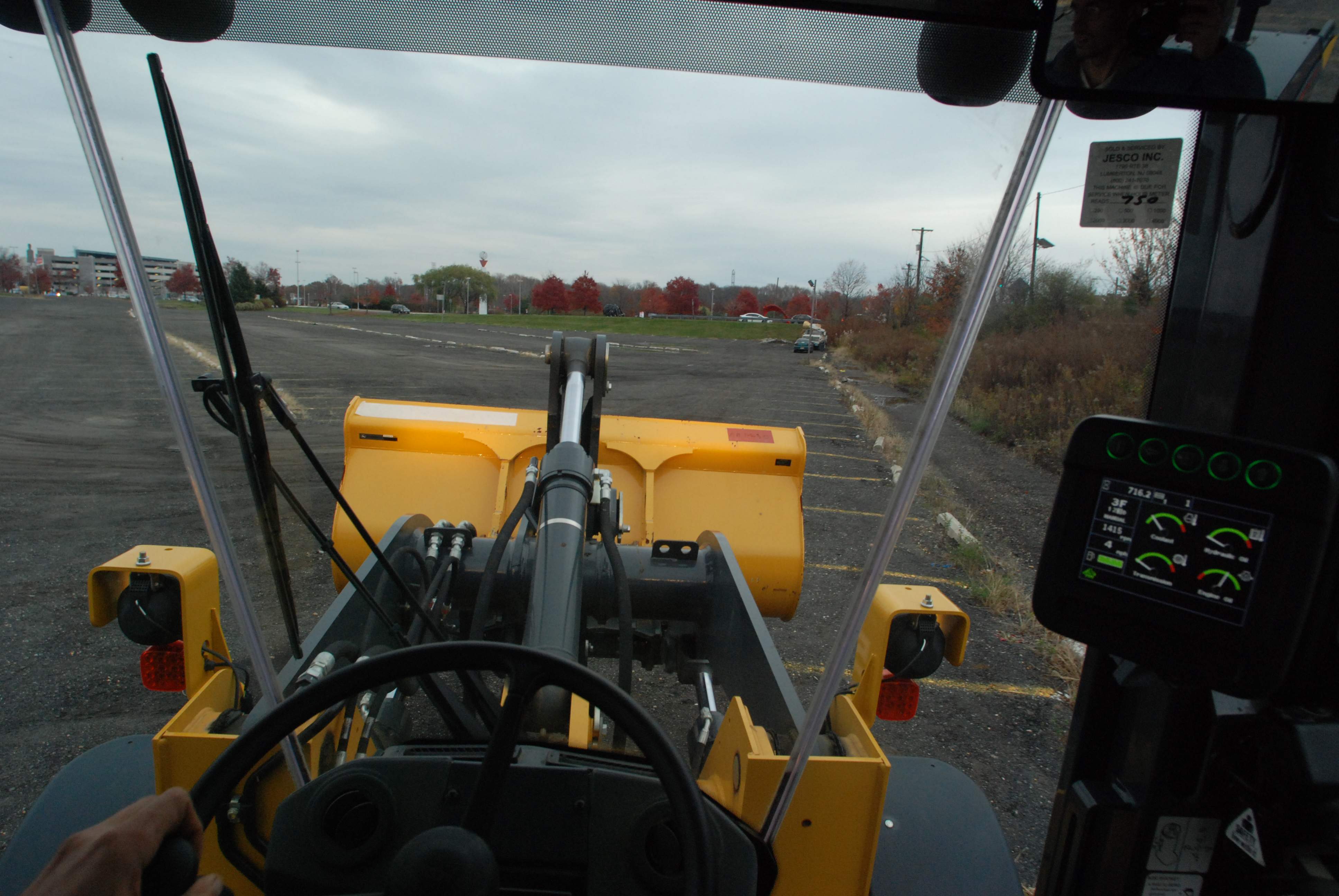

a few more, when some machines were stuck... actually for my own new driveway project alleiving the swamp on the one side with a new pipe, got every machine stuck at some point.. probably needed more like a 20 ton excavator lol
