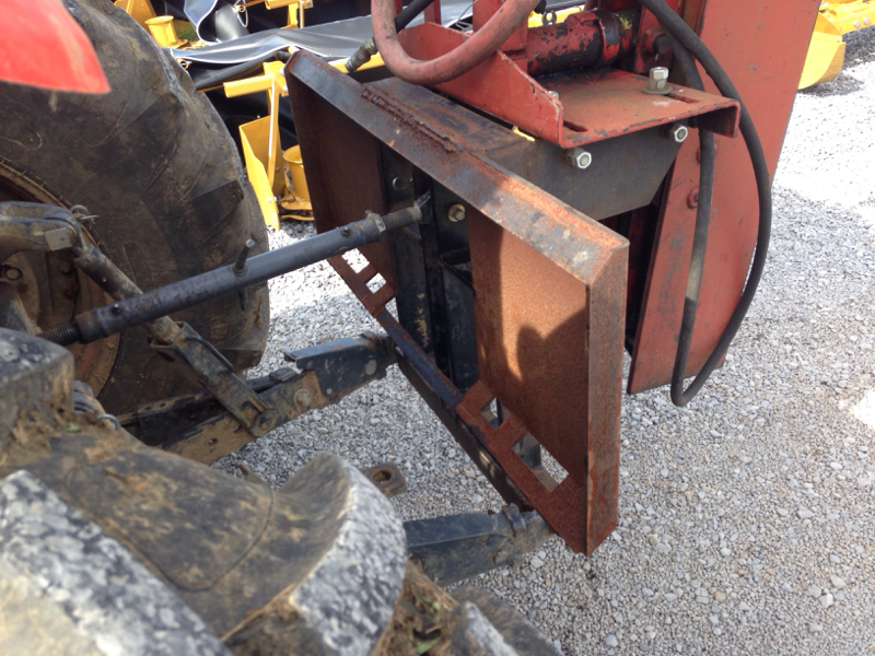

I have a HD8 that my late Dad bought in about '75 or so. Man, that's a great tool. We mounted it on the front of a trike front end 544 Farmall International. Left it on all the time versus how we should have taken it off when unused, and running the tractor for years raking and teddering hay allowed the bouncing to fatigue the metal around the to/fro and left/right adjustment head on the table. Finally it all just came apart last year. I'm about to start fencing again and am going to get it welded up again. I wouldn't mind getting it on a front end loader of one of the tractors. I have a lot of fencing to work on that I want to leave up, but add new wires to it (where its on tree and hedge lines). It makes me want to figure out how to get a skidsteer or pin-on mount for a loader set up so that I can tilt the driver out horizontal, drop it down on the other side of a fence, and have the open channel face the fence, so as to drive a post on the opposite side of an existing fence from the tractor. One guy on that side, the other guy on the tractor, and going down the fence line (with the posts already pitched over to be put in).

The one I just bought has a ssqa plate added but it doesn't interfere with the 3 point hitch. Don't know if they meant for it to be that way or if it just worked out that way. All it would need is longer hoses to be used up front.
Man, I like that approach. Best of both worlds. I've wanted to get my L4400 hooked to mine, and on the front would be best... that little 4wd will go anywhere and would be ideal for a fencing tractor. It's loader came without quick attach, so I'd have to grind off the bucket stops to use the aftermarket kit to go quick attach. I keep thinking of selling that tractor, but it's the only 4wd I have and is handy in tight spots.
