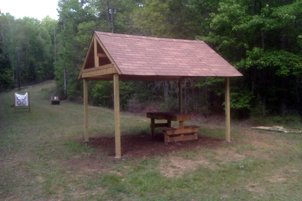

   / Post frame shed? #13
One of the first things I built when I bought my acreage six years ago: A pole barn above my shooting bench, to keep the sun and rain off my head. Works as good today as the day I finished, and requires just about zero upkeep. I made the trusses from 2x4s. I don't think I spent more than $300 on the structure, including the roof.
