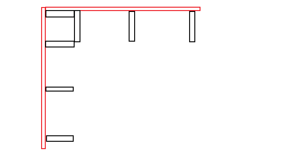

I think jackstuds would eliminate the my reasoning for going full length for rigidity. The sidewalls will be tied to the gable wall the full length of the 2x6 studs where the two wall sections meet. And everything is tied together with sheathing. Here is a top down view of how I will do the corners
Red is Sheathing Black is the studs

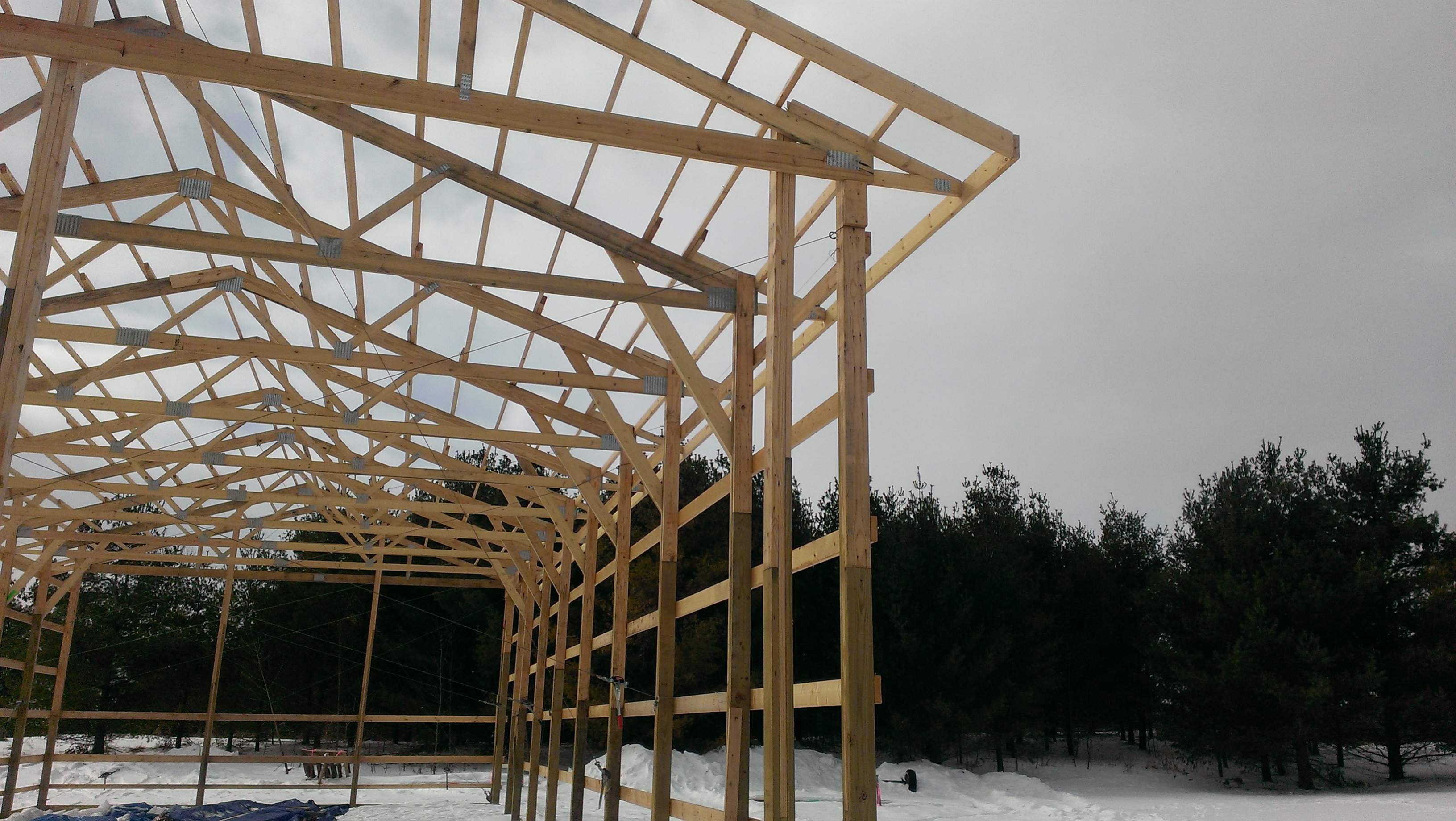

Don't know how you would go about framing it. Going to want the top plate going all the way around. I was always under the impression the reasons for the poles going to the top on the end walls for pole buildings was wind load. Here is the pic of wind bracing on one we have going up now. There is still corner bracing to go. We have 16 ft side wall so little more wind load. I have always been paranoid about opening the doors or having strong wind blow the doors in and finding the roof next door. On the design it looks like you are headed towards, ring shank nails on the roof sheeting, hurricane clips on the trusses, walls anchored to the footings. We have had couple of tornados go through here, and you could tell the buildings that were built for the wind load.
Basically it is going to be built just like a normal building with an endwall truss. Only without the bottom cord of the truss, and the vertical members of the truss extending all the way to the foundation.
Yes, the rest of the building will be built appropriately. J-bolt anchors to the foundation, hurricane ties on the trusses bottom cords tied together and angle bracing from bottom chord of truss to top cord of next, etc etc.
Roof wont have sheathing. IT will be purlins like a typical pole barn. Only the walls will get the OSB sheathing for the siding.
