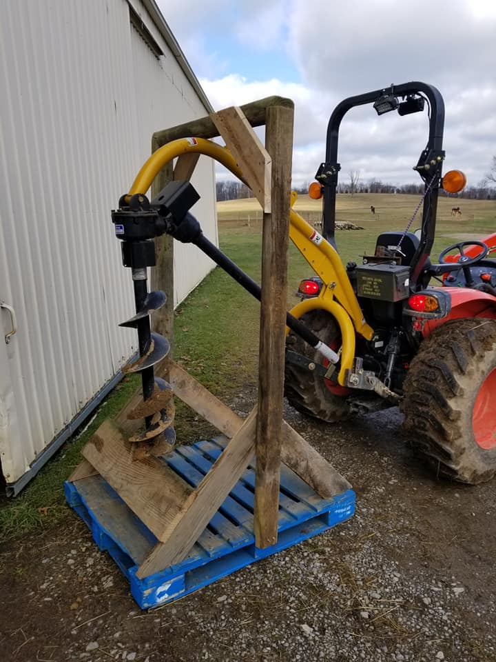

Did this up yesterday.

Nice job. Thanks for posting. I will use this to build mine.

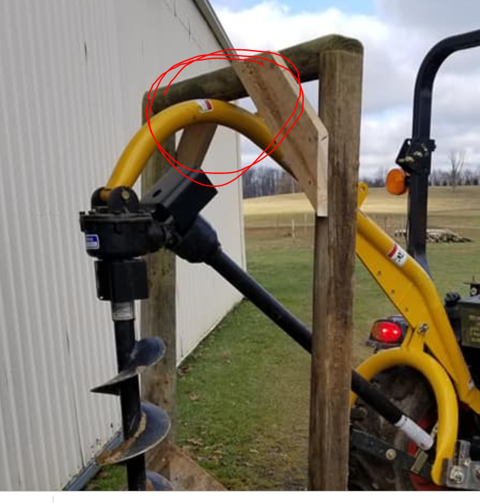

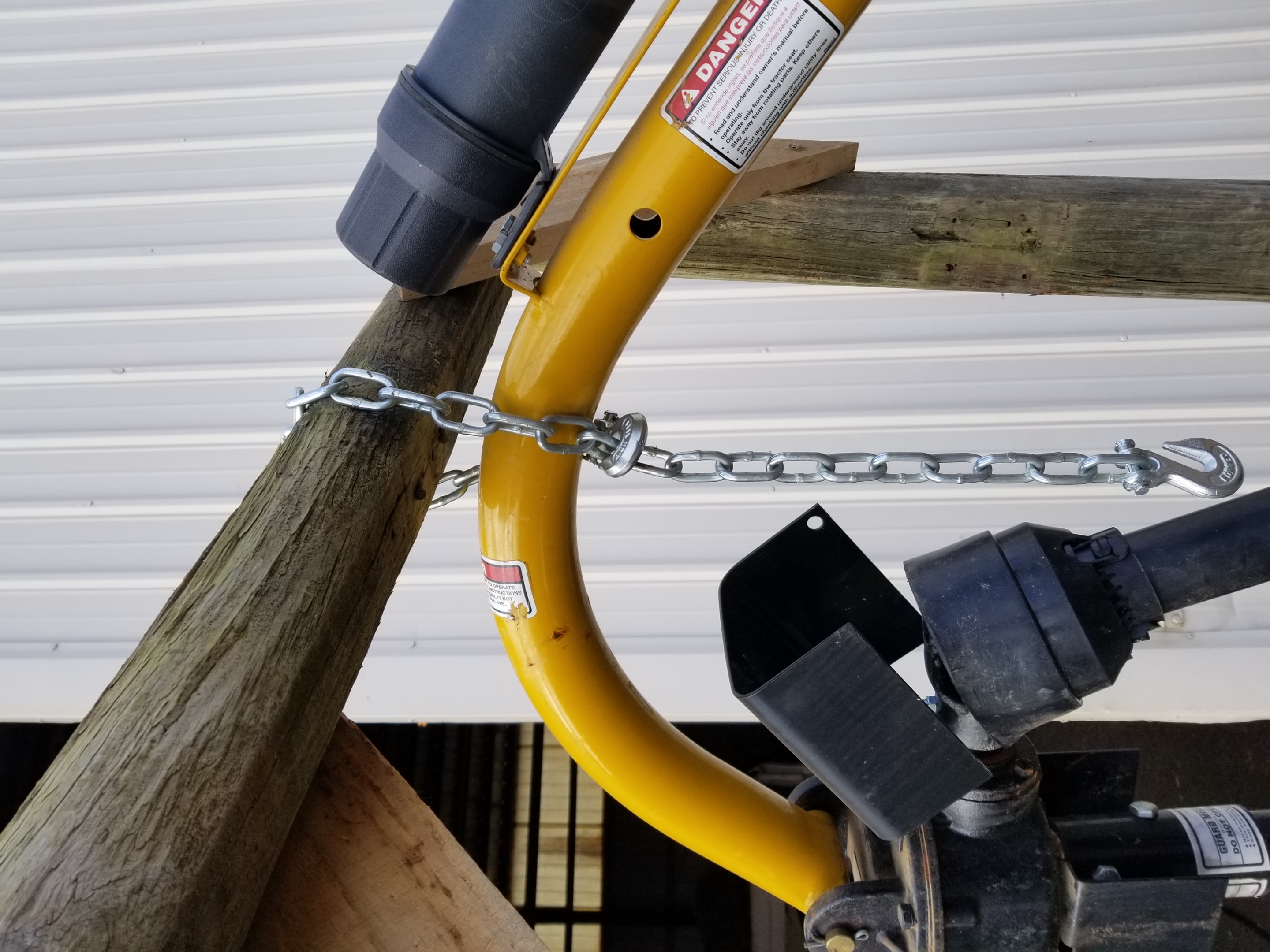

How do you support the auger at the top of the 2x4 frame? Can't tell from the photo but it doesn't look like the Auger is attached to the wood frame.

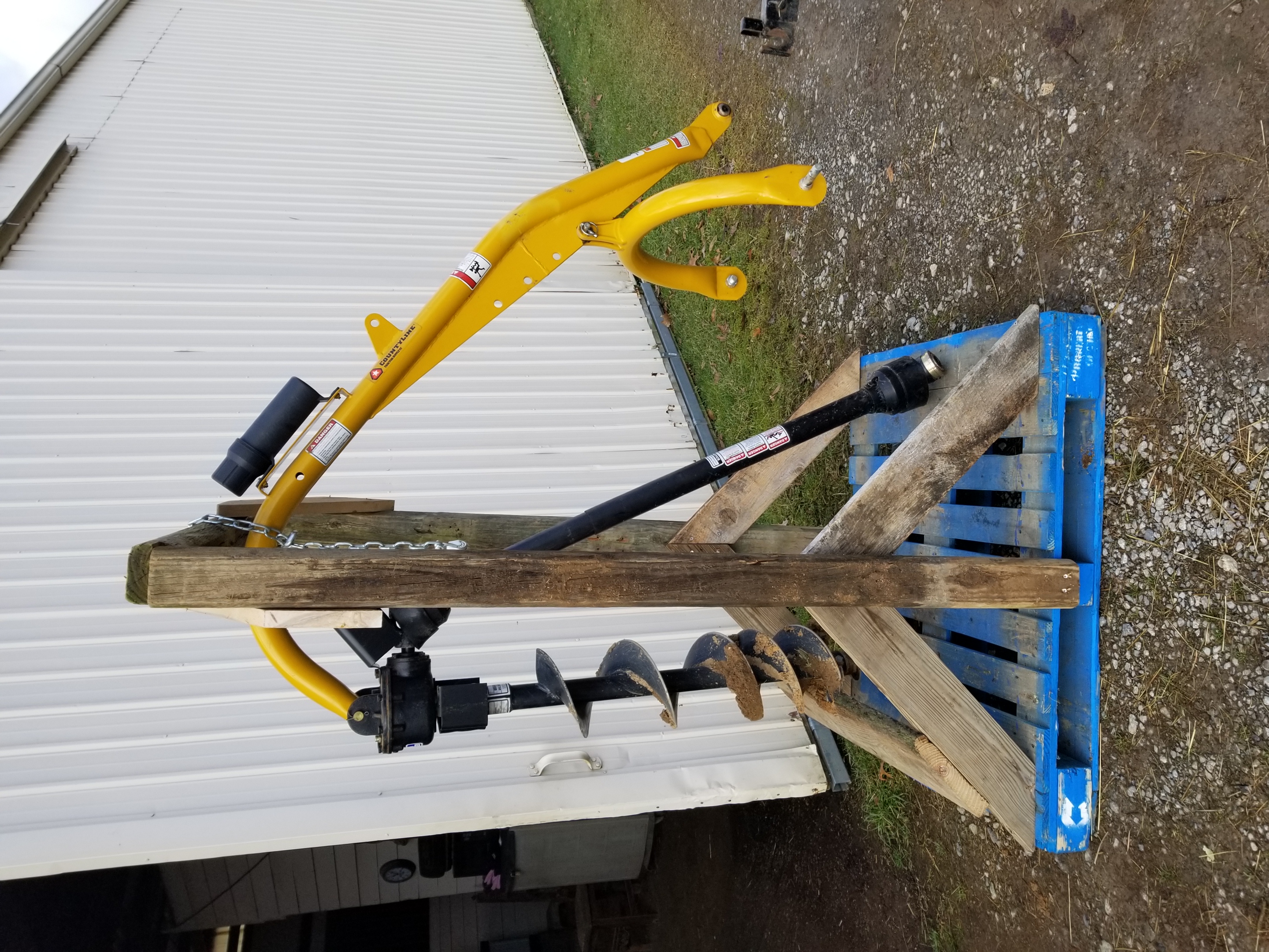

Used wood that was lying round and 4.5" structural screws leftover from another project (as good as lag bolts but no pre drilling).
Need to tie it on a bit better if i don't want it to move when on the forks, but it didn't "go" anywhere.

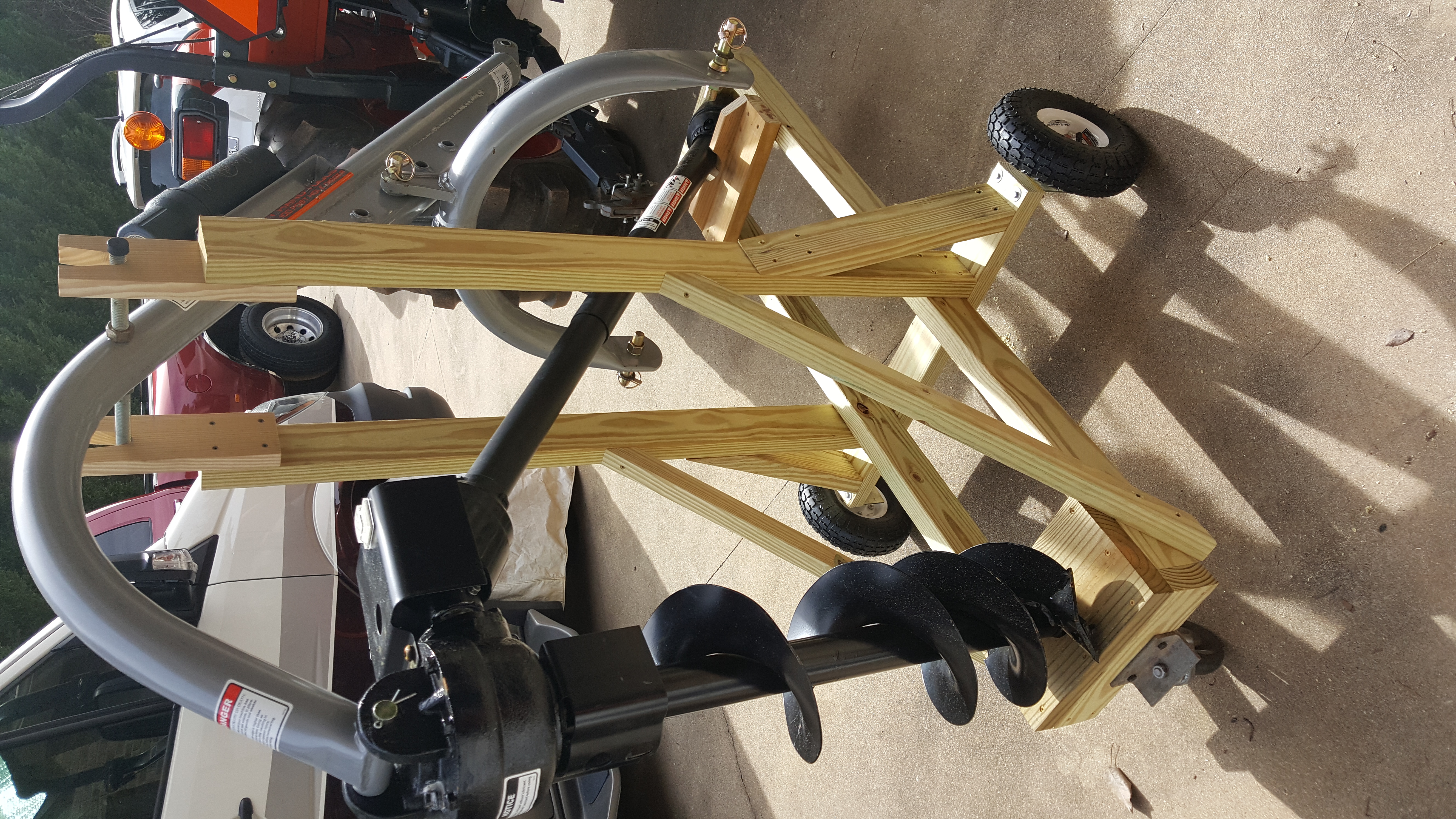

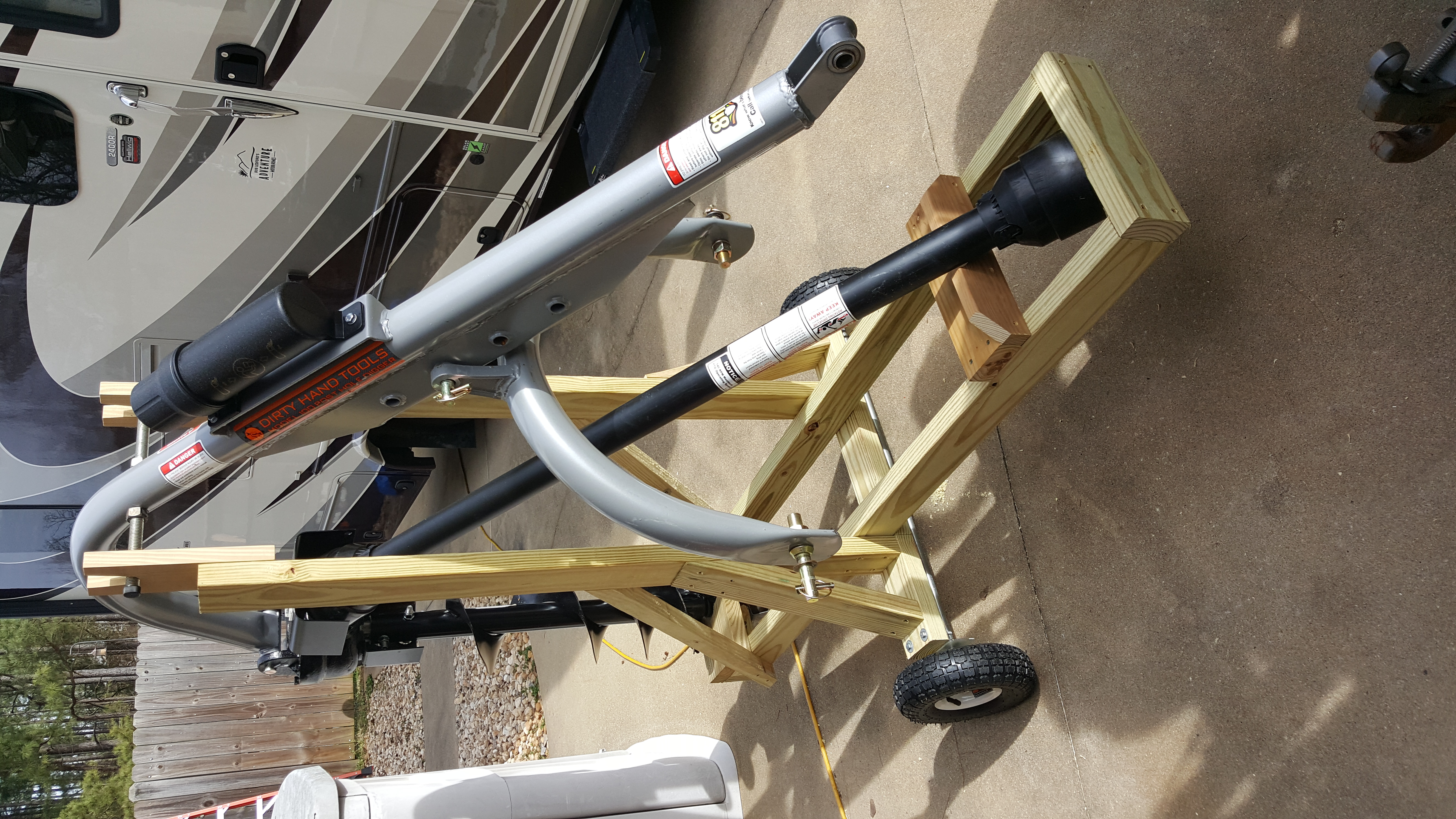

This is what I dreamed up.
