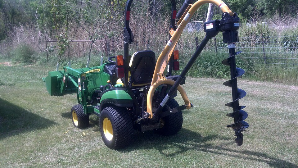

Works just fine with my Deere 1025r. Take it slow until you get the feel for drilling the holes.
