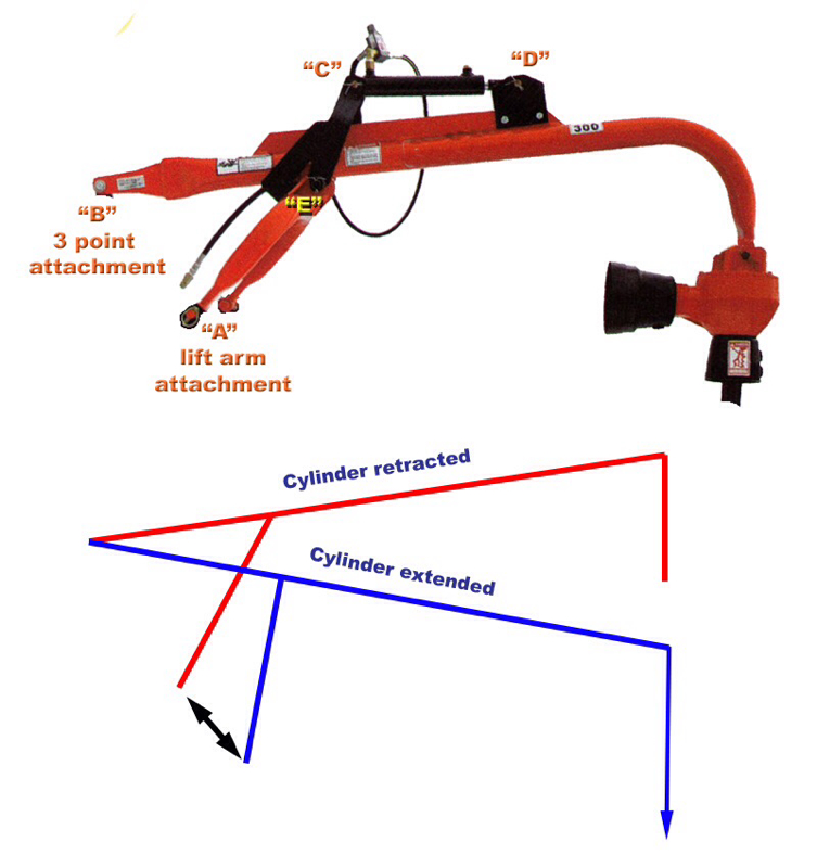

I just purchased a down pressure kit and getting ready to install it on my PHD. My question is how do the hydraulics connect to my 3rd SCV? I have two lines coming off of the cylinder with one connecting to my 3rd SCV. Where does the other line terminate? I can't quite tell from this picture. If anyone has photos of their installation connected that would be appreciated.

Keep in mind that you have a single acting hydraulic cylinder on the PHD. So the line to the cylinder is a pressure line and is connected to your rear remote. The line from the bypass valve is just a return line and that line needs to go directly to the reservoir. You may need to plumb in a return only port at the back of your tractor. ;)

From my 3rd SCV, there are two ports, would it matter which one I connect to? I had presumed that the this single acting hydraulic would connect to both.

The down pressure system is designed to allow the fluid to by-pass and return to the tank whenever the PHD is raised. Any time that the PHD is raised, the down pressure hydraulic is collapsed. If you hook both of the hoses to your std rear remote, that return fluid is blocked. You raise your 3pt hitch, the down pressure cylinder does not collapse because there is no place for the fluid to go to, BAD THINGS HAPPEN, COSTLY BAD THINGS. :eek:
The return hose HAS to be connected to an open return port. ;)
You can connect the pressure feed line to either port.
