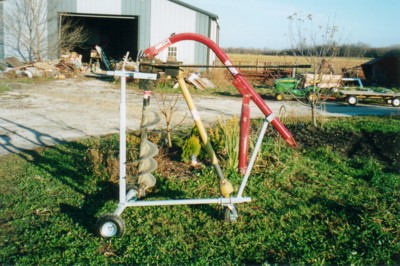

I was just doing a Google search and happened upon this site.. seems like a good idea, but the price might scare some people away........
post hole digger holder web page

   / Post Hole Digger Stand #14
</font><font color="blue" class="small">( Here'd the PHD ready to be installed on the tractor. )</font>
Looks like you have all that you can do just to lift it????? I always thought that Mountain Men could do things like this with one hand tied behind their back............LOL...... Junkman

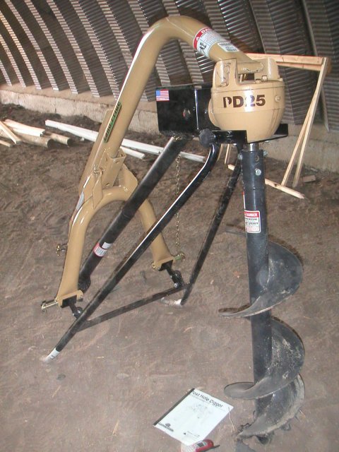

I finally received the landpride stand and got it put together. Here are some pics.

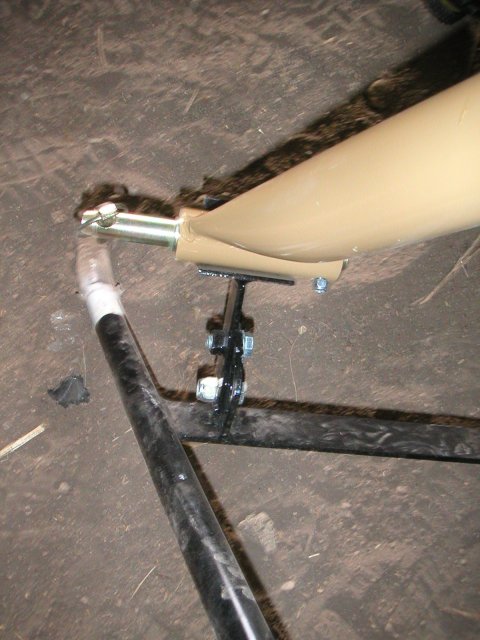

#17
The brackets that hold the 3pt links

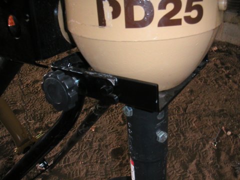

#18
This is the cradle and the plate that attaches to it. The plate stays on the PHD all the time. You need to take off the auger and guard to put it on the first time.
Overall I would say it works pretty good and is plenty stable. It also takes up very little space when not in use. You could just lean it on a wall.

   / Post Hole Digger Stand #19
Hi Zuiko,
Is there anything that holds the 3 pt arms onto the stand? Mine is way squirrely hanging from a tree; I'd be a little concerned it might twist somehow and fall off if there are not some positive hold downs.
Or maybe it is more sturdy than I imagine.
Thanks for posting the pics.
Ron
#20
The draft arms are held by brackets on each side (2nd picture). The plate on the gearbox is screwed to the cradle with those large knurled knobs. It seems like a pretty sturdy configuration.
