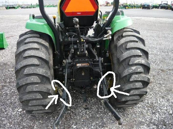

NEW THEORY:
For now forget about the 1/2" space on that connection that you are talking about.
Maybe it's your CHECK CHAINS? On my tractor, they are stabilizers (not real chains). Rods with a Turn Buckle on the outsides of the Lower Links (Arms) that keep them from swaying side to side (horizontally) too much.
On some tractor models, This stabilizer is on the Inside of the Lower Links. Nevertheless, they should always be adjustable.
Maybe your Check Chains are pushing too far Inward (Lower Link Arms together). Try spreading those Lower links outward from each other, asumming that the attachment is already on. This would really help stabilize the connection on the bottom end and take up some play.
Think of your 3PT(3PH) as a triangle. The bottom of the triangle is horizontal. Instead of trying to level it with the top/tip of the triangle. Wouldn't it be easier to level/stabilize it with the bottom corners carring the load?
Tell me what you think.

   / Post Hole Digger Tilt #18
...Unfortunately, my tractor does not have the Check Chains you spoke of...
Well, I belive that's really the problem. You should have Check Chains/Bars on your tractor. And if you don't, you need to get them installed. Anyone else agree? They will help with the stability and prevent the attachment moving from side to side.
I attached a picture of a JD 3520 with them.

   / Post Hole Digger Tilt #19
Houston, we have agreement!
I have a TSC PHD also, but I don't think it's characteristic of that brand/model. If the check links/sway bars are loose on my tractor, with the auger tip on the ground, the head can sway right or left as much as a foot. The slop, at least on mine, is coming from the lift arms moving from side to side. IMO, the OP needs to install check chains or some other type of restraint to prevent that movement.
   / Post Hole Digger Tilt #20
I agree. On mine, the stabilizer bars have a series of holes plus one slot. The slot allows for about an 1.5" of swing, side to side, of an attachment. When I used the slots with my PHD, tilting was much more of a problem. I switched to the fixed hole positions that allow no play and most of the problem went away.
