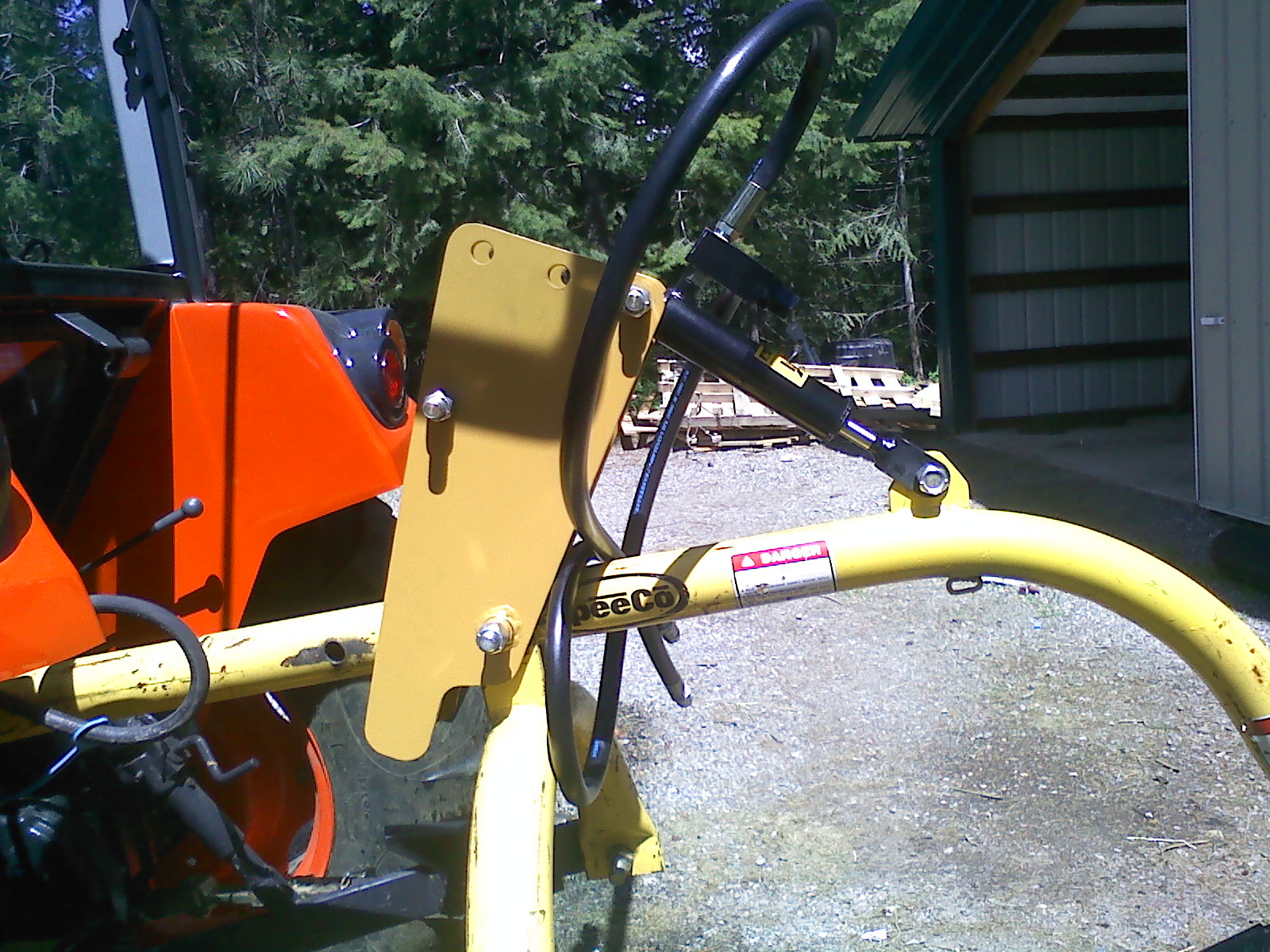

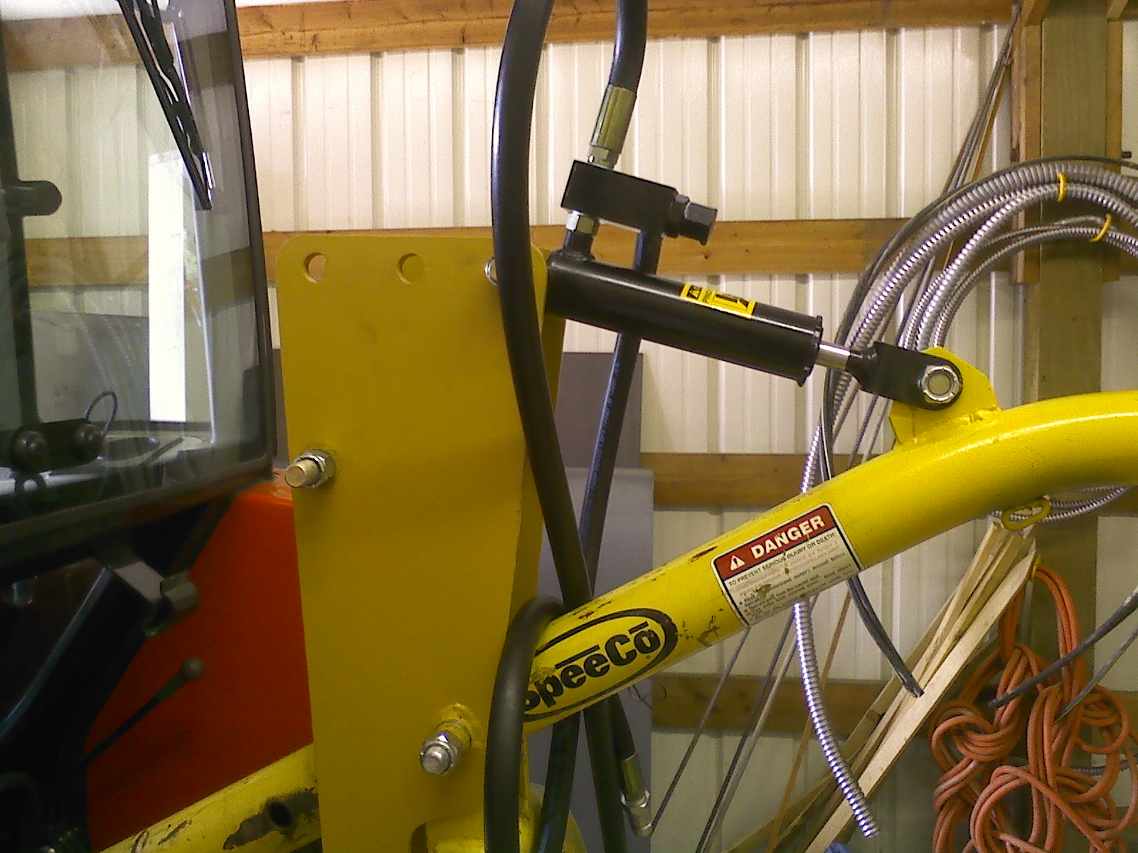

ive have a 3 point mounted pto powered post hole digger for about 12 years. the best time to use it in out decomposed granite type soil in north idaho is in the spring and early summer.
As the summer progressed, it was harder and harder to drill a hole. As i didnt do enough holes to justify the cost of a loader mounted unit, i simply added a hydraulic assist to my rear unit.
Speeco sells such a unit. it adds about 250# of down pressure during the digging. its single acting valve so when you raise the 3 point, the hydraulic assist stops automatically.
it works GREAT.
