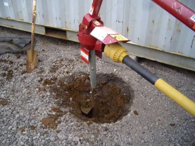

I have a Worksaver posthole digger and due to the geometry of my Yanmar 1602D, I can only dig a hole about 36"deep. I took a look at setup, there appears to be a couple of different solutions.
1. Build a new plate(s) to hold the top link to the tractor that is taller, moving the tractor end of the lever vertically 6" or more. There is lots of room for this, and I belive that the mounting point can be built with sufficient strength.
2. Make an adapter to extend the length of the post hole digger.
3. Add holes to the lower link arms to lower the digger. I don't think that enough depth is available through this method.
Any other solutions, advice,.......

If you decide on option #2, Bush Hog and others make 8" and 12" extensions for the augers; i.e., you can buy instead of make adapters if you wish.

I looked locally for an extension, but none available. If I ordered one, the shipping cost to get in less than 5 weeks would nearly doubled the price.
I went to HD and bought 2 length of pipe, 2 in and 1.5 in and made my own. Hardest part was drilling the holes in the pipes.
Wife and I augered 9 holes 64 inches deep.

David,
Did you have enough height to lift the auger without disconnecting it?
If I put more than about an 8" extension on mine, it wouldn't clear the ground moving from hole to hole. So if I did something like that, I'd want to use pins to hook it together.

I had a built a 12" extension this morning, I will probably adjust the geometry again, so I get an 8" gain or so, but can travel between the holes without disconnecting it.
