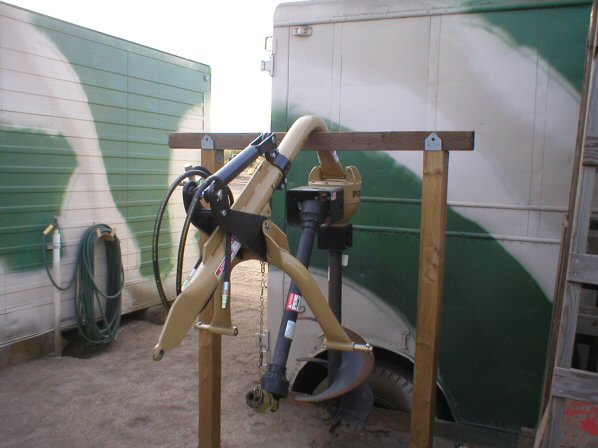

This is how I hang mine. Works very well, takes about 5 minutes for complete hook up.:D Top 4x4 is removed after PHD is hooked up, then drive away.
