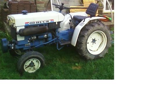

I have the same tractor with the RM48 with side discharge, I couldn't really mow my "pasture" with grass over my hood without the discharge shoot getting all clogged up. Hence the reason I talked my wife into letting me buy a bush hog. Which I love, but again, I WISH I had bought a 48" instead of the 42".!
0701111235a.jpg With the RM 48

I took off both side plates so the grass clippings just go right out. I also run it in PTO speed 3 (which is overspeed I know) Running it in low-2nd or low-1st gear, it can tend to get bogged on the higher PTO speed. With the PTO in speed 2 it doesn't tend to bog down as much but you have to go in low-first gear or it misses too much grass. It makes a messy cut but hey, it's farm grass not a suburban lawn.
