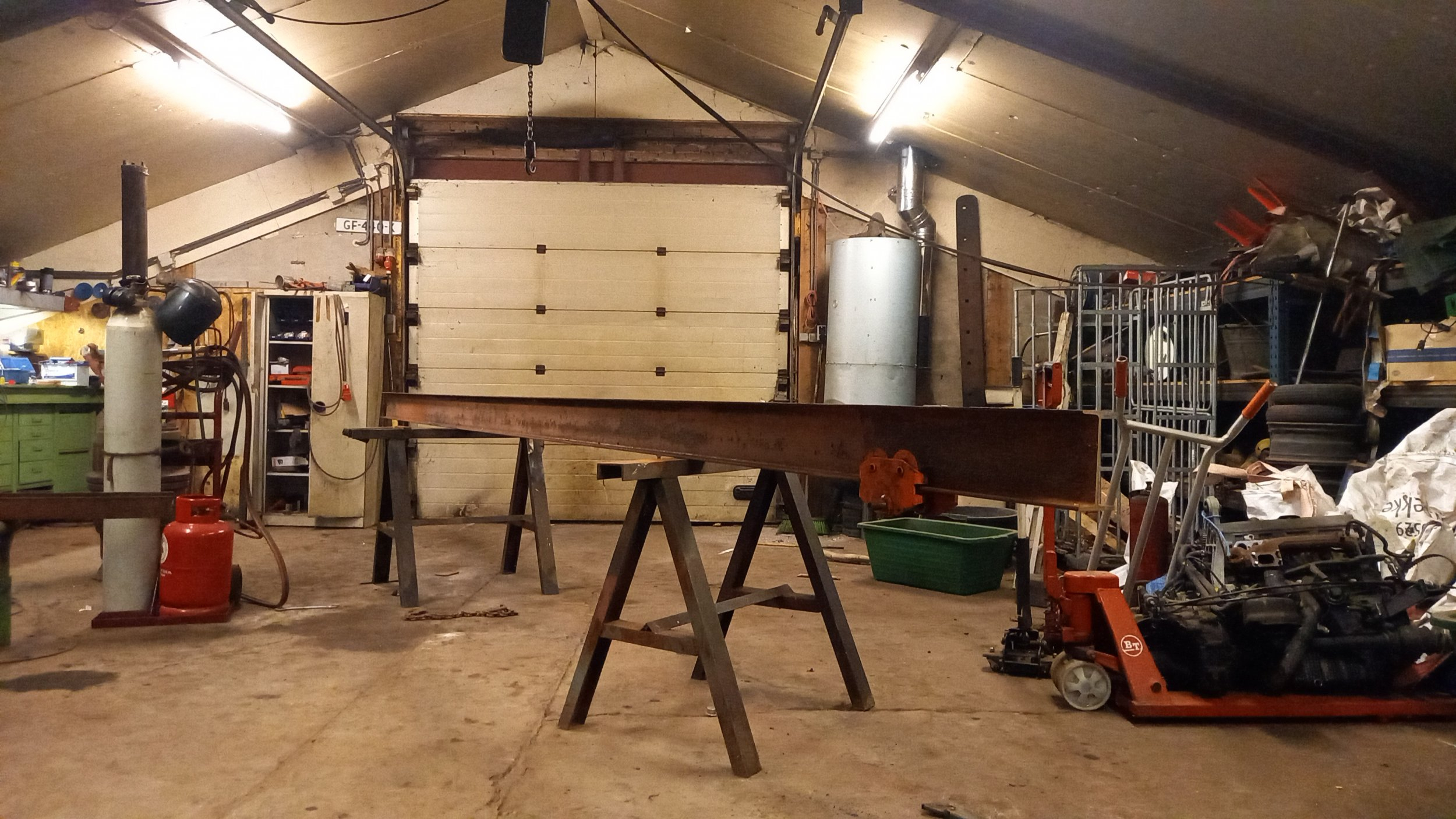

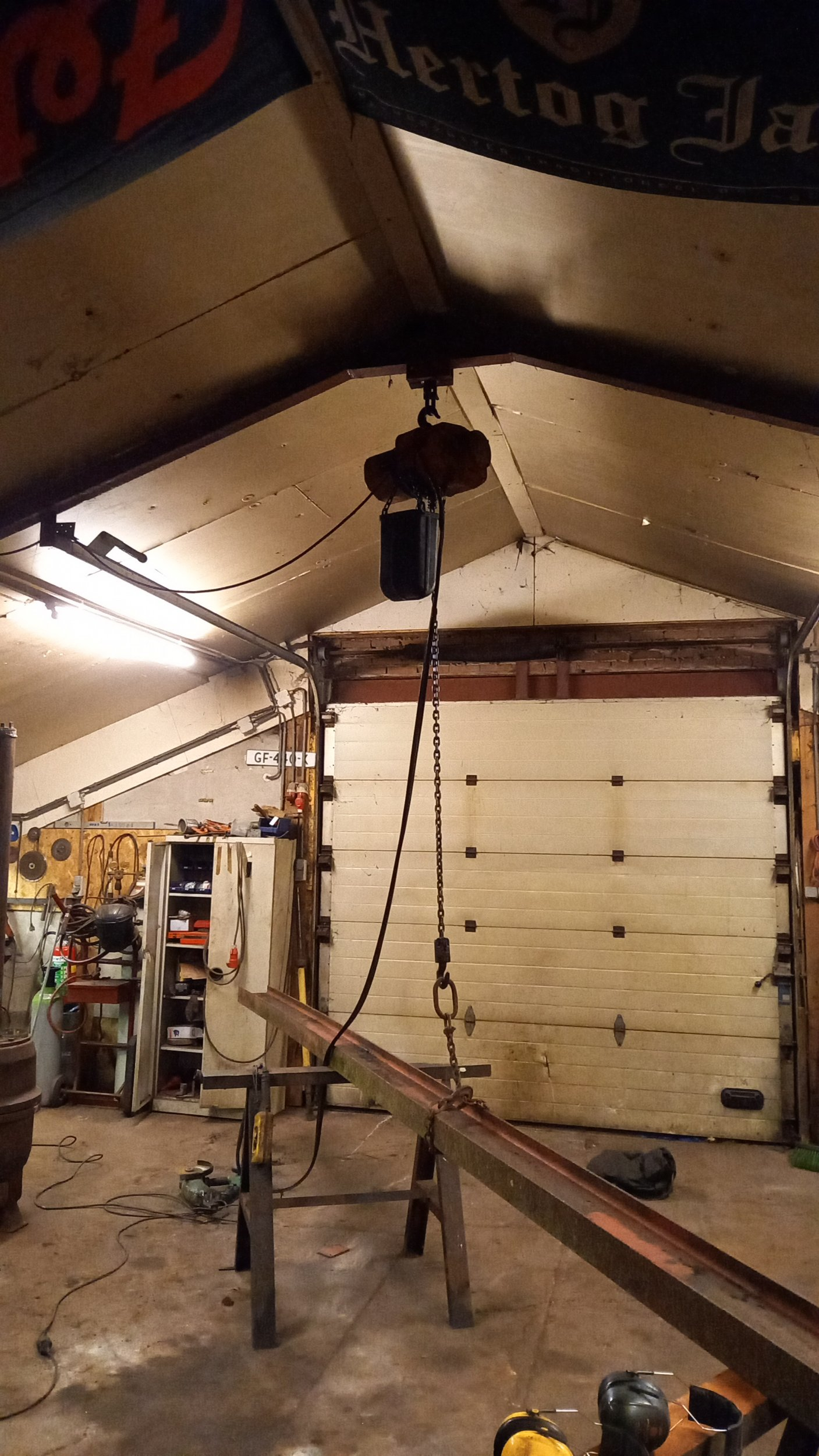

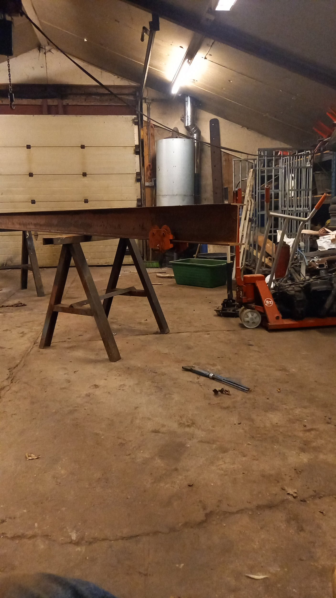

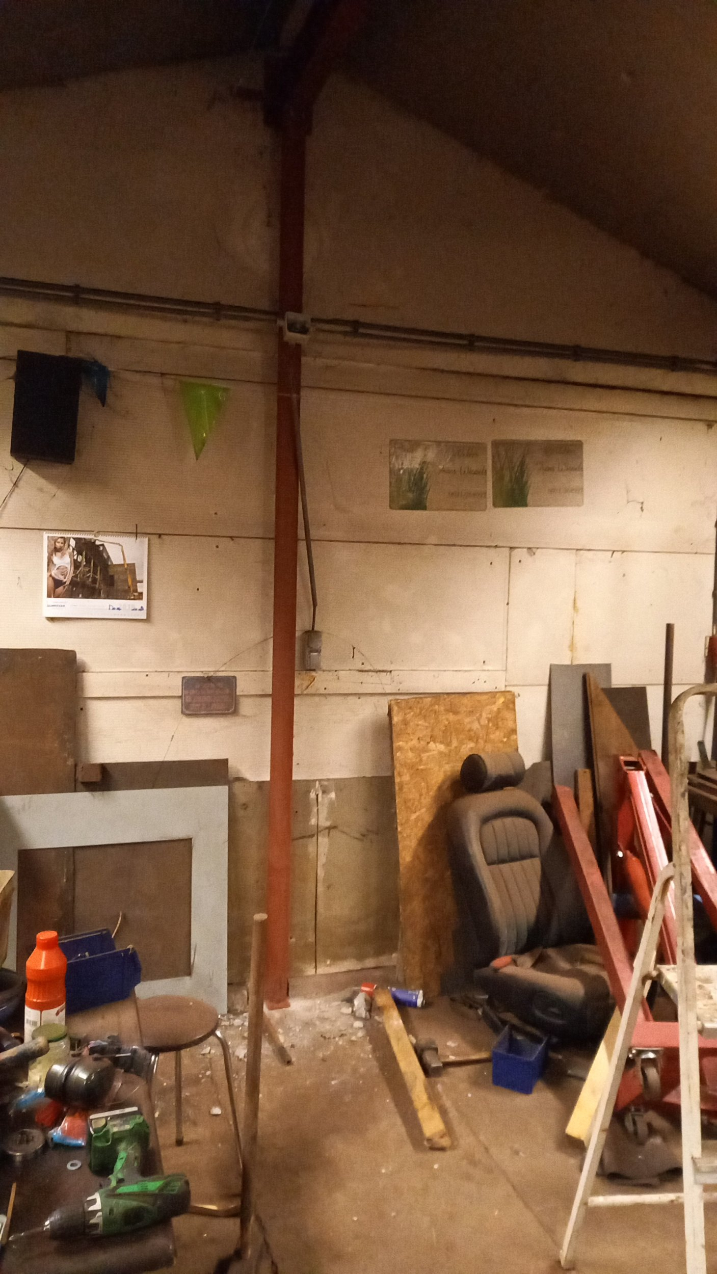

I have a 500kg Hitachi chain hoist on a beam in my shop, but my friend decided it needs a trolley before he helps me rebuild a tractor 😉
The used beam is flame straightened, and this week it will go under the rafters.
I was wondering, how does everybody have their umbilical power supply to the hoist: with a sliding door rail system, or is a steel cable with chain links as sliders, satisfactory ?

I have done it both ways over the years. First one (done 30+ years ago in my dad's shop) we zip tied 2" rings to the power cable and then the rings slid on a steel wire. Worked fine. When I did my own about 10 years ago, I used barn door rail with little wheel trolleys that had a cast loop on them, and zip tied the cable to the loop. I think that was overkill (and much more expensive) but it sure slid nice and smooth.
   / Post pictures of your shop crane
I already have a roll of leftover new steel wire, which was too thick for the overhead door. The ones with wheels on a steel wire, at the company i did my apprenticeship, never worked right, they allways jammed.

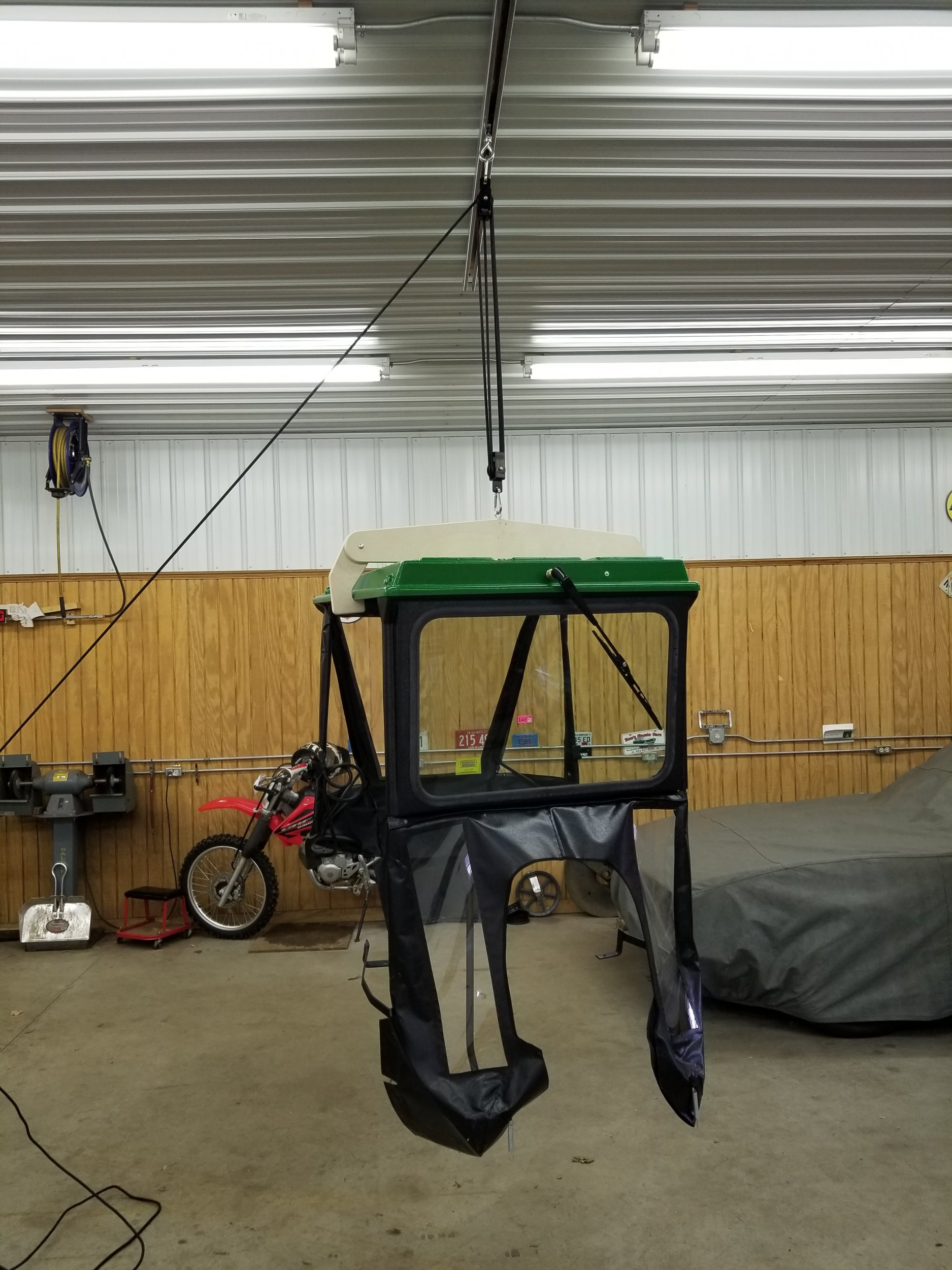

I have a portable that I use whenever the time calls for it but, it isn't as convenient as what you guys are doing. Nice job!

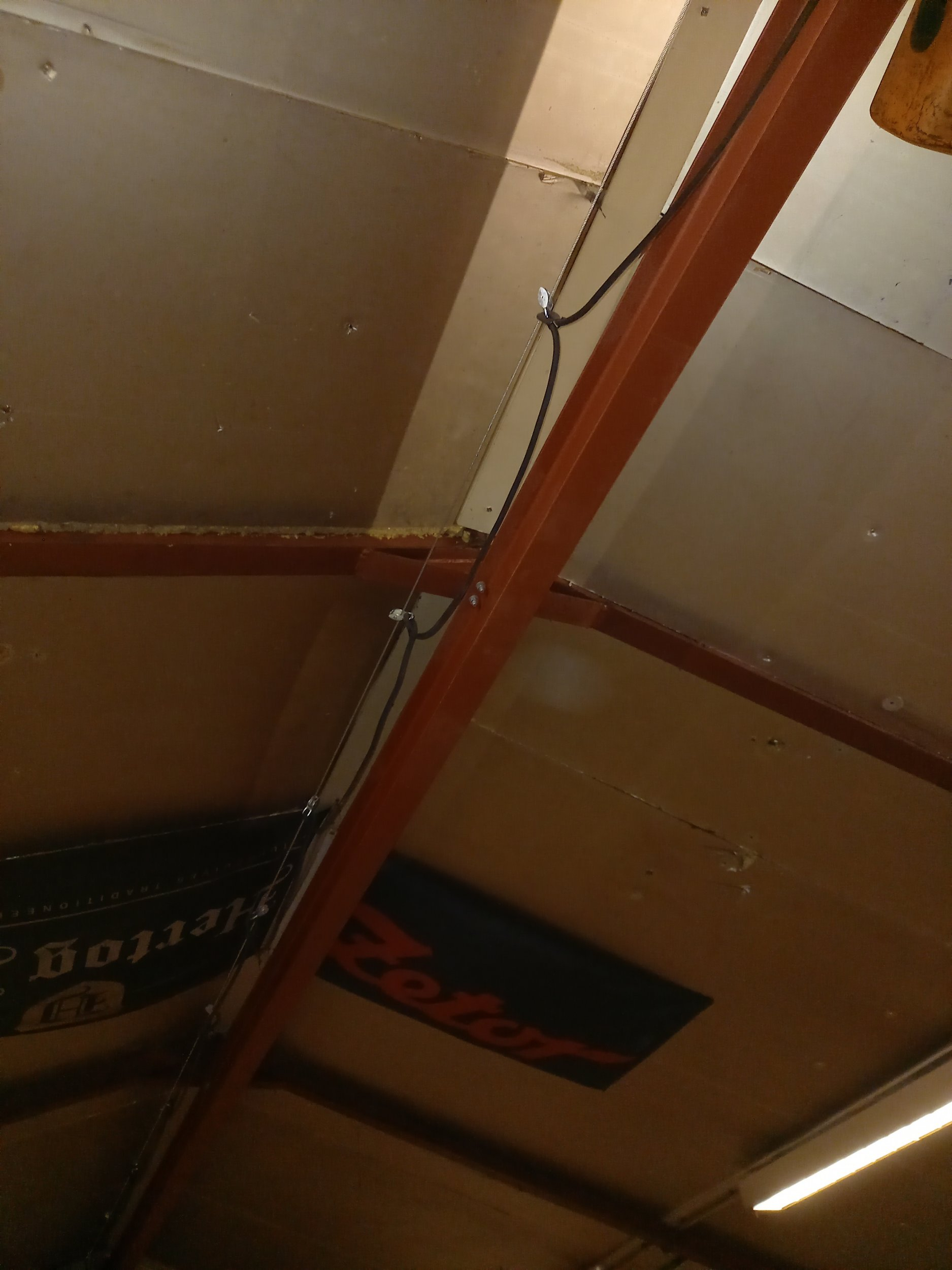

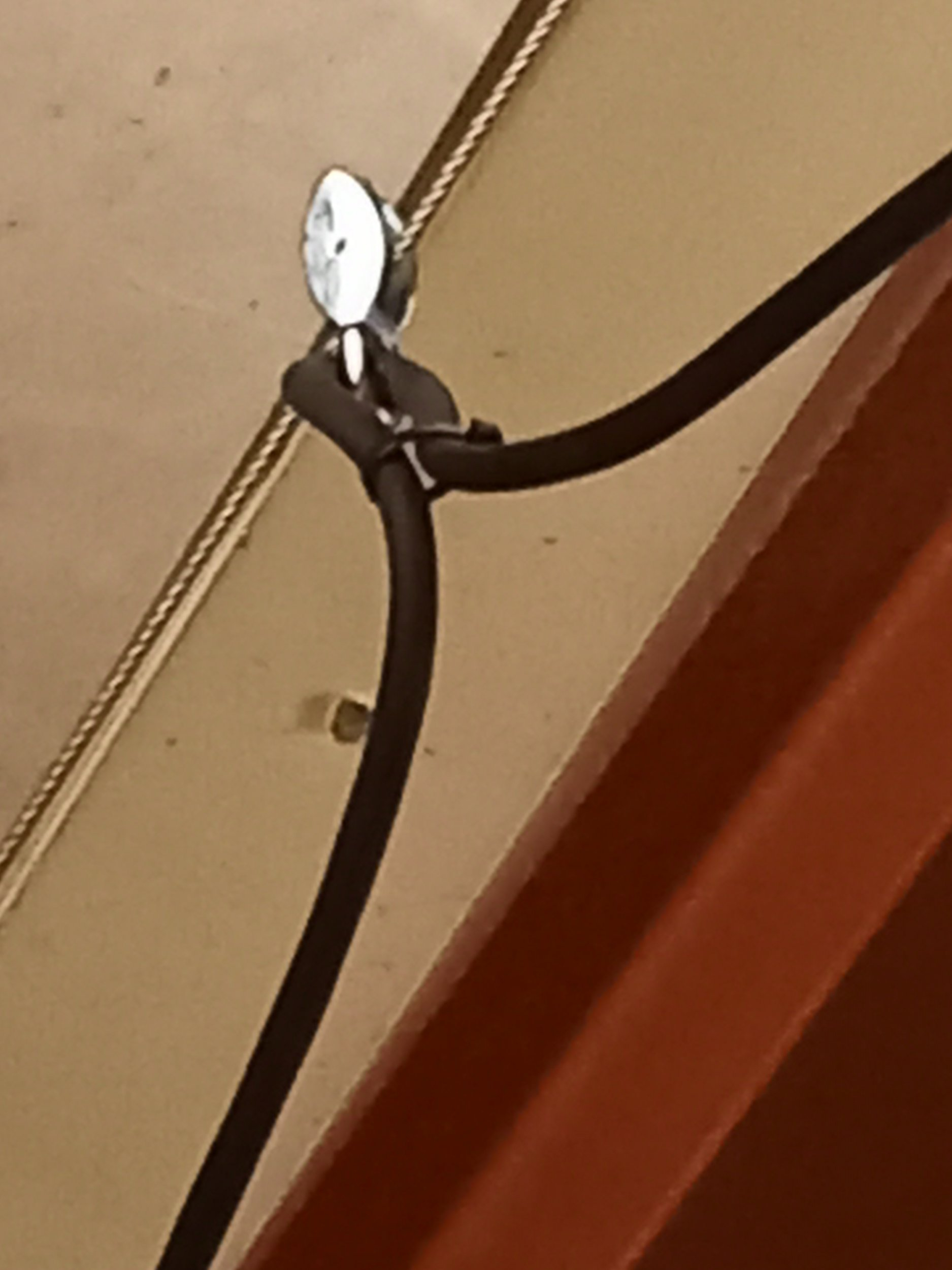

Got a pole at the wooden wall to support that end, and have the stuff hanging. My mates brother in law checked yesterday, and said he wanted it down at ground level to replace some burnt wiring before hooking up the electrical cord...
I ordered cast aluminium trolleys with a nylon wheel in them to run the umbilical cord on the steel cable, we'll see how that works...

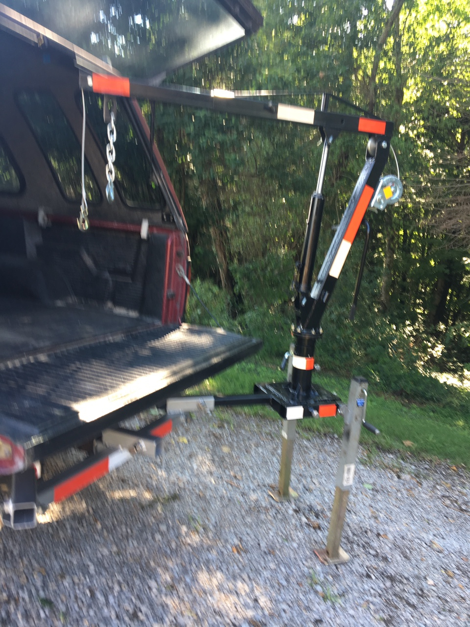

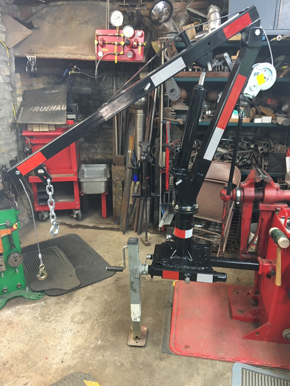

Have several 2” receivers in shop to mount crane or other tools. Attach to rolling welding bench to self load or for mobile use. Base modified to support multiple jacks for support.

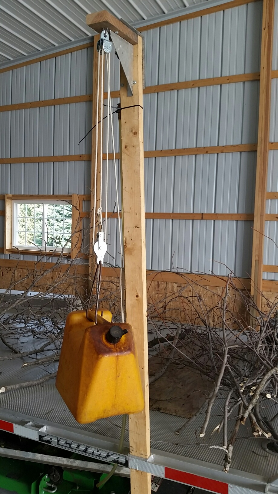

It ain't much but it works for me. A couple 2x4's with some grommets and a 3 to 1 pulley.

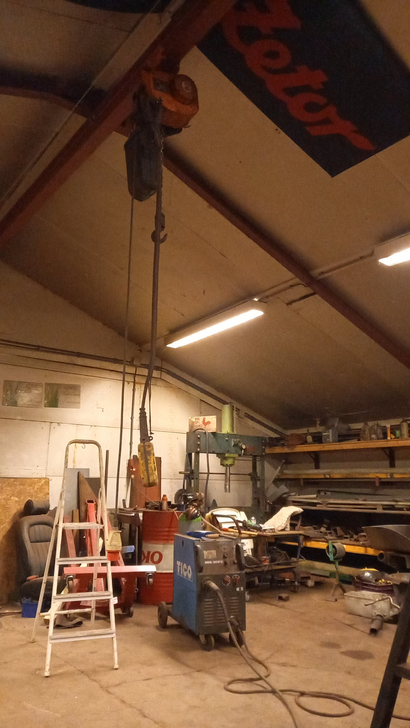

Got the cable suspended on the pulleys, but it jams. Next thing im going to do is order some swivels so which ever method i choose to fixate the cable in the eyelet, it wont cause twist which jams the pulleys....
