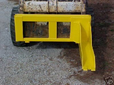

Bob, This is another picture showing the offset bucket. If you were to build something like this, I would build it so that the bucket would slide to any position , left side , right side, or any position in between.

</font><font color="blue" class="small">( Bob, This is another picture showing the offset bucket. If you were to build something like this, I would build it so that the bucket would slide to any position , left side , right side, or any position in between. )</font>
J.J., I appreciate your comment, but since the trencher is centered, and it would add a lot of complication to make it moveable, I don't quite see the need. Do you feel that the bucket you are showing can be used for other purposes? Can it also dig without a preexisting trench?

   / Post Trenching Trench Cleanout - MicroHoe #18
My thoughts on the off centered bucket would be to dig up close to a foundation, or fence. You should be able to dig like a regular bucket, just point it at an angle and power it down and scoop out a narrow trench. If you have the mini-hoe, you could make yourself a narrow bucket.

OK. I was not sure what they called that bucket and what it purpose was.
I thought about the minihoe microbucket. It would have to be at least six inches wide I believe to mount to the existing arm and bolts. There may be another way.
