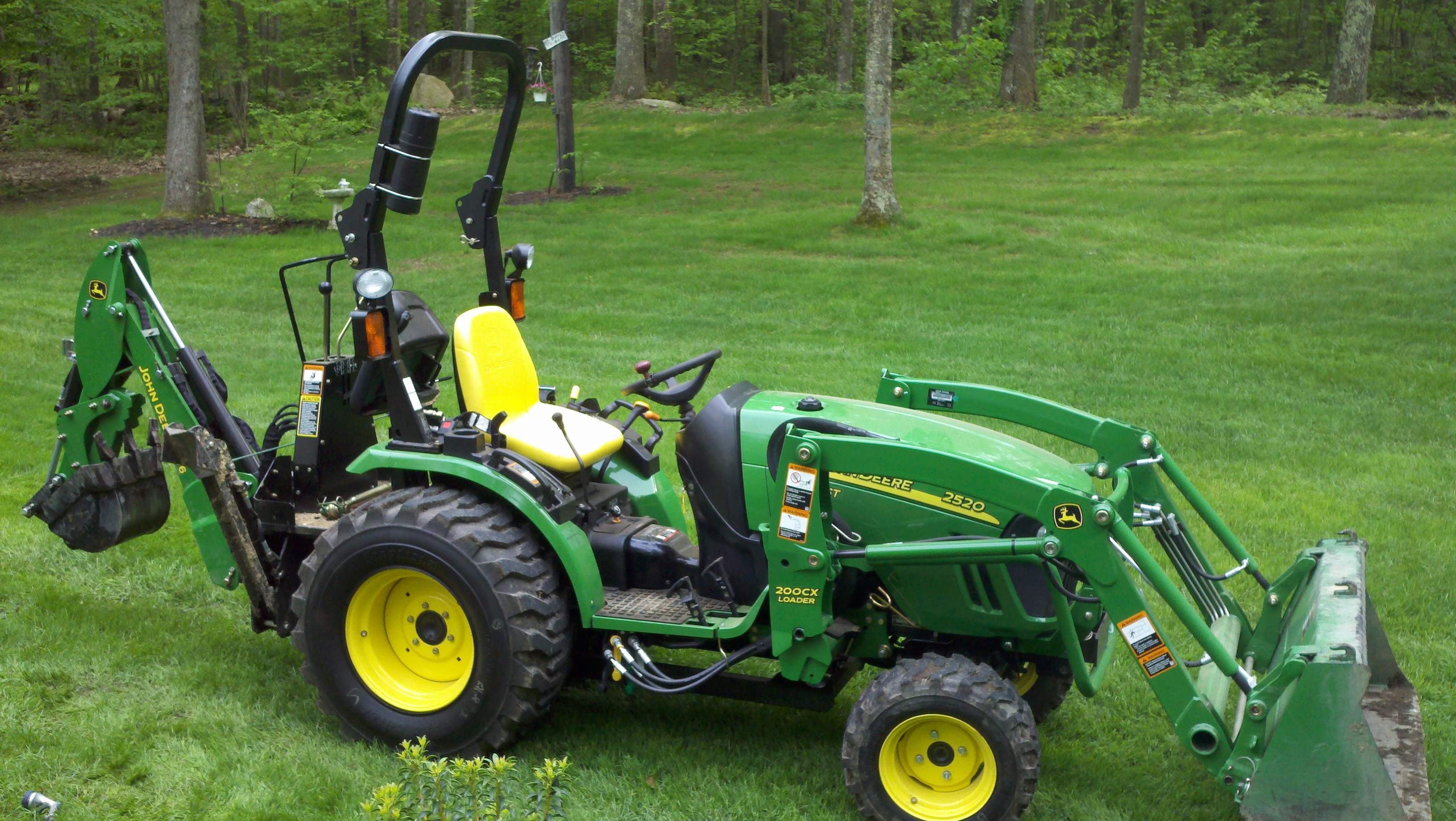

Mark welcome to the forum. You've got a great setup ther both land and tractor!
One question it seems from your picture that your hydraulic hoses are hanging quite low or is it just the Picture?
I wonder if you are missing the wire bracket (my name) that holds the hydro hoses up.
If you are missing it I will try and get a better photo tomorrow.

Thanks for the comments guys. Yes, I'm missing the loop holding the hydraulic lines and need to fab something.
One question though. For the **** of it, I lifted the lines up where they should be and it wasn't easy! It took a lot of pressure and it almost seem right. I was wondering if I need to reroute my lines from how they currently are to easier tuck up to the floorboards. If someone could snap a picture of their routing, that would be cool!

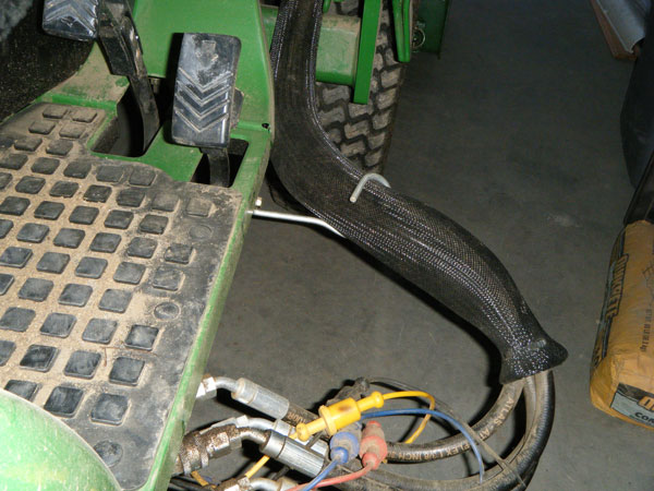

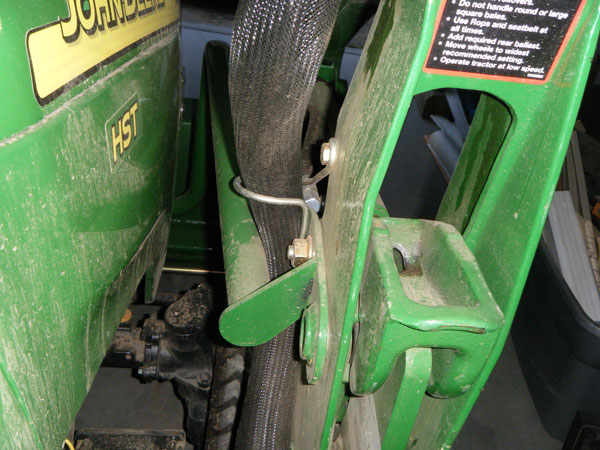

Mark here are a few photos of how mine were attached from the dealer more available if you need them.
Chris is correct check with the dealer first.
First photo side view.
Second attachement under the floorboard.
Third shows the second loop and where it attaches and how the hydro cable route.
Hope these help.

Smalltown,
I hate to be a party pooper, but I think your hose hanger may be installed incorrectly. But hey, if you like it that way then there's nothing wrong with that. Plus, the mounting location that the installer found looks to be intuitive, if I were the sort of person to assemble things without reading first.
Here is a scan of the Deere installation instructions for installing this hose hanger. These particular instructions are for the Front Quick Hitch, but the hose hanger installation is the same regardless and this is how the hanger is configured on my 2520. I'll try to get a picture, but it's probably going to slip my mind a few dozen times first.

Chris your right!
Apparently each dealer has his own idea about these small accessories, including unfortunately not adding them at all sometimes.
I think this might be a picture of your machine.
I need to take a second look at mine when it warms up outside, but it appears my dealer chose not to drill a hole in the floor board and used an existing bolt to secure the hose hanger there.
I like the idea of no extra holes, but your right mine is not per the factory instructions.

Yeah, sorry to be the bearer Smalltown. I hope I didn't embarrass you. It was very generous of you to take photos for Mark. I was hoping to help two birds with one stone with those instructions. And I think you are right. That is my 2520. That's really going the extra mile!
