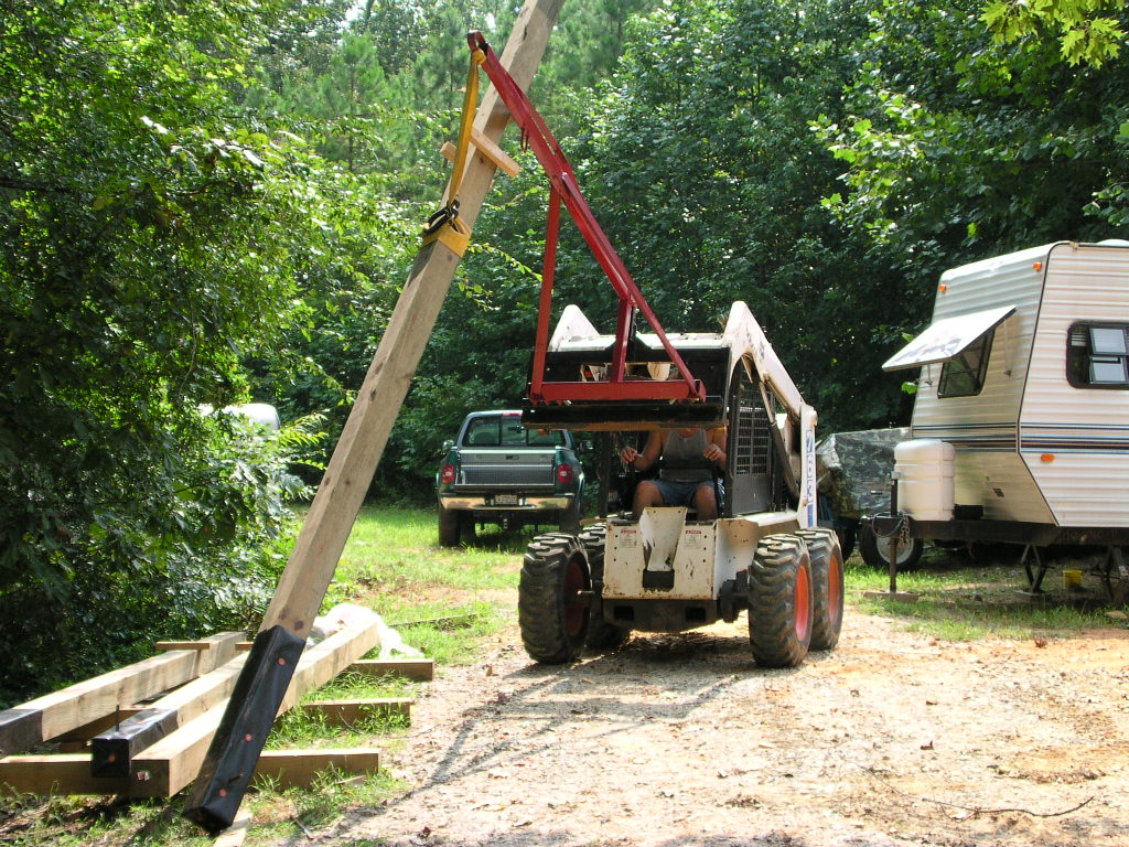

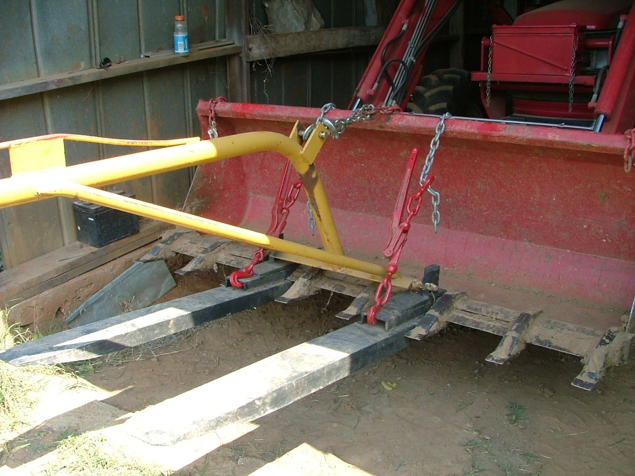

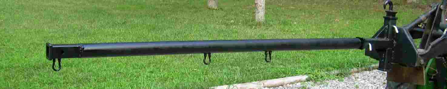

Nope, no torque issues as I built the forks with "blocks" to hold the lower
3pt arms in place (just need to move the forks in one "tooth" on each side. BobG in VA

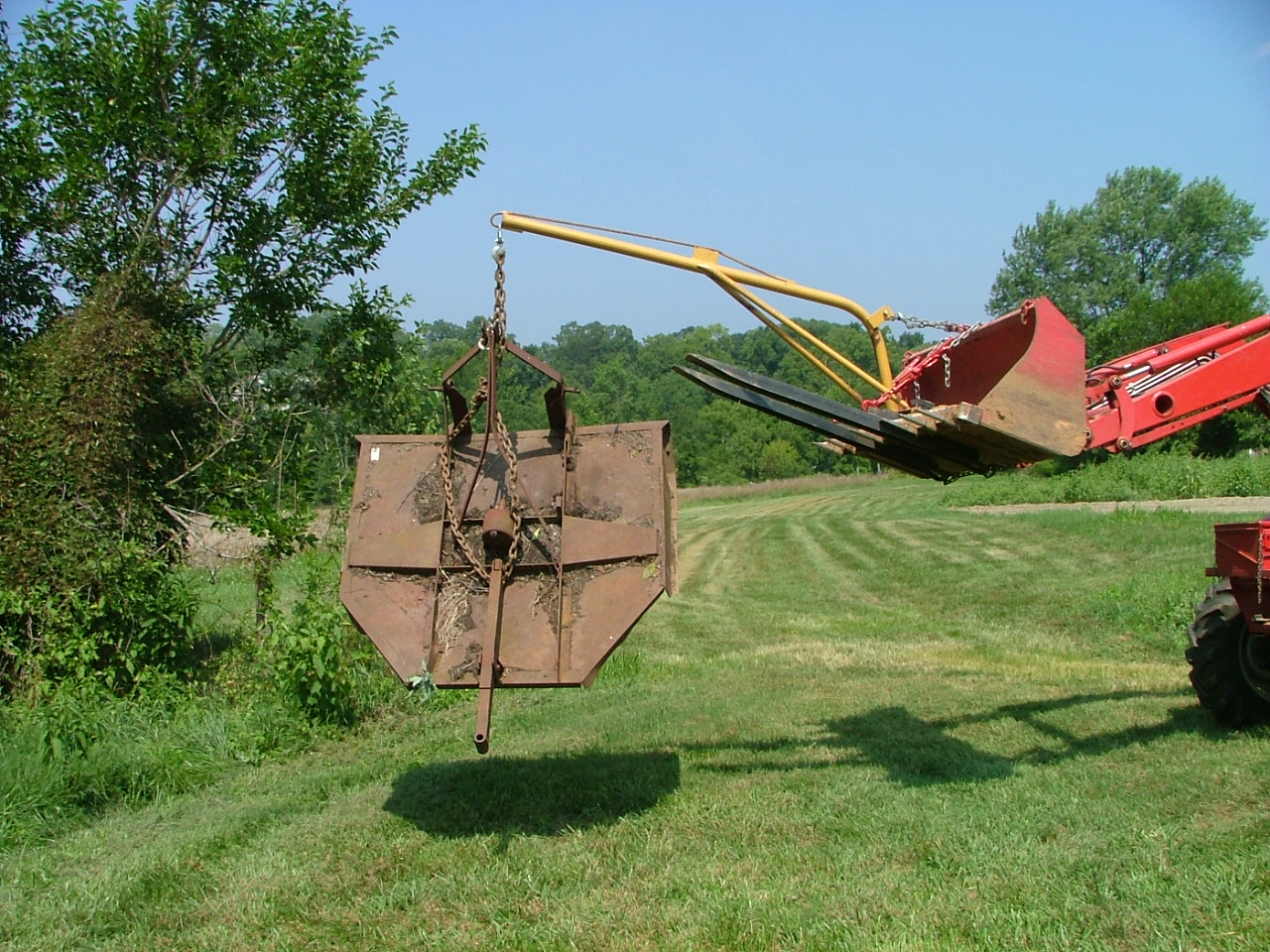

While your bucket mount is pretty solid and stable, a normal 3ph mount has pin clearances at 3 points on the lift arms that allow slop plus there is a certain amount of sway allowed even with stabilizer bars. If JRP tries to lift something say 10' high or more off the 3-point using a modified boom pole I think there will be a stability problem. Imagine the load tilting to one side until its force is acting outside the narrow triangle formed by the lift arms and the top of the pole. One side will shift from compression to tension while swinging toward the rear tire to the limit of allowable sway as the load shifts in the opposite direction. It might stop there, the pole may fail, or the tractor might roll depending on weights, clearances, strengths, etc.
I wouldn't lift anything of any weight to full height, however, I've lifted some stuff that I estimate over 500 lbs and no torque at all. See attached. BobG in VA

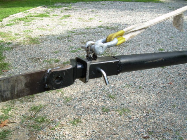

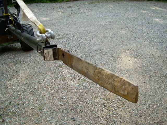

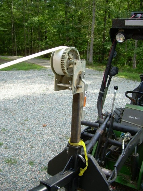

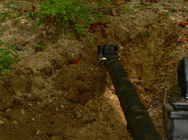

Attached are pictures of my boom pole for the Power Trac 422/425

I actually use if for trenching for wires, but it fits a 2 inch receiver so I put it on the end of the boom pole and tried to cut a branch. It did not do this well. I really need a saw for that purpose. The power trac can go back and forth very easily, so maybe a saw will work.
