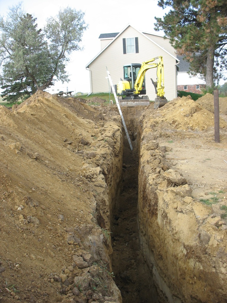

I think I might use a MINI Excavator and dig a trench to depth, place tubes where you need the footers and back fill and pour. They can be rented far cheaper than the other options I have heard so far.
This trench is a trench that I dug to run water out to my new pasture. It's 8' deep and took me a couple hours to dig. I had never used an excavator or backhoe before doing this.
