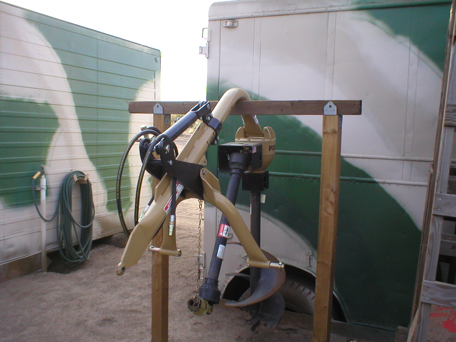

Takes me about 6-7 minutes, and I have about the largest PTO driven PHD that there is. A Land Pride PD35. You really just need to have it stored in a fashion that is easy to work with and that you have to hold up basically no weight when attaching on & off.

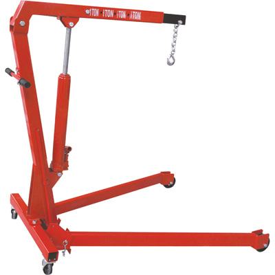

i been pulling PTO shaft off track and gear box, putting in on a shelf
then pulling auger bit off, and putting it on a shelf
then pulling the gear box off, and putting it on a shelf
then finally pulling off the frame work and storing that on a shelf.
though i have found a trick...
a cherry picker / engine hoist. works out nicely... wait for a good sale for around 100 to 130 bucks.
picture is from... Torin Big Red 1 Ton Folding Shop Crane — Model# T31002 | Engine Hoists| Northern Tool + Equipment
lets me keep everything attached, and lets me lay it on the floor, then pick it back up off floor and put it back on tractor.
i've thought about going with a cheap truck crane or something near it
and mounting it on a 4x4 or something to set it higher...
pictures is from... Northern Industrial Tools Pickup Truck Crane — 1000-Lb. Capacity | Truck Cranes| Northern Tool + Equipment
have tried a chain hoist. but trying to pull everything around to get things attached to tractor *ughs* still strong enough, to man handle things vs dealing with the chain host and hanging it from a rafter.
been tempted to do something like MtnViewRanch with 2 posts in ground and another board across the top of them. but no good spot in shed or outside. been tempted so many times. and use of a chain host to most likely a simple cheap ratchet strap, ya tie down things on your trailer with. to hang PHD from.

What u say is exactly why I cobbled this together in a couple hours with scrap 2x4s laying around.
Simple A frame with saw horse joints at the top. The top bar isn't attached, just laying in the saw horse joints. Once hooked up, I raise the PHD and remove the top board and drive off.
It's on casters so very easy to roll up to 3pt. It has just enough auger bit weight to balance it and hold it in place.
Not the prettiest but functional.
The other thing I've seen folks do is just drill it into the ground and leave it half burried. I didn't like that option :)
HTH
I made something similar to this but mounted it on a pallet so I can pick it up with my forks and move it.
The 2x4 cross piece on mine is removable so after I hook up to the 3 pt. I lift slightly and pull the 2x4 out
then drive off to go to work.
http://www.tractorbynet.com/forums/attachments/292640-storing-post-hole-auger.html#post3567408

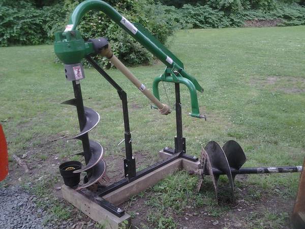

Here's a nice stand for a PHD. Not sure if its something fabbed up by the owner or if it was purchased with the PHD, but looks to be adjustable for different models or to allow it to align with various size tractors I would guess.
Not much material there, should be easy to duplicate. I think I would have made those 4x4s a little wider for more stability, at least as wide as possible on the front so as not to interfere with the rear tires. The rear 4x4 under the auger could easily be a foot or more wider.
Since this is a CL listing (not mine) I have included one of the photos in my post so when the CL Ad is gone there will still be some image here. But there are multiple photos from all angles in the CL post to evaluate building your own from.
P.T.O Posthole Auger / Frontier
Edit: did some searching and it turns out this stand is made by Rotomec. Here's a link to their manual which covers the stand, the optional downforce kit, and their positioning handle.
Didn't find a price though.
http://www.rotomec.com/usa/pdf/Rotomec USA PHD Accessories (US) 10-2008.pdf
