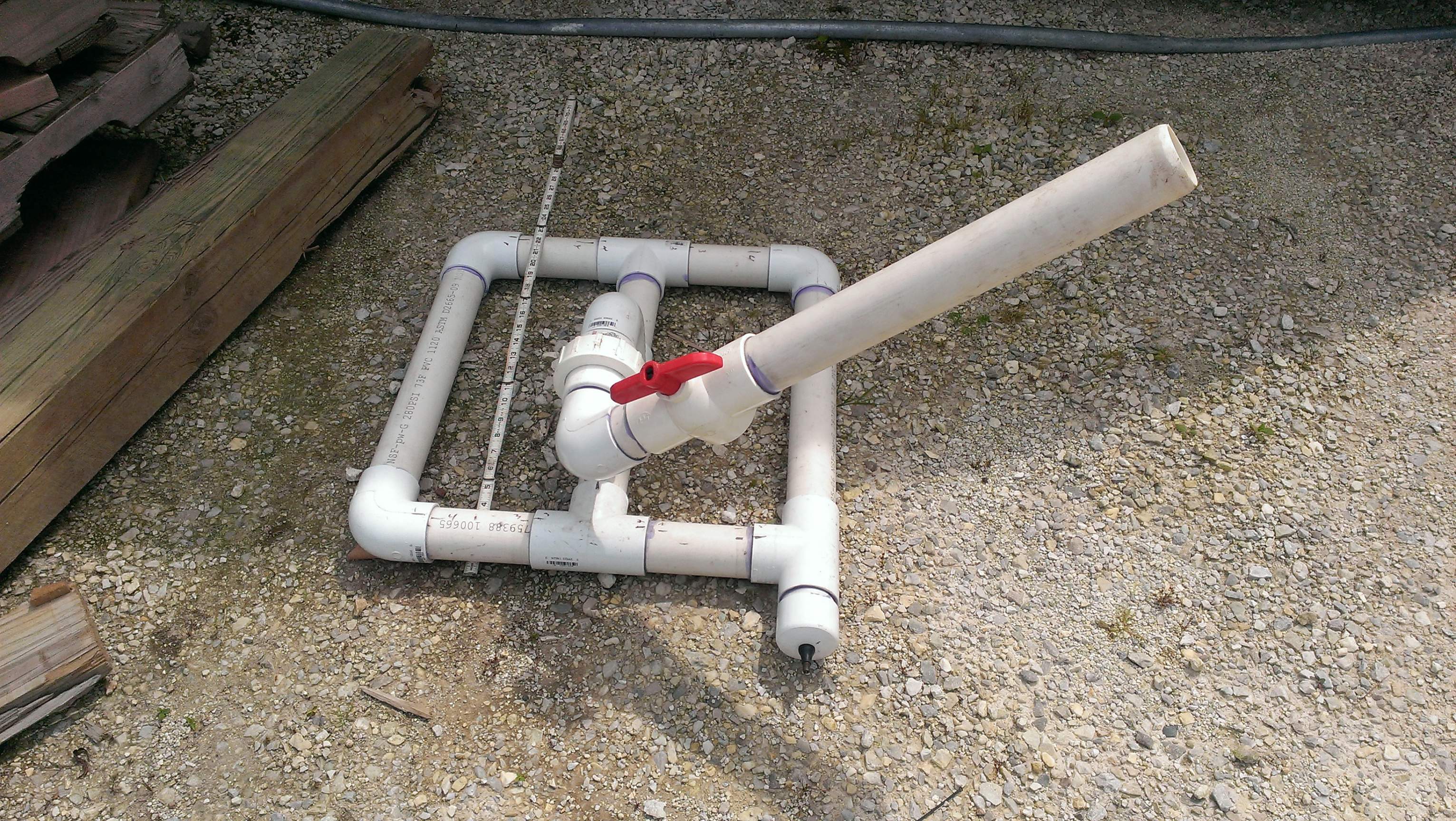

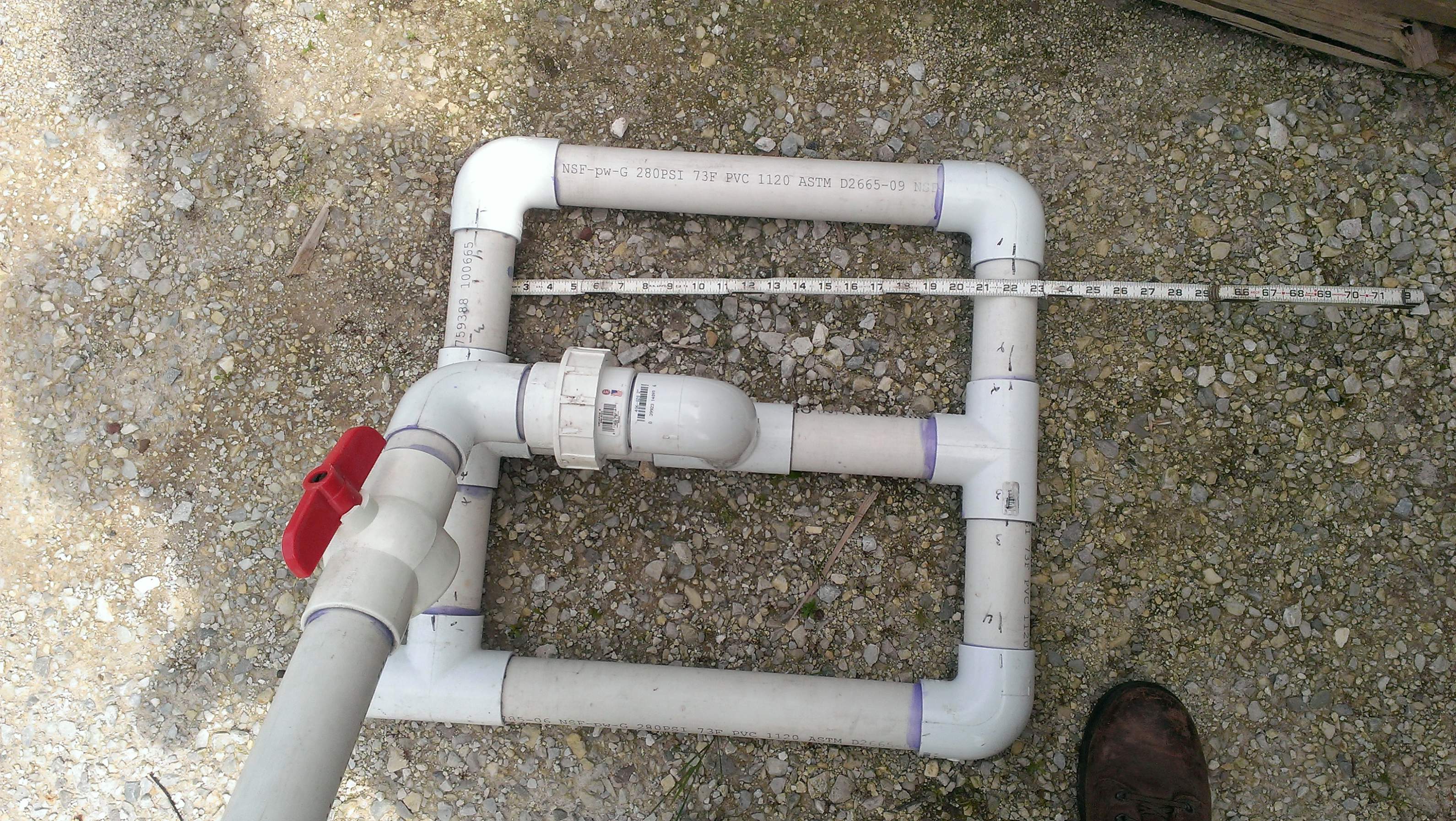

Works really well! swear it will go a mile. When you pump 130 psi into it is kinda scary as you can feel the PVC expand.:cool2:

PVC explodes into lethally sharp shrapnel.... Just so you know. Btdt.

The hairspray and ignition is probably far more dangerous than compressed air well below the pipe rating. But, still, PVC isn't recommended for air lines, either, though many use it with no problem.
The PVC is rated for 250 psi, don't remember what fittings are actually, I did however make sure everything was with in specs including the glue/cement! Gluing it up can be tricky and it takes two people, it is designed so that the air rushes into the center.
/ Potato Cannon #9
PVC is rated at 0 psi of compressed air.
tcartwri is correct. It may not fail, but it defiantly can.
I was once injured by a PVC compressed air line that failed.
I would suggest you keep onlookers clear of it.
/ Potato Cannon #10
Your design puts a lot of lateral loading on that discharge pipe with every "firing" and will eventually cause it to break at or around the union. PVC is very brittle and gets worse with age and cold so I would be very cautious about using that thing. There is a reason most potato cannons are in-line with everything. Each bend also gets hammered with air hammer effect when discharging. DO yourself a favor and destroy that thing before you get maimed or killed by it.
