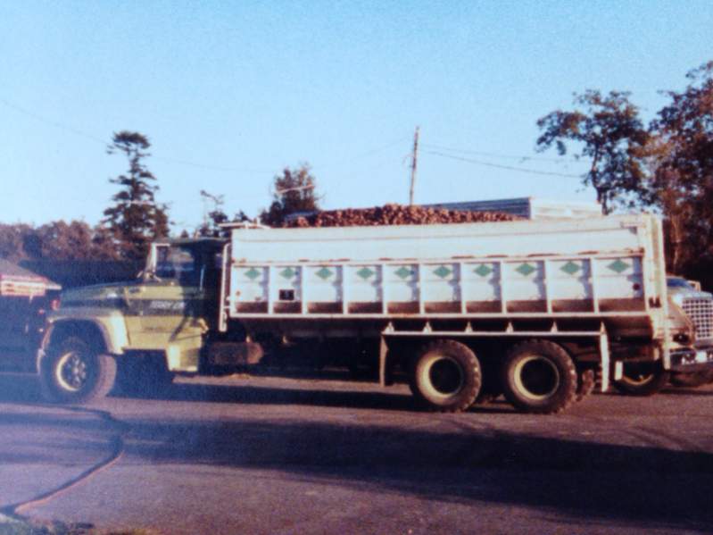

Found a 30 year old pic of one of my potato boxes. This one was a Schell Systems manufactured in Idaho.
Terry
