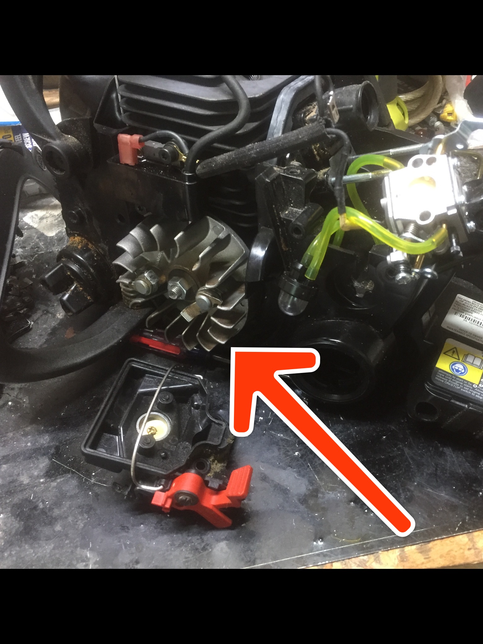

Ahh ok, I put the flywheel cover back on not knowing it was supposed to be in a certain position. I'll try that. Thanks
Wait, what? You removed the flywheel to replace the carb. Perhaps we are not talking about the same thing. Yes there is a cover for the flywheel, usually associated with the recoil starter. I'm saying that you have to remove the flywheel to check to see if the flywheel and the key on the crank are lined up.
   / Poulan Chainsaw not starting
#32
Sorry for my ignorance. Is this not the flywheel?
Photo taken in the middle of project
   / Poulan Chainsaw not starting #33
Yep that is indeed the flywheel. Did you remove it to change the carb?
   / Poulan Chainsaw not starting #35
Does the carb you bought have fuel adjustment screws?
