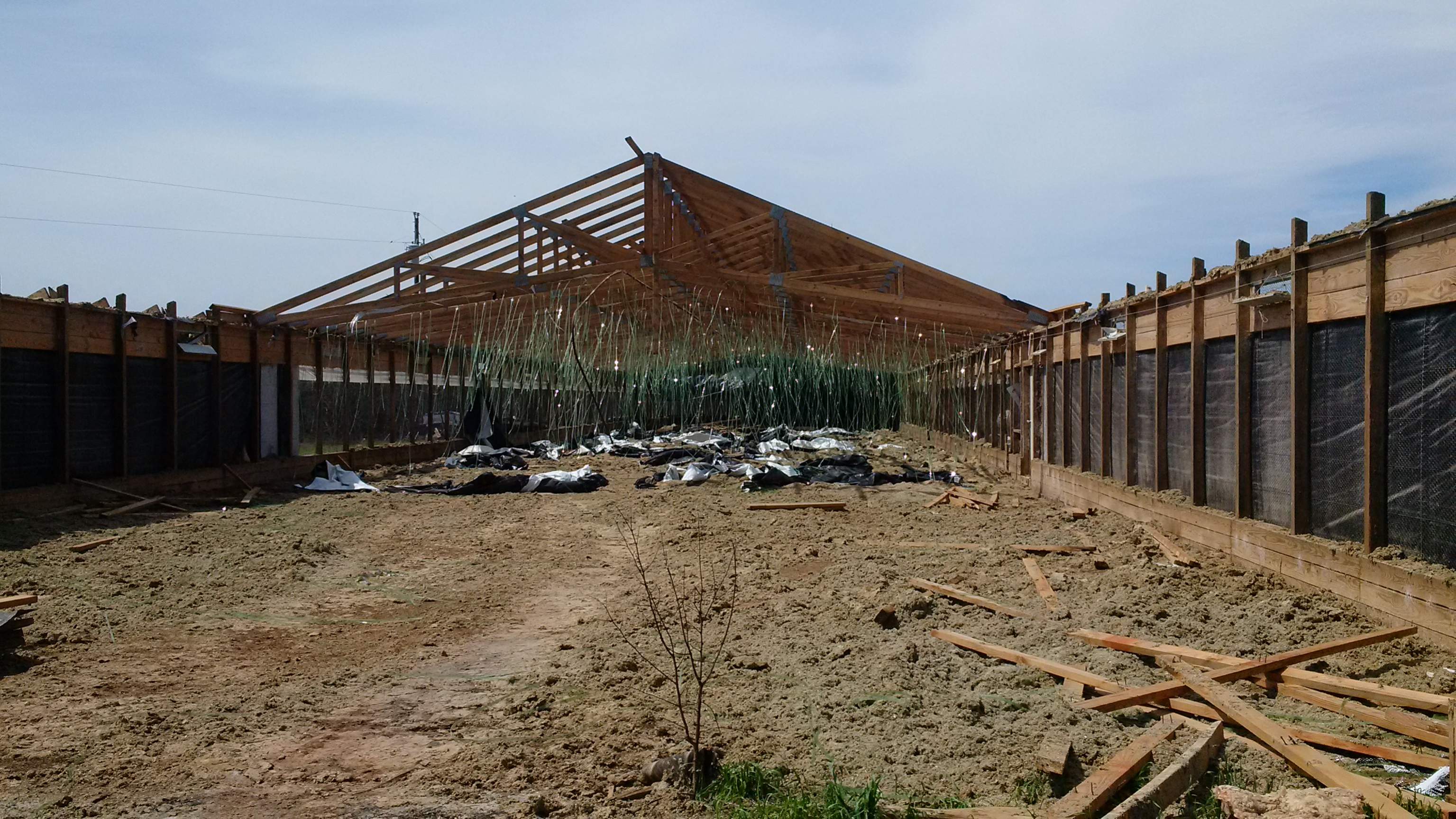

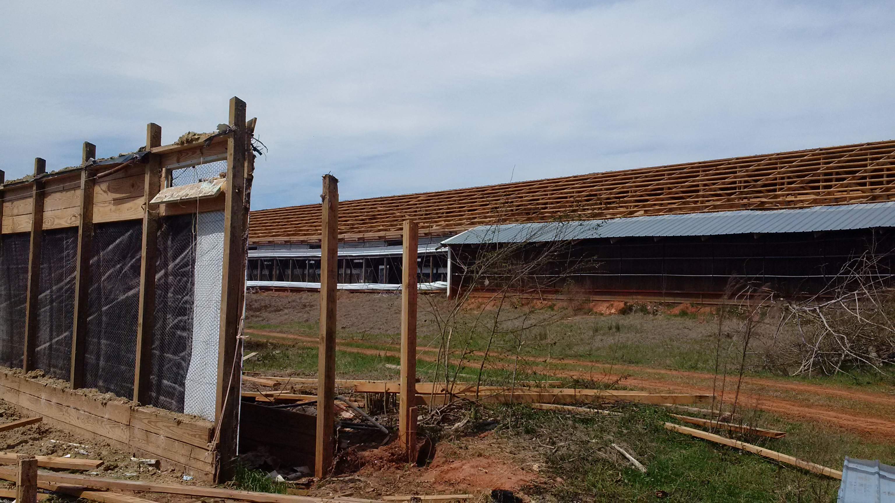

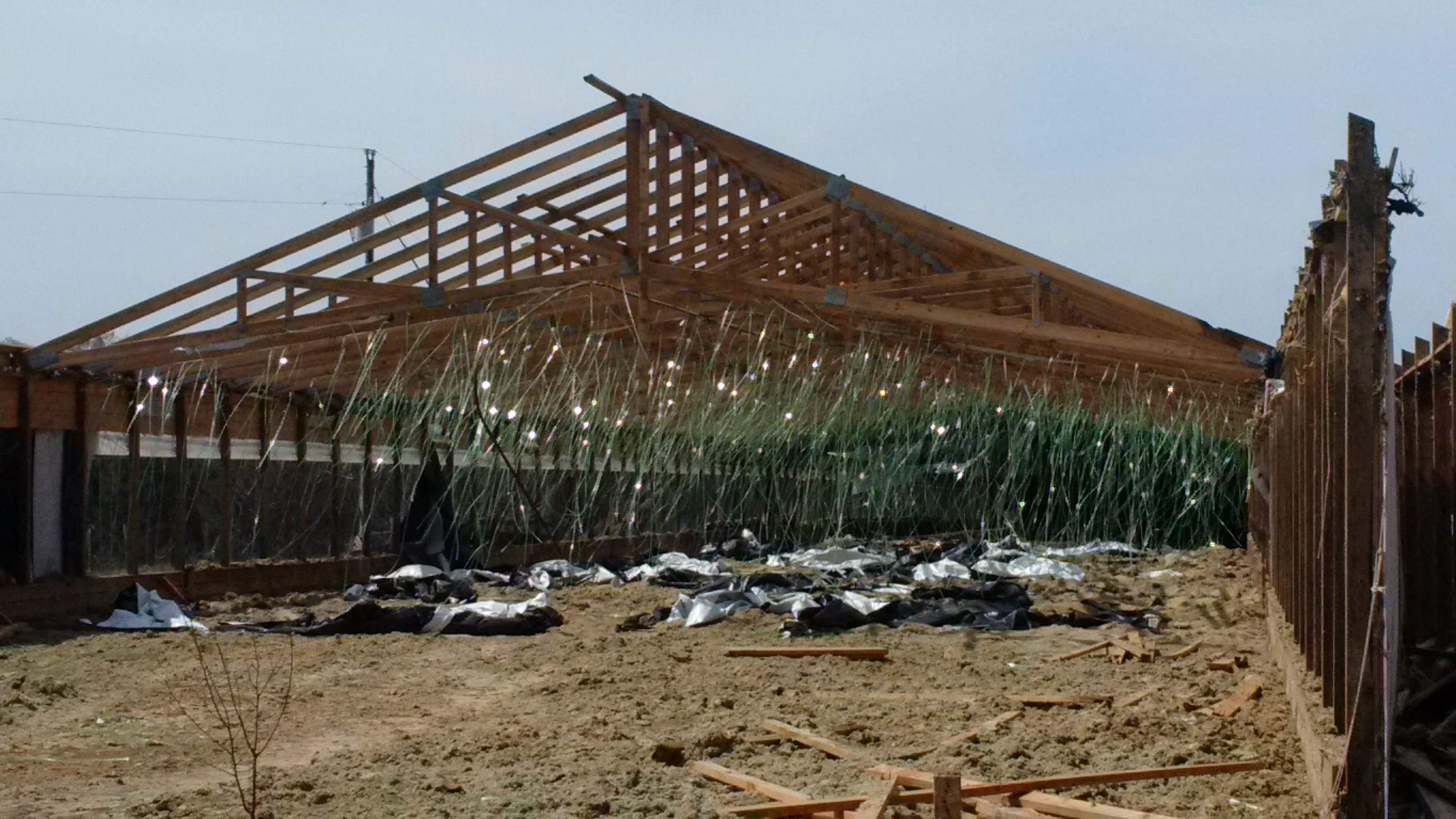

This week's progress:
You'll see the green strips in the pictures hanging down like some St. Patrick's day parade had just passed through...those are plastic strips which hold in the cellulose ceiling insulation above, which is a loose paper-like substance treated to be less flammable.
The process is, they take the tin off and allow it to rain on the cellulose from above, which compacts the loose cellulose.
Then, pull the green strips from the inside allowing the cellulose to drop to the ground wet and less chance of it blowing around all over the county.
They are selling the tin and trusses as they go, most of it as they take it down. A few local guys already have trailers parked on the property to have sheets loaded on their trailers as it is removed.
IMG_20150317_131515 (1).jpgIMG_20150317_131531 (1).jpgIMG_20150317_131535 (2).jpg
