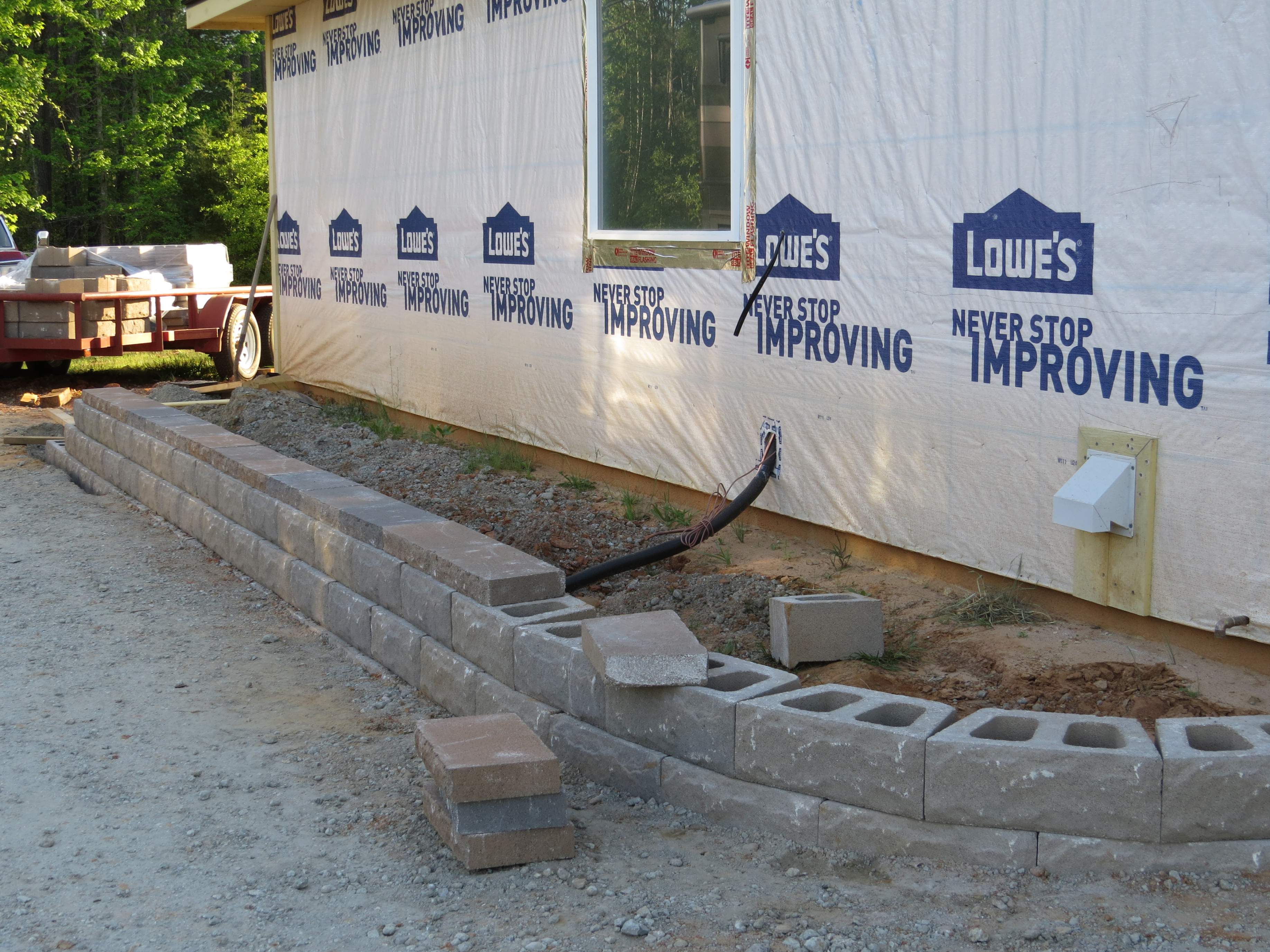

For a retaining wall, I agree that stacking blocks is the best way to go if it's not too high. This is what my 77 year old dad is doing by himself. He does a little bit at a time, and when he feels like it, he goes back and does a little bit more.
These are from Lowes.
Eddie

I know there are going too be some comments because i always here you can't pour dry concrete for fence poles but my 2.5 acres has a 6 ft fence around it coming on 15 years know & is solid as a rock, anyway what i'am getting @ is, i want to pour a retaing wall 4 inch thick with rebar & about 25 ft long & probally 3 ft tall & was considering pouring it dry & was wondering if anyone has any experience with this i want to put a car port next to my shop with gravel base to park a boat but it slopes away & will need to raise the outer side up 3 ft to make a leval pad, will frame up & pour H20 as i fill & probally keep a sprinkler on the forms to keep wet for a couple of days any exp. doing this???
I seriously doubt that a 4" thick by 3' high retaining wall is strong enough to work, no matter how much rebar you put in it.
Most retaining walls have a base or foundation which is much wider than the wall. Even the stack block walls usually require a base of 3/4"- gravel, well compacted.
In most places, walls under 4' do not require engineering, so you can build whatever you want. But, when I built a 5' retaining wall to hold the earth for driveway, I used stack block, but both read the brochures on how to do it with that brand of block, and had an engineer design it. Select a brand of stack block and look them up on the internet. Most have a wealth of information on how to do it right.
Another thing to consider is that randomly mixing blocks of various colors produces a very pleasing look.
Higher quality block than Lowes or Home Depot carries will cost a few $ more, but will give a much better end result.
Any way you look at it, a well made retaining wall is going to be hours of backbreaking work. Spend a little more and get a lot more.
