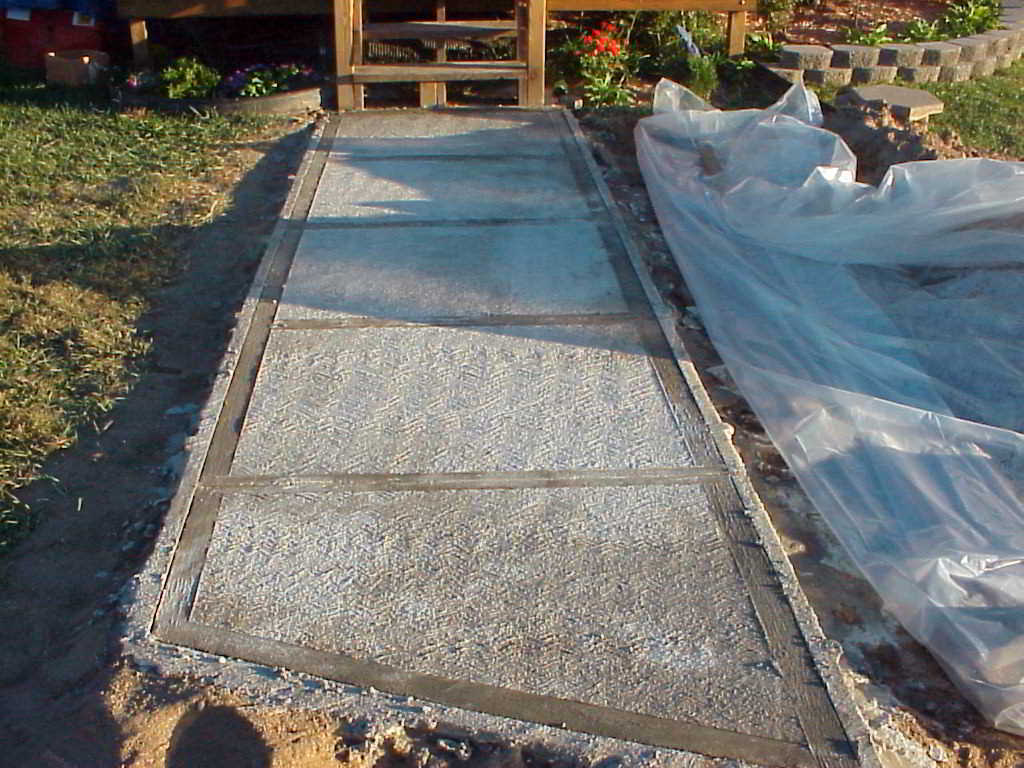

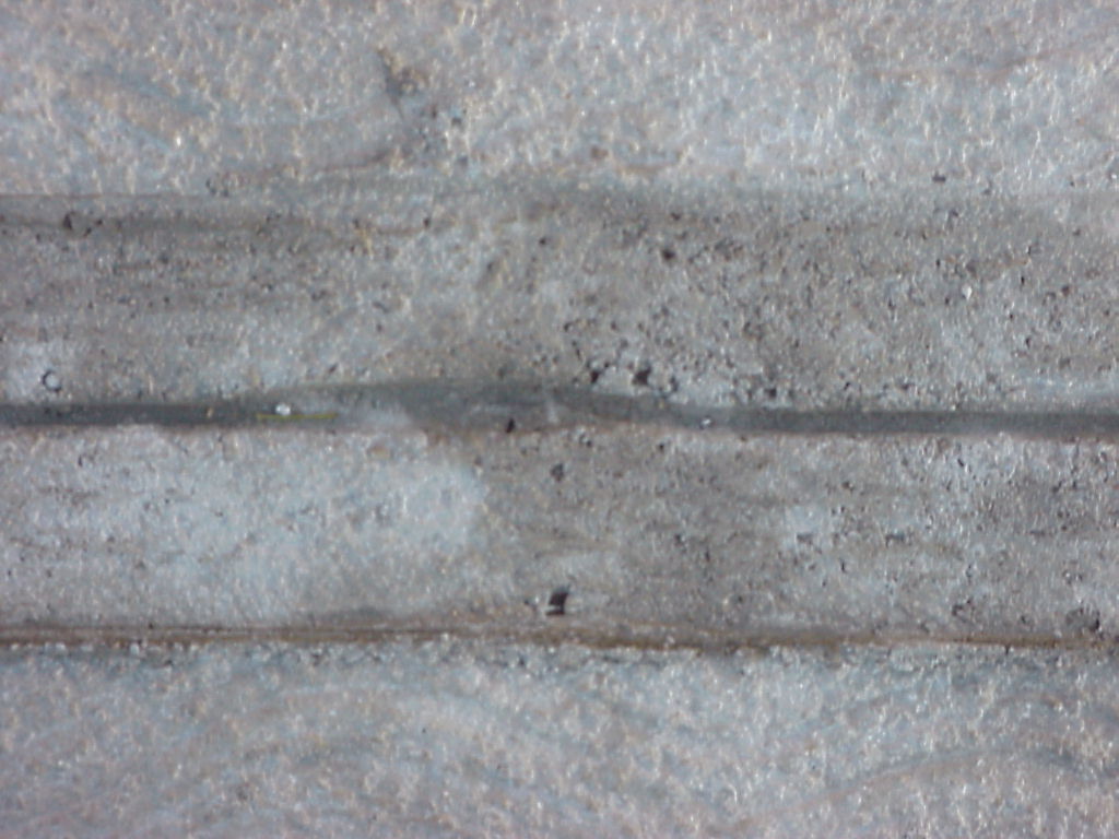

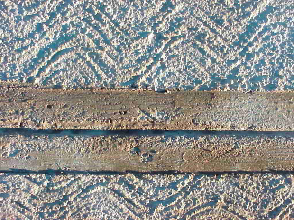

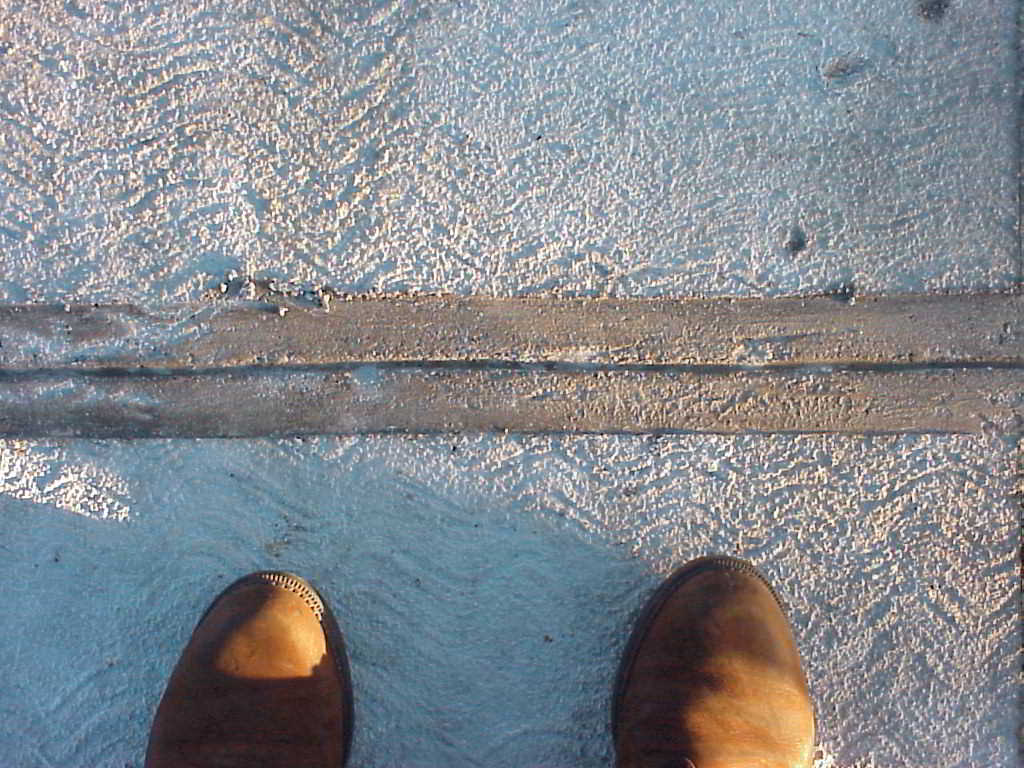

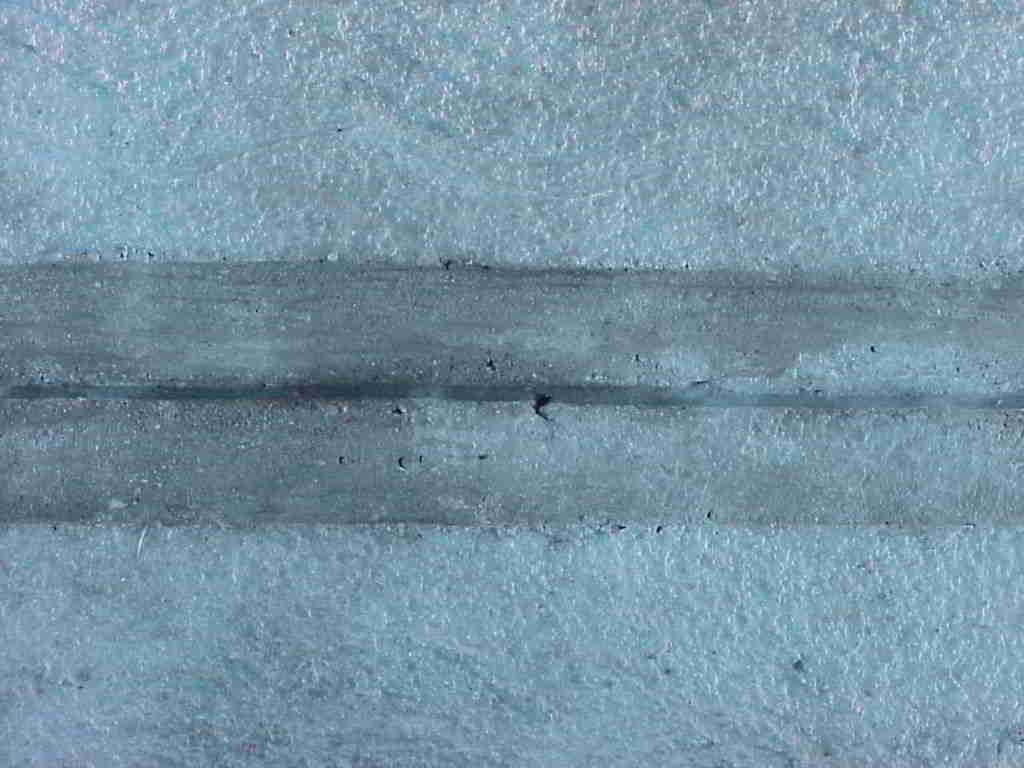

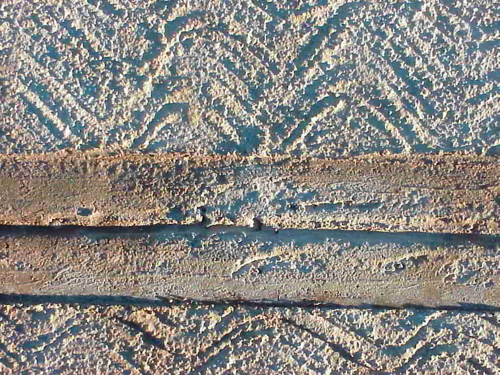

OK guys, I finally got the sidewalk poured this past Saturday. What do ya think for my first attempt at finished concrete work?/w3tcompact/icons/cool.gif Only previous experience with concrete is dumping Quikrete in holes for fence posts or whatever. I did have a couple little problems that you'll see in some of the other pictures I'll post. It set up a little bit too much when I was trying to do the expansion joints, they got a little dry and didn't "smooth" out as quite as nice as I would have like and left little holes/rough spots. I zoomed in on these in the next few pictures. Is this something I should worry about? Should I put a concrete sealer on it? A mortor type mix? Obviously I don't want to bust this thing out and start over, but nor do I wants patches on a new sidewalk or have it cracking/crumbling come the first freeze.
Again thanks to all of you for the replies to help me tackle this.
Jim

A closeup.

Another close-up of an expansion joint.

A little bit farther view away, but straight on shot of a joint.

Another shot of one of my character flaws.

And yet another.
