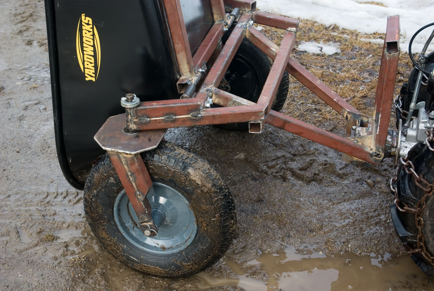

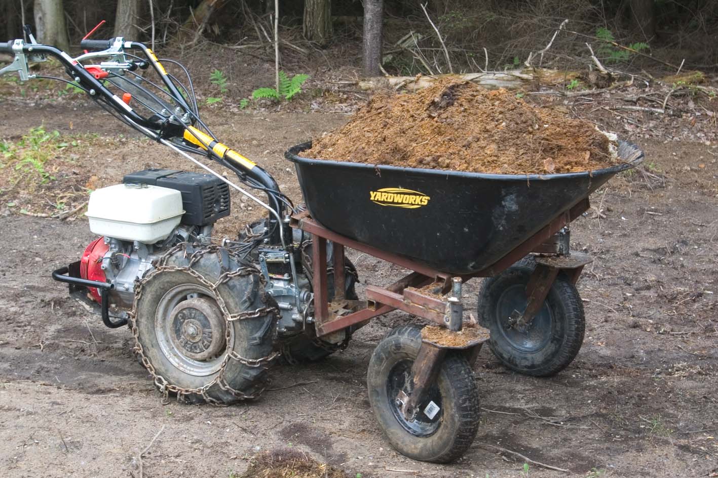

Two Gravely Two L One with 10 h.p Dek-Diesel engine one Grillo 107d and one BCS 735 diesel
I just finish. Turn very tight less 7 ft. Very easy to dump. Very light. Engine torque transfert weigh to tractor So I think could be go with load on very steppy hills. I do not try again with heavy load. 6 cu. ft. and may be 300-400 lbs capacity. Thanks and Good Luck! Oldmech

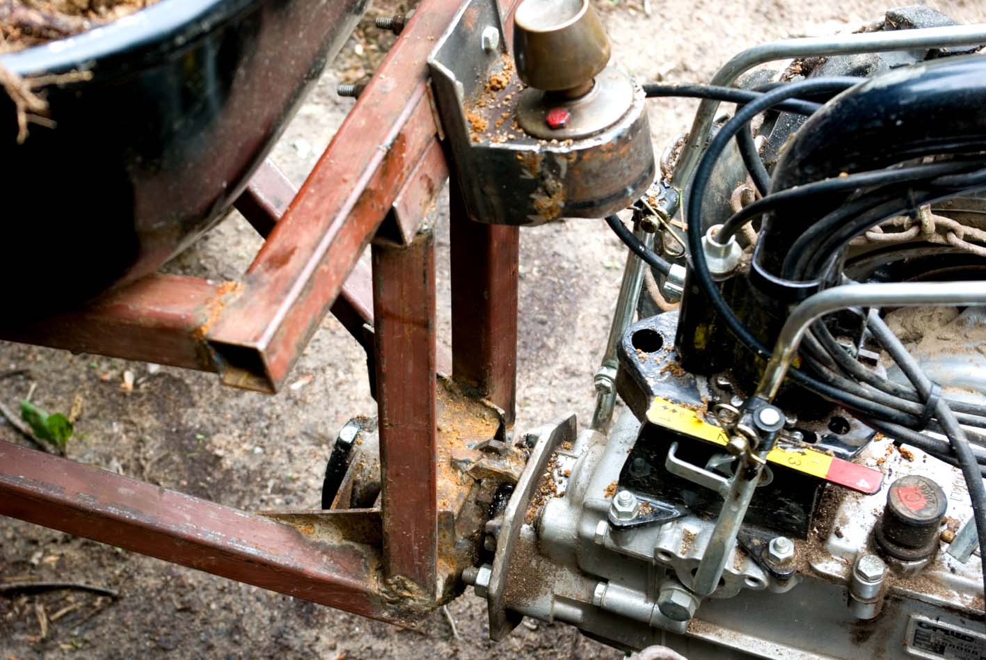

I don't see any levers like a wheelbarrow to dump the material.
Could you please explain what makes it easy to dump?
   / Power Barrow for BCS Grillo and Gravely
Hi! On pict no1 Look in center on the square tubing they are a Knob (From a old door) you turn right or left this unlock and with one hand you lift the square tubing corner. Very easy because Good balance near neutral for close you pull down .Lock as a door Later I could add other pictures Thanks! Oldmech

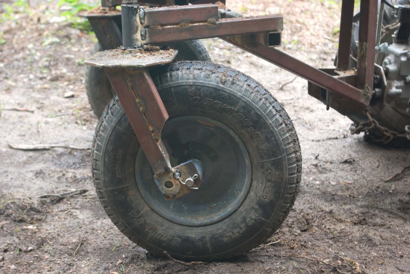

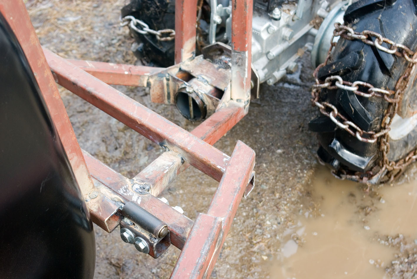

Hi! I found some defects on my power barrow. First When go front the empty box go in air by engine torque and side turn over. I add one angle limiter on swivel hitch. Second the 3/4 in. dia. king pin bend with heavy load on very bad ground I go for 1 in. dia. Also I change fork angle from 3 in. (caster) to 4.5 in. (5or 6 in. could better) Less hard to turn with heavy load. I like it ! Turn very short easy to dump. Go anywhere hill uneven ground mud etc.. Load transfert by engine torque is impressive. I use it a lot now. Good luck ! Oldmech
