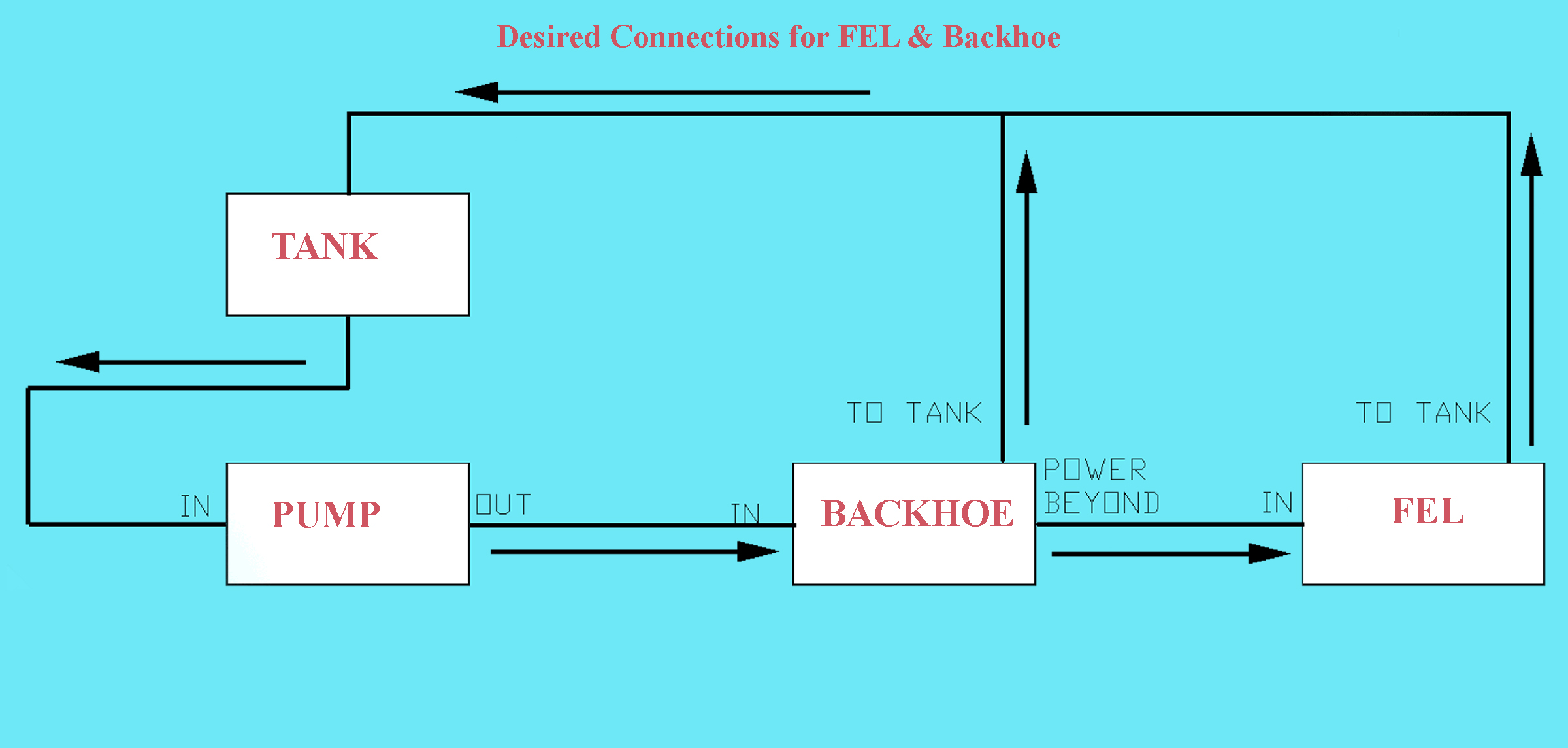

Thank you KennyD and JJ for your replies. I did find a website saying I should connect open center valves in series, so I did that. Now it works more or less correctly, exept the FEL tends to raise slowly when I use the BH. I am also experiencing leakage somewhere in the spool valve for the FEL. I think the problem is related to having the output of the FEL spool valve at high pressure instead of going back to the tank, but I may just need to replace some seals. I need to identify the power beyond port if one exists on the FEL spool valve. I did find some info on the Prince website that may be helpful in getting it connected correctly. I will try to get some photos and maybe some more details on the spool valve if it doesn't snow today.

The BH valve should be in series and before the 3pt. This will cause all the valves in the circuit to see high pressure if the 3pt is used. If you disconnect the BH, then you need to jumper the connections for the BH, to provide a complete path for fluid flow through the 3pt.

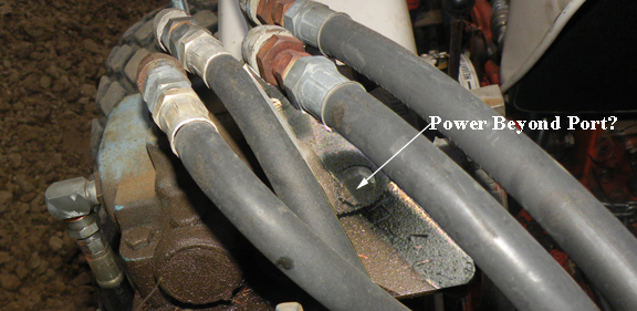

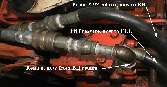

Thank you for the info JJ. I have more information now. The 3 point system is plumbed in as part of the tractor and it is not easy to access the hydraulic line between it and the pump. The fluid from the 3 point goes to the "block" I mentioned previously, shown in the photo below. The two lines from this block originally went to the FEL control valve, a Gresen 2702 which seems to not have a power beyond port (photos below) unless the plugged port shown is it.
I have re-plumbed the system to use the oil coming from the 2702 return as the inlet for the BH. All systems function correctly, including the 3 point, other than the oil leak in the 2702 and the slow movement of the FEL while using the BH. When I remove the BH, I will install a short hose between the two quick connect fittings to route the oil to the FEL.
It appears that maybe I should route the oil to the BH first to avoid high pressure on the outlet port of the 2702. The BH control valves may have a power beyond port, but I do not have good photos of them, and I will need to remove some panels to even get a manufacturer or model number for them. The BH is a Kelly B-750 and the diagram shows connecting to a power beyond port for the FEL (shown below).

Just want to give a friendly warning, in your pictures it looks as though you are using standard water pipe fittings. If they are water pipe fittings, they are not rated for the hydraulic pressure that you are running through them. I know that this has been done for many years and sometimes all is fine, just wanted you to be aware of the possible problems that may occur. :eek:
   / Power Beyond or HPCO valve help needed #10
Good catch MVR:thumbsup:
Regular iron pipe fittings are usually rated for only 150 or 300 PSI-especially the ones now that are cast on China. These fittings can see 3000+ PSI with shock loads on a loader or backhoe.
