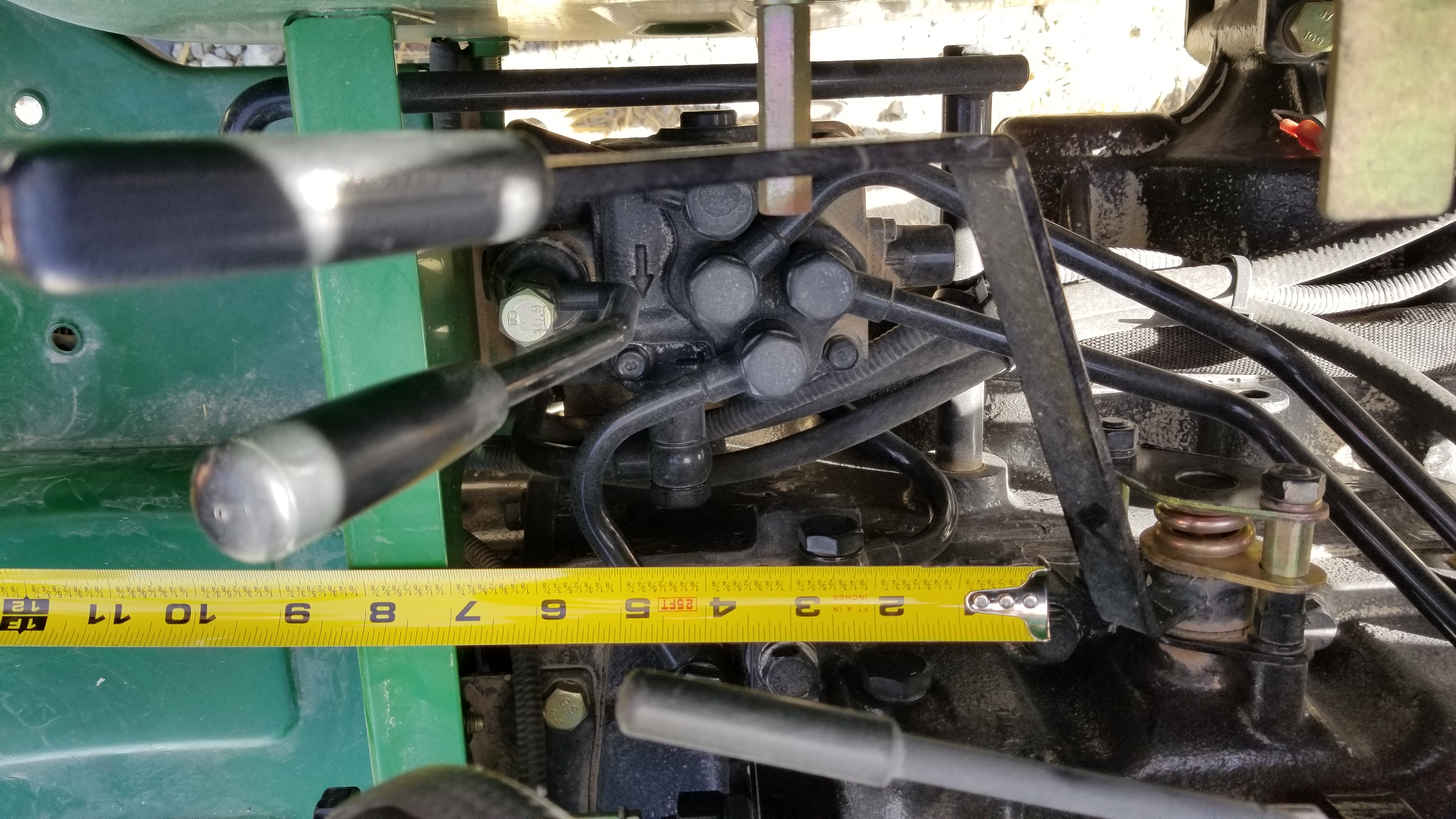

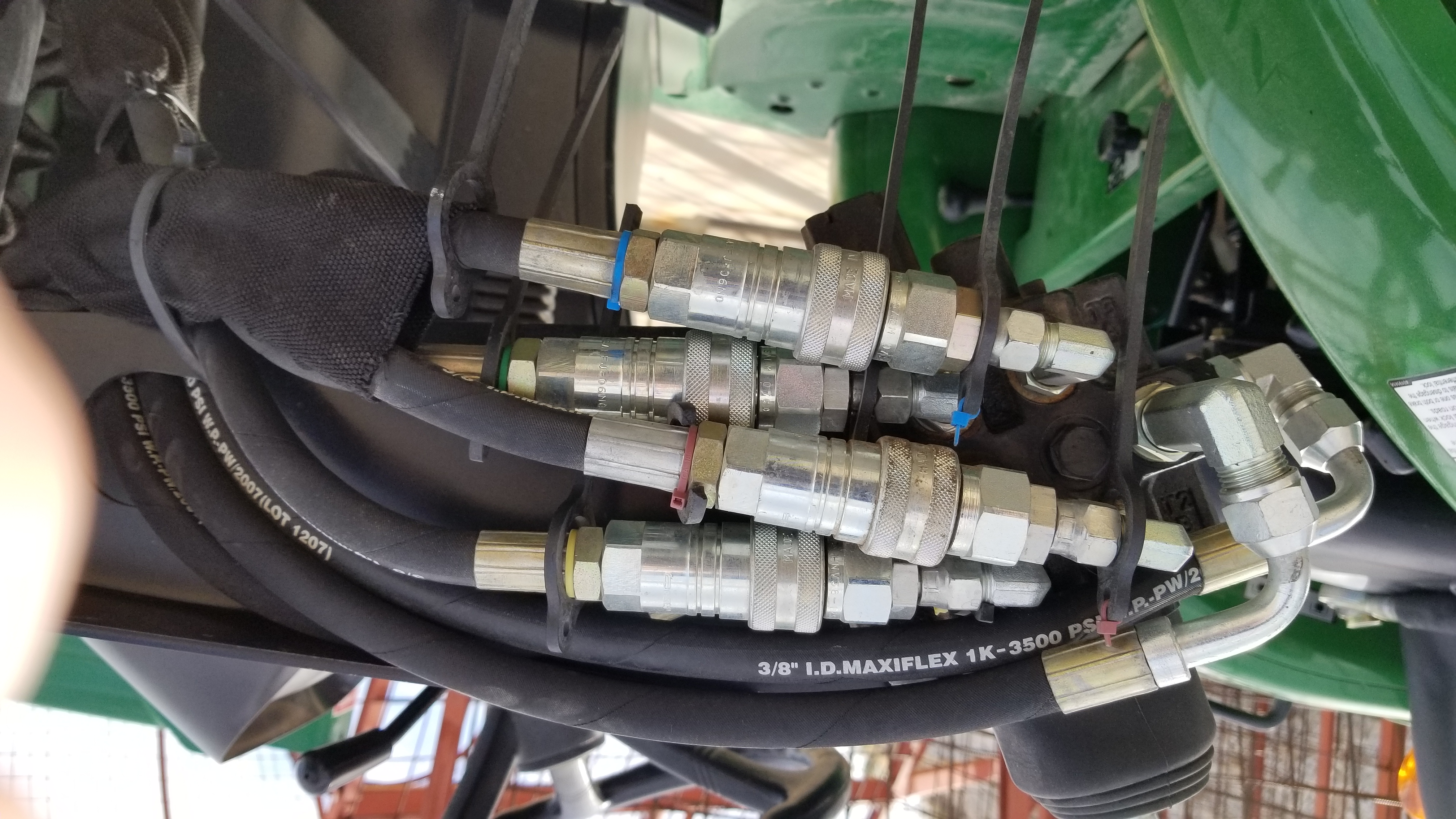

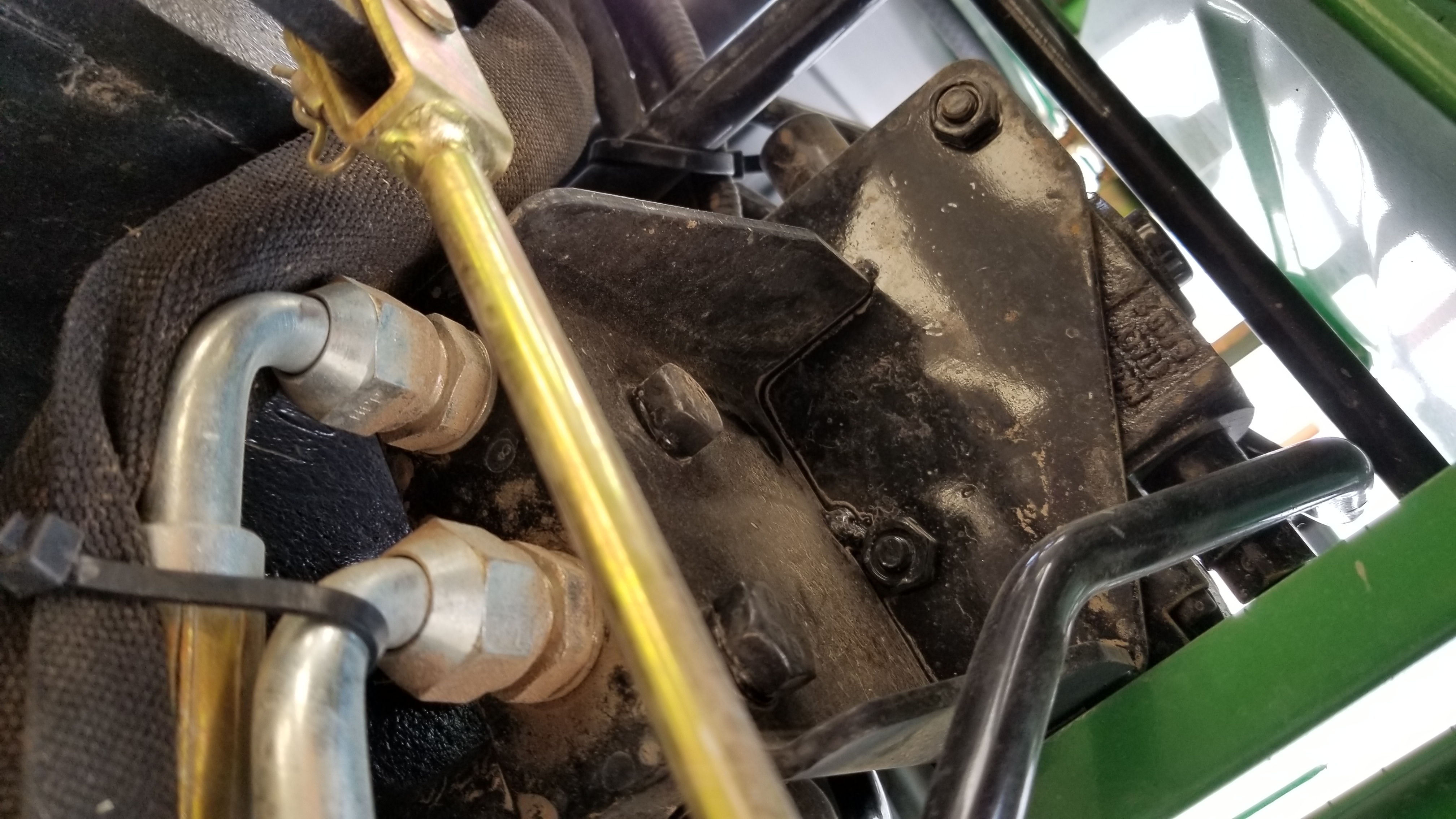

Hi all,
I have a project I want to do and wonder if anyone has tapped into the power beyond on a 2840 or similar Montana tractor. I have access to a couple 3 point hydraulic tools like a 3 point back hoe. So setting up an accessory power beyond would seem to be something I should put on my list.
I believe this block is from the pump to the loader and the oil return hose under those two lines.
That above block also feeds the rear remote fittings with a hard line going down to the top of the valve block in the above photo.
Here is the FEL valve set and the two lines that have no quick disconnects one line goes to the valve in the first photo and the other goes to the back for an oil return.
My question is how did you or how would you tap in for a rear power beyond connection. Anyone have photos of how they did it? I believe tapping in at the valve shown in the first photo would be the starting point.
Thanks again guys for you help.

The “power beyond” hangs people up......I think.
The concept is quite simple. The pressurized fluid goes into the valve and then leaves the valve through the “power beyond”. If you only have one valve it would return to 3 point and reservoir. If, in your case, you wanted to add a third function, it would be out if the loader valve and into the third function valve. Then out the third function valve and back to the 3 point and reservoir.
So find your “return” or “power beyond”. Run that line into the third function valve and then back to the reservoir.

Regarding Kep1a's problem, looks like your tractor already have a set of rear remotes, is there any good reason for not just using those? If you need constant flow, just lock the rear remote lever with a bungee cord.
You just need to make sure the line that will have pressure is the one on the pressure relief side of the backhoe valve.
The other line of the backhoe will just flow back to the tank through the other remote port.
Now for fried1765 issue, can you post the link for your thread? So we don't mix everything up between the two problems.
Anyway, you can't tee the pressure lines on a open center system. Otherwise the oil will just free flow to the path of least resistance.
The only line you can tee together is a the return/tank lines.
